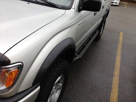

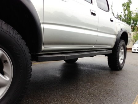

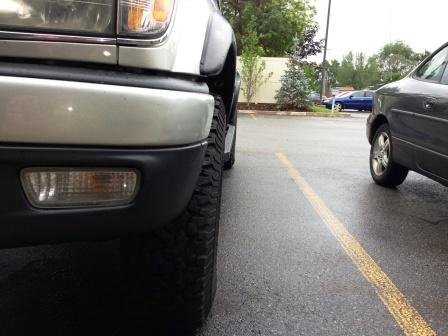

    Don't know how much this might help since mine is 1st Gen, but here's what I know from mine:
    1. First of all, mine aren't level, but if you weld yours they will be (see my bolt-on woes in my install writeup post). Notice the back is pretty flush with the bottom of the rocker panel. That's how they should be, and would be if I'd welded.
    2. They're almost exactly flush with my stock width fenders / tires; the sliders are about 1/2" narrower. Hasn't ever been a problem on a trail, but I don't take too many narrows either.

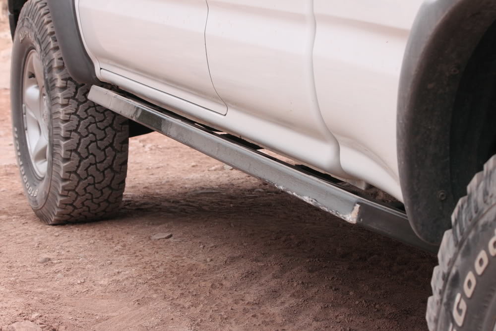

    I based mine on the demello's. I can't stand the way they stick straight out though so I angled mine up, but still kept a good 5/8" space between the pinch weld and slider.
