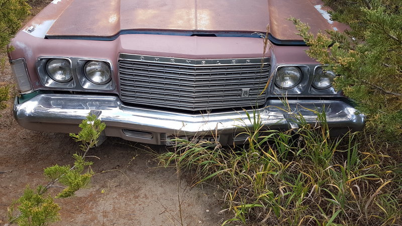

    This is what I'm starting with.

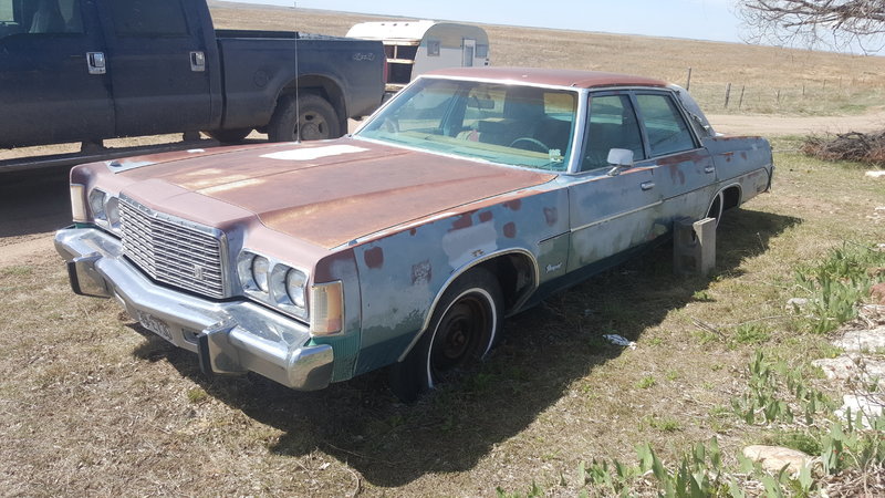

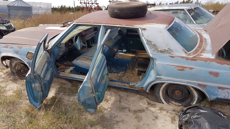

    1975 Chrysler newport

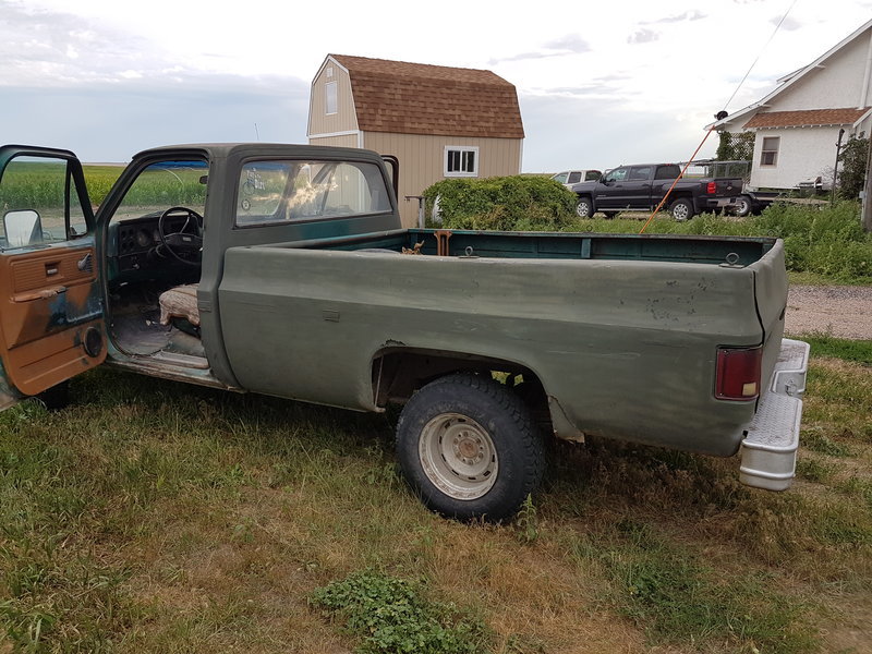

    1979 k10 chevy for engine
    I am planning to do a complete rebuild of the 350 into a 383 stroker and sell the 360 that's in the Newport.
    I picked up the newport for $150 (already had a $1,000 offer for the whole car already) very solid and hard car for demo derbies.
    Drove the pickup home for $350 with no reverse. Will most likely pull the cab and just build a trailer out of the box and frame.

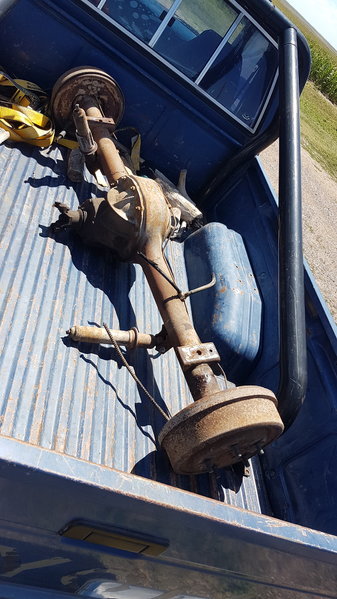

    I traded an 86 foxbody for the 9" plus cash.

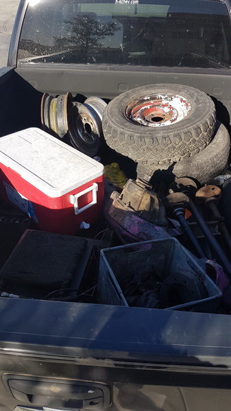

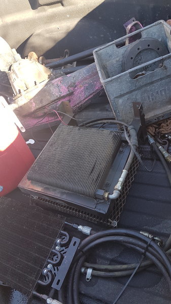

    Picked up an extra 28 spline 9" rear end, wheels, a shifter, pair of 31 spline axles, and a couple tranny coolers this week.
    The 9" came with a set of 5.13 gears.
    ecoterragaia likes this.

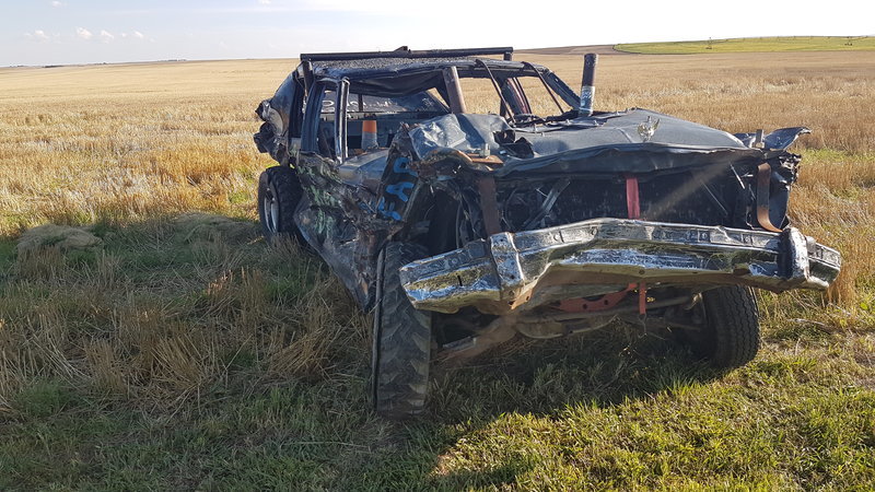

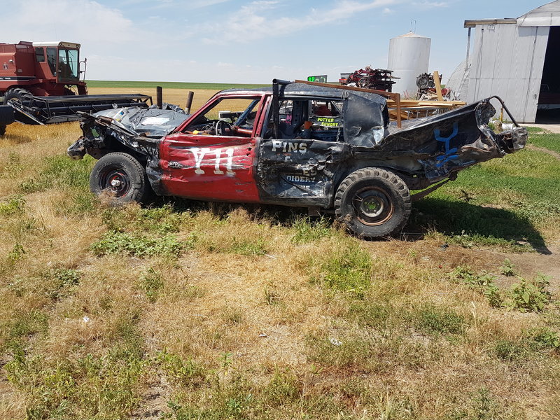

    Here is my car from last year. 89 caddy.
    Has 4 derbies on it. I decided to retire it due to frame being bent at firewall. It actually still runs and drives. Has a super clean 305 in it. That will soon be going into my wagon.

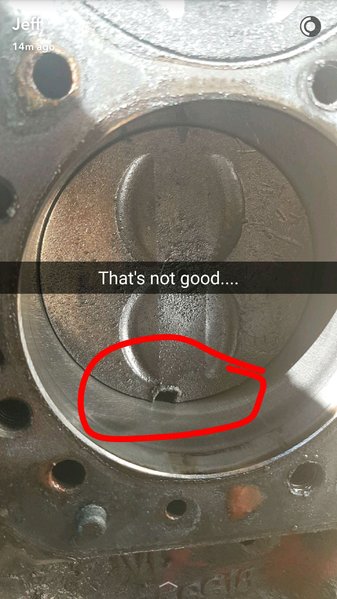

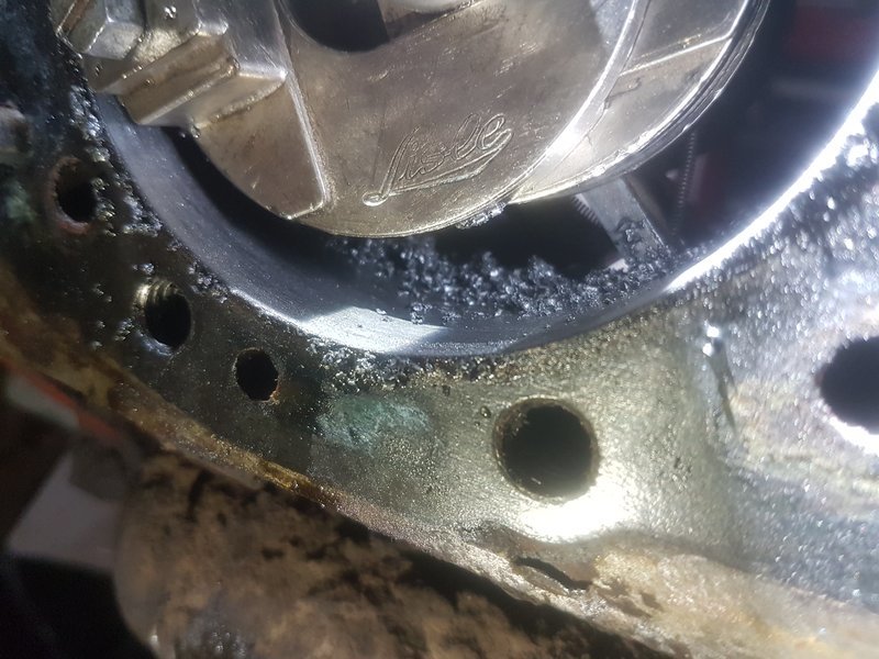

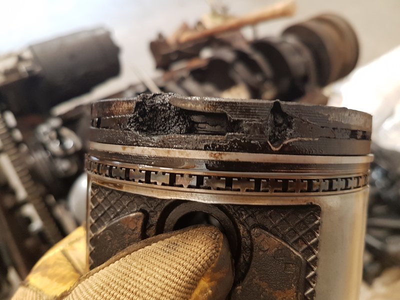

    Tore into the 350 engine today... found why it was using oil.....
    But i di find out it was bored .040 over already. Cylinder walls look good. So i will cut the lips and and throw a stroker kit at it... guess im doing a 385 instead of a 383 like i initially thought.

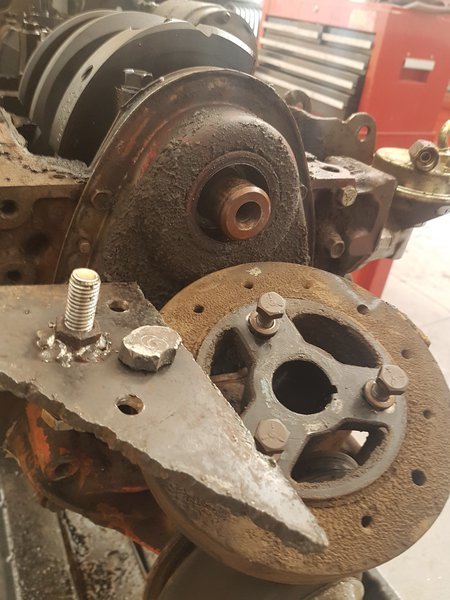

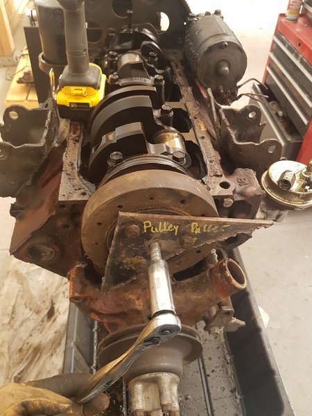

    Dug a little deeper and decided to cut the cylinder ridges while i was in there.
    Homemade pulley/harmonic balencer puller.

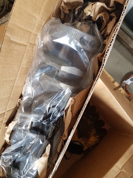

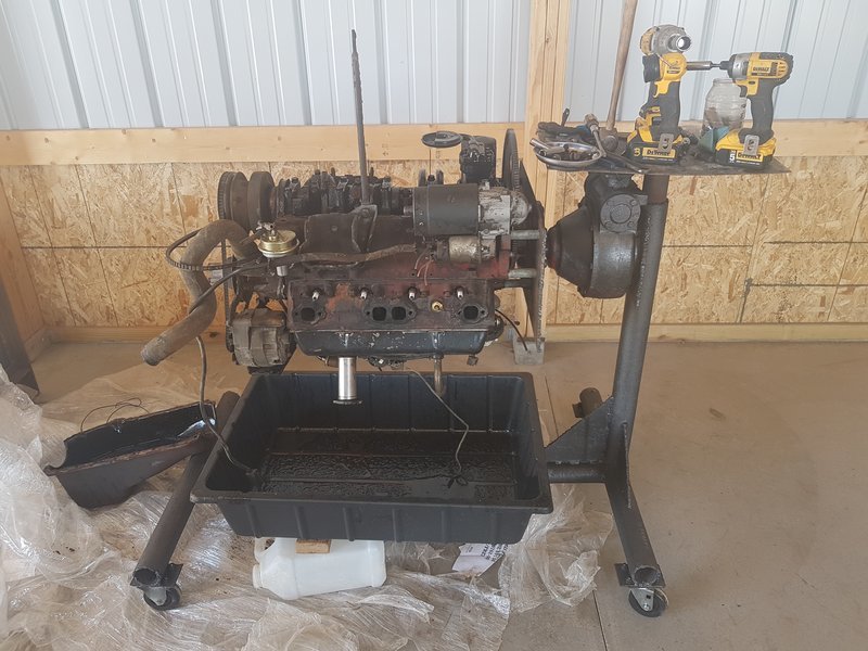

    Engine parts!!!! Just shy of 200lbs...

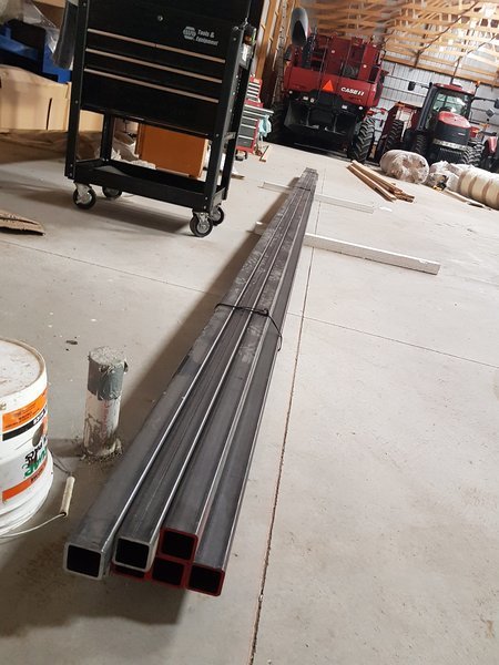

    Bought some steel to build some shop benches all i can lay out some parts and put my engine together.
