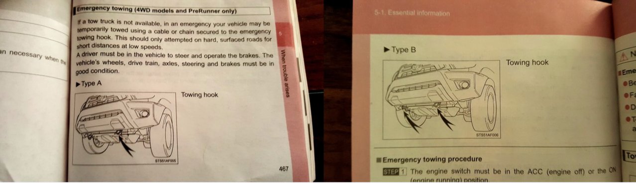

    That 50 miles @ 18 mph flat towing limit is imposed by the automatic transmission, not the strength of the tow hoop. For low-traction recoveries it's fine. If the truck is buried up to the hood in mud or thick ice, then pulling anywhere along the flimsy front crossmember will be iffy.
    What's stronger, the tow hoop at 90 degrees or the hitch on a unibody Cherokee? :laugh:
