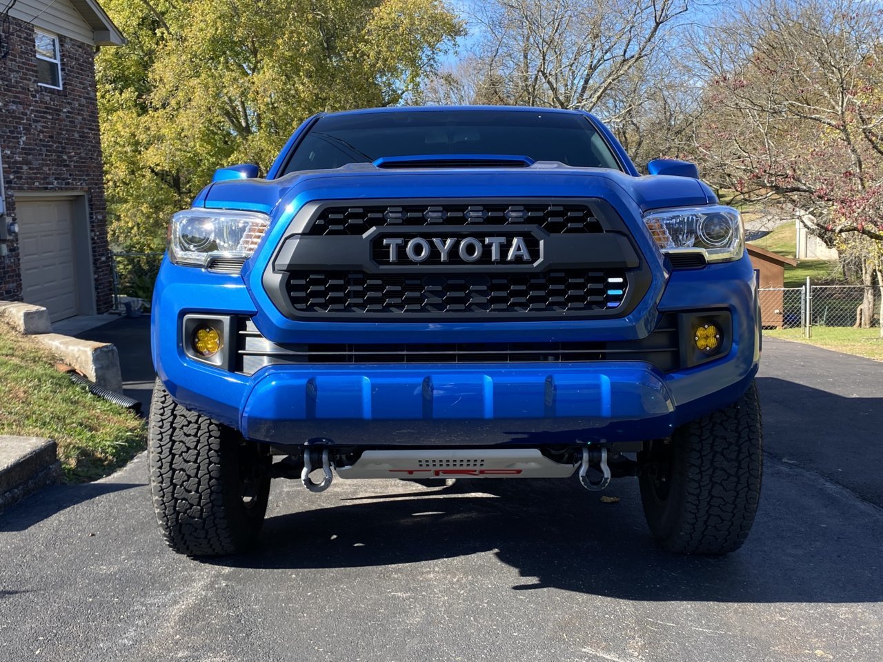

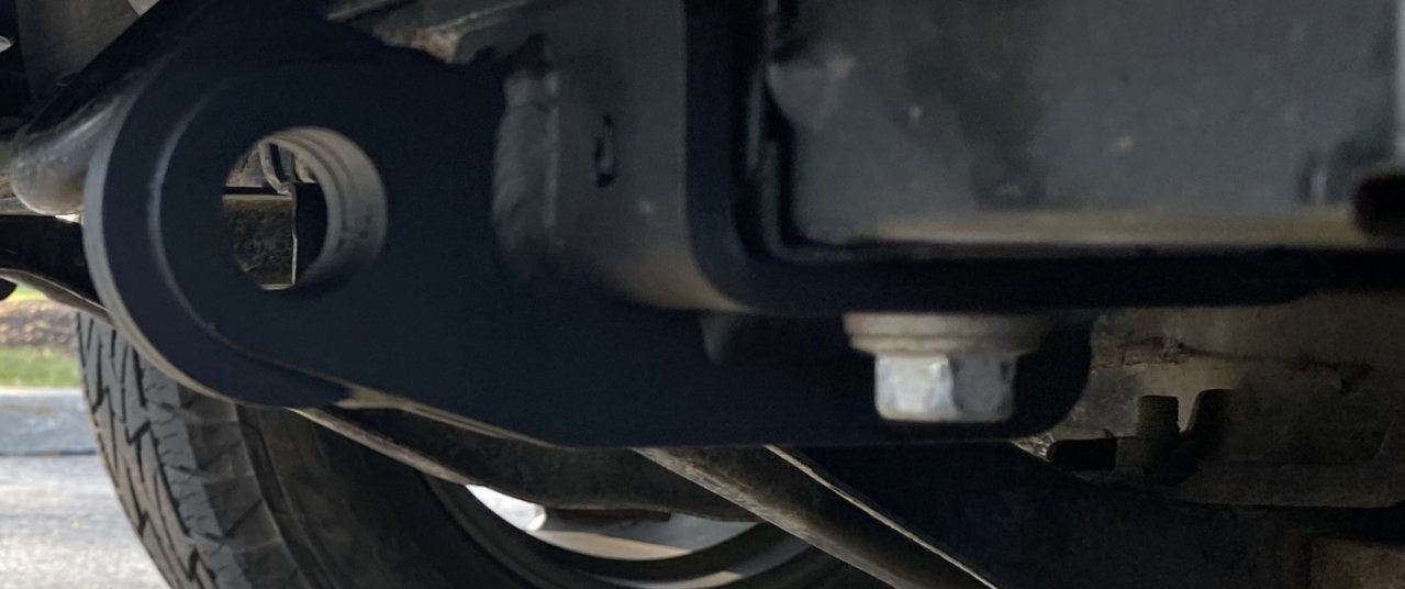

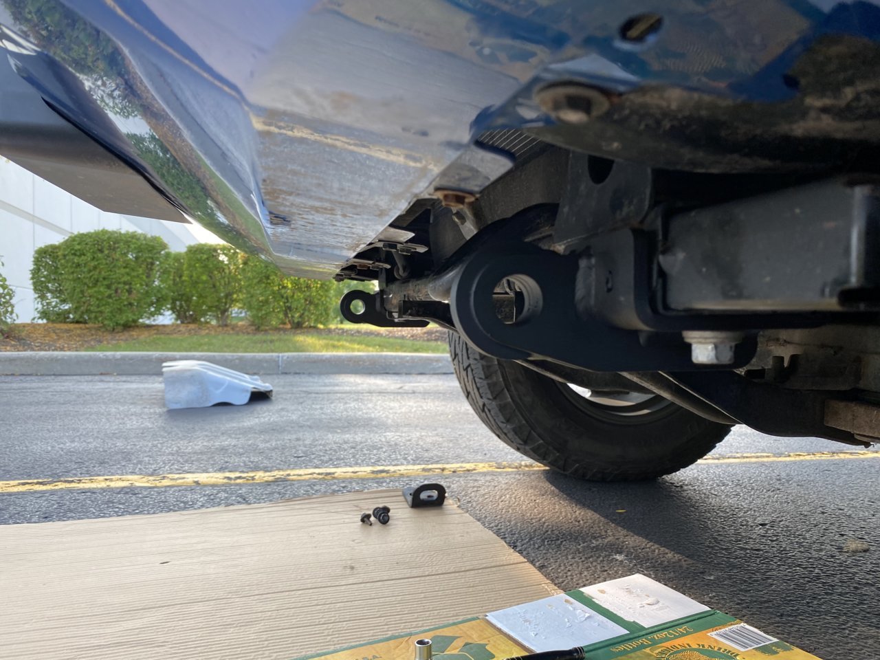

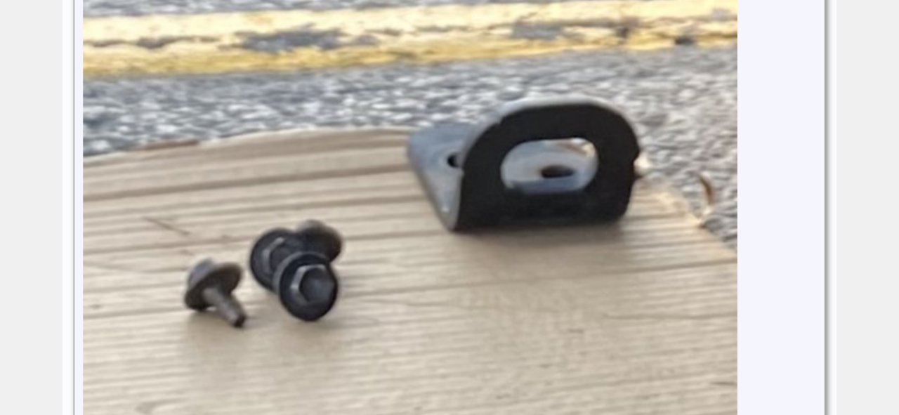

    I guess in a emergency I’ll use all 3 points.
    The 2 demon brackets and the towpoint on the drivers side that was welded on my 2017 sport.
    I hope I never need to use the front and can just get pulled from the hitch plug .

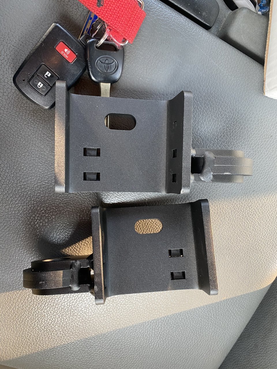

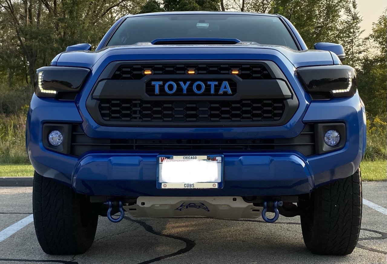

    Anyway here’s my show and go......
    As it came in the mail.
    The Demon Brackets
    instructions
    The brackets bolted on. Also left the drivers side tow /tie down because it’s welded in
    Removed the passenger side original bolt on tie down

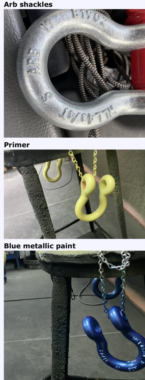

    I have a set of ARB shackles painted in Blazing Blue and the shitty Harbor freight in Blazing blue for those sticky fingered bastards that like to steal shit at the MALL

    The photos in Post #14 (above) clearly show that these are attached to the front cross-member on the frame.
    They are attached to the same front cross-member that the factory hook is attached to.
    They are designed to actually wrap around this cross-member, and pull directly from that wrap-around attachment, and not from the bolt itself. The bolt merely holds it in place, while the wrap-around design provides the strength. These are literally as strong as the cross-member on the frame - the cross-member on the frame will fail before these fail !
