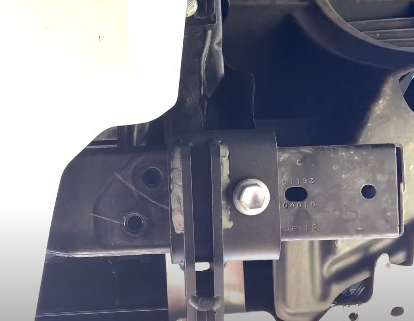

    Based on where they are placed on the frame, with only a single bolt, I wouldn't tug too hard on them.
    The lower cross member there is really only meant for a tie-down point on the vehicle, as it would cause a good amount of leveraged force applied to the frame if you really had to pull on the truck to get recovered.

    From the Demon Hooks website: Ideal for adding stylish aftermarket hooks/shackles to your truck.
    If you want to be able to hang shackles on the front to look good go for it but there's no way I would ever attempt to use these as recovery points. Flat towing or tie downs while towing on a trailer? Sure.
    These aren't rated recovery points like the ARB or other ones.

    I'd be more worried that a pull from the front is going to rip those welds apart..

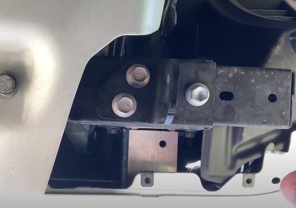

    Interestingly, the factory tow hook is attached to this same front cross-member. So, evidently Toyota thinks it is okay for towing/recovery; and I certainly feel comfortable using it for the same - no issues, no problems.

    The bolt is not what is being pulled against, the bolt only holds it in place up against the cross-member (see the photos). In fact, the bolt hole on the bracket is slotted for ease of installation (again, see the photos).
    I repeat: They are designed to actually wrap around this cross-member, and pull directly from that wrap-around attachment, and not from the bolt itself. The bolt merely holds it in place, while the wrap-around design provides the strength.
    It is actually quite simple mechanics/physics.

    The welds are very well done, and these things are very well made. I have them, I have handled them, and I am very impressed.

    That's the problem. Your failure point should be in your recovery, not your frame. You want the failure point to fail before you cause damages to your vehicle. Catastrophic failure points are designed in places. For example, people complain about the plastic gears in newer kitchenaid stand mixers. That's fine, the old ones were metal and the new plastic ones are cheaper and a cost reduction and now Joe Schmo needed to replace the cheap plastic junk. What Joe Schmo failed to realize is that a metal gear would not have failed, and would have transferred the power and caused a MUCH bigger issue.
    Point is - you want the failure point to be before the frame is damaged. Not after the damage is already done.
    They're tie down points for towing. Not for recovery.
    Wonderful. You have two people with engineering degrees (Mr. Engineer above, and now me, BS Mech E, currently engineer in aerospace) disagreeing with you, but you do you. You can use them for recovery all you want, not my truck, not my bent frame to deal with.
    I would certainly never try to convince someone who already knows everything; but for others who may be interested in the real-world application of these, the reality is they are well made, and they work.

    I have used them, and they work great!
    The attachment is as strong as the Toyota factory hook, attached to the the same cross-member.
