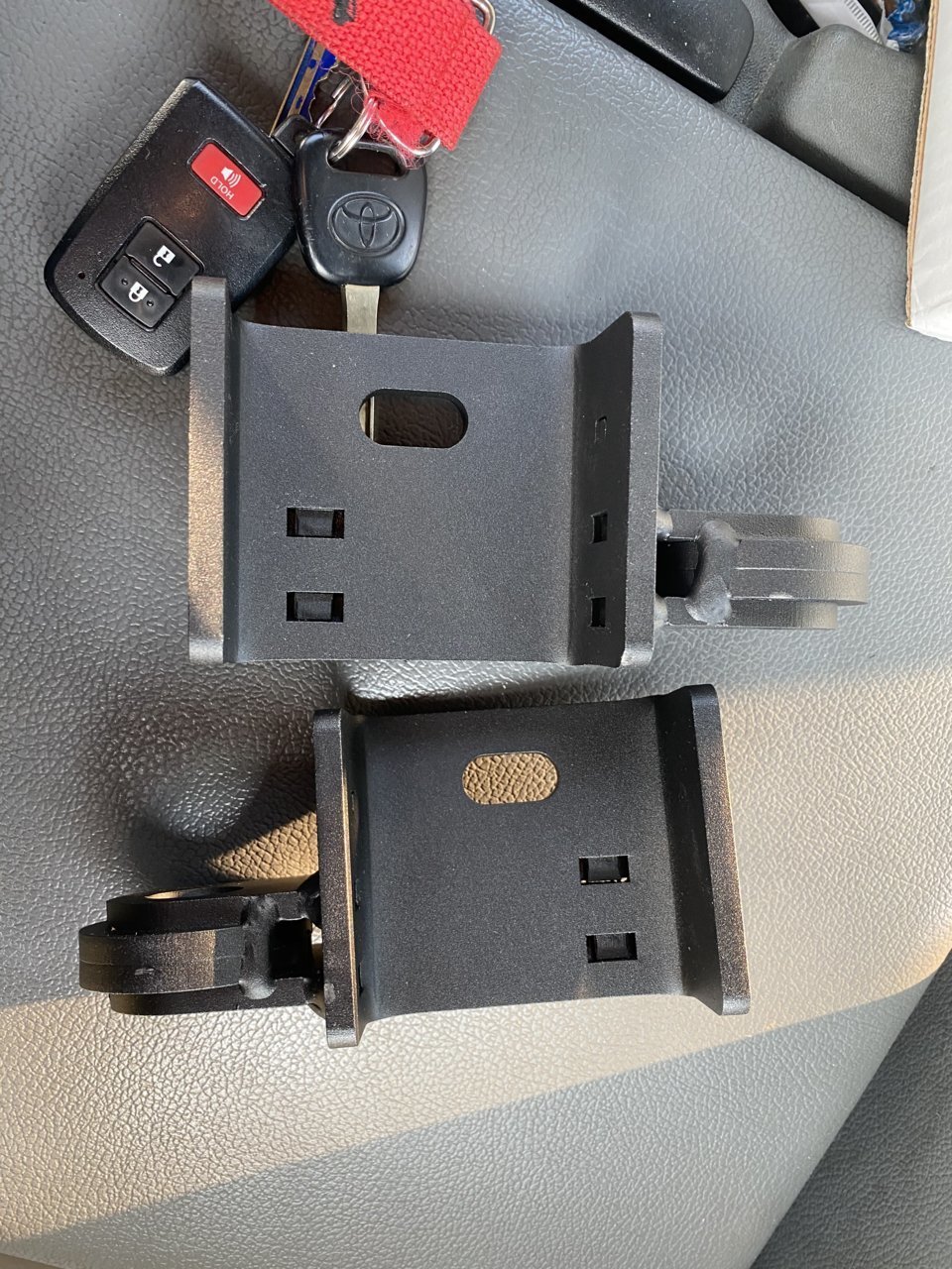

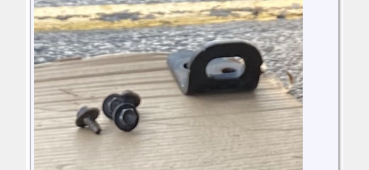

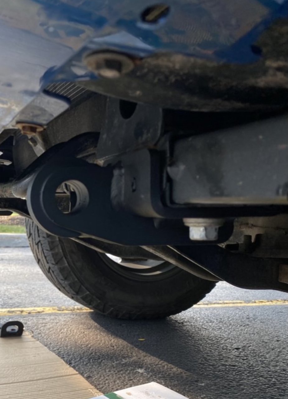

    Here’s the stock tie down point used to secure the vehicle to the semi truck when it’s in transit to the dealership.
    here’s the c channel Demon Brackets
    and here installed
    Close up
    Not sure if they hold but.......
    if I’m stuck ???? I’ll try.
