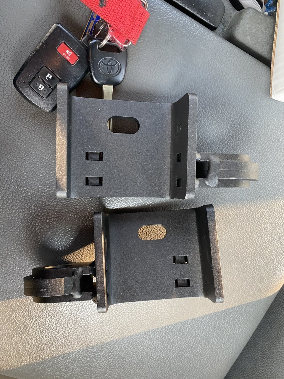

    To be fair, I think we have some confusion on the use of the word "recovery" versus the word "towing."
    I have both the Demon mounts and the BPF recovery point in my hands at the same time and they are night and day in terms of engineering. That said, I do think the Demon mounts would be fine for "towing." Which is probably what the vast majority of people talking about here would be doing. In that regard, they are probably no worse and probably better than the towing hook that comes on the Tacoma. Most likely better because there are two of them and they do wrap around the crossbar.
    But that is towing. Recovery is a whole different ballgame. I would use these Demon mounts for light towing but not recovery. The ARB -- the gold standard -- has "a Maximum Strap Rating of 18,000 Pounds and a Recommended Shackle Rating of 4.75 Tons." The BPF has a rating of 8,250 pounds. The Demon hooks are not rated for recovery.
    Keys to guide the discussion here are towing versus recovery and rated versus not rated.
    Maybe that helps the OP ... which was the goal! :)
