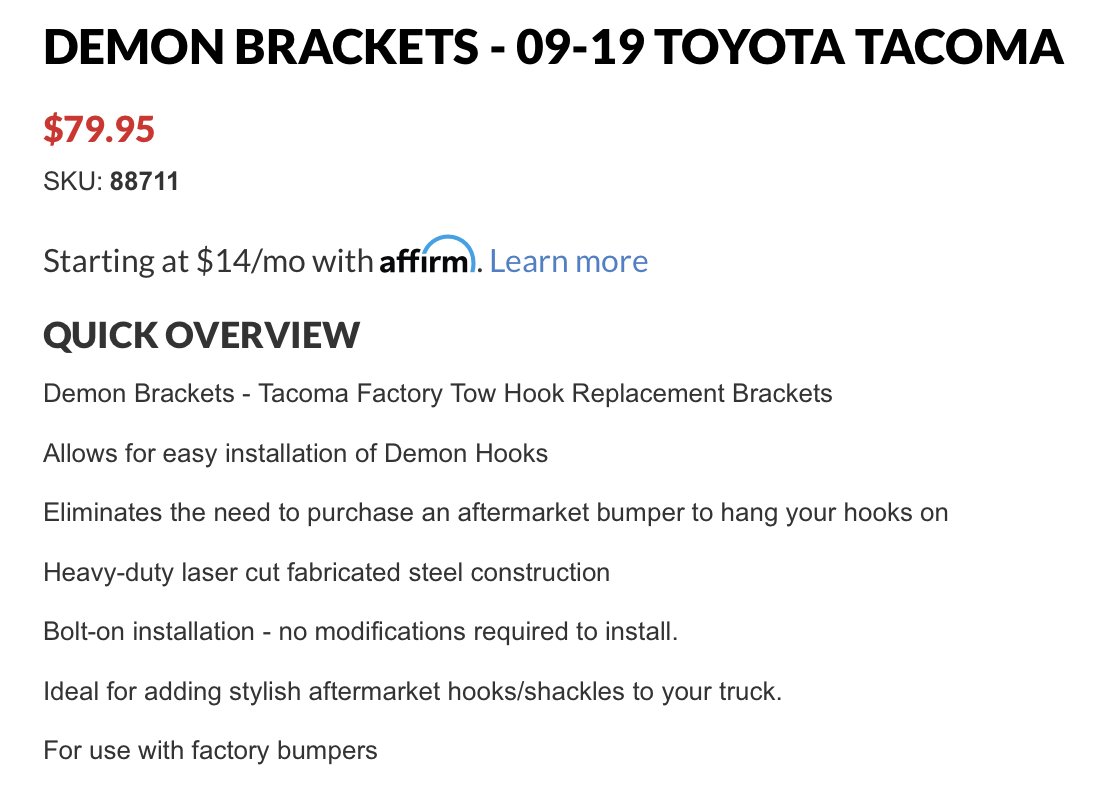

  13. Apr 29, 2021 at 5:08 PM
    #93
    averagejp
    averagejp Well-Known Member
    Aug 8, 2016
    #194056
    1,443
    2005 Black Tacoma Extended Cab
    Work in progress
    I don't want to beat these people up. They don't seem like a bad company -- just doing their thing in a different market. There is a place for their product. Probably better than the factory tow hooks (there are two, they wrap around the bar, etc.) for "towing" (not recovery) and I have no issue if people like to have the shackles hanging from their truck as a style choice. Not my cup of tea but as long as they are happy with it that is all that matters.
    But it is not like the company is hiding it. The come right out and say it in their description:
    barf likes this.
  14. Apr 29, 2021 at 5:12 PM
    #94
    chuam
    chuam Well-Known Member
    Feb 2, 2021
    #354841
    1,519
    Marcus
    San Diego
    2017 Tacoma SR5 DCSB 4x4
    Icon Stage 3 - 2.5 & UCAs front, Icon 2.0 rear Icon RTX Stage 2 leafs Icon 700lb springs RSI Smartcap Evo Sport KDMax Pro tune BAMF Hybrid front bumper Warn VR EVO 10s winch ARB Rear Locker Revolution 5.29 regear RCI Engine Skid RCI Trans skid RCI Transfer case skid RCI Diff Skid RCI Cat guards RCI Rock sliders RCI roof rack R4T LCA Skids DRT Fabrication Hitch Skid Exhaust reroute ARB Dual Compressor w/ Slee Mount OR Black Fenders Diode Dynamics SS3 Pro fog lights Rigid D-SS Pro Ditch lights Rigid SR Amber PRO Edition 30” light bar Rigid SR-Q floods A/C drain mod Differential Breather Mod Supralee Traction Board mount Liftd Gas cap holder Taco Garage DMM 2.0 Total Chaos bed stiffeners TRD SEMA Pro 17" wheels Falken Wildpeaks 275/70r17 TRD Pro Grill Gecko shell lighting Ecological Bumper shells Fumoto valve Toyota aluminum oil filter cap DesertDoesit Seat Jackers Waterport Day Tank - Rago Fab bed mount Yakima Double Haul OVS 270 Awning Wet Okole seat covers Overland Equipped/Blueseas Bracket/fusebox Toyota OEM tailgate lock Rogue Offroad poly body mount bushings ZPrecision cup holders H9 headlight bulb upgrade Lambtek innovations winch switch
    They should say "not for recovery or rated". If they did that I'd have no problem with it. Like I said as a tow point they should work fine but I feel they do need to specify this. It's not a matter of if but a matter of when these will fail because someone tries to do a recovery with them because they look like they should be able to do it.
    It's the reason I jumped on the ARB recovery point someone was selling because I'd done enough research to know it's the gold standard. I had an SOS and knew when I bought it that it would get me out of a pinch but I'd have to be incredibly careful in most situations.
    barf and averagejp[QUOTED] like this.
  15. Apr 29, 2021 at 5:12 PM
    #95
    averagejp
    Aug 8, 2016
    #194056
    1,443
    Work in progress
    Okay. That is a very fair point.
    chuam[QUOTED] and barf like this.
