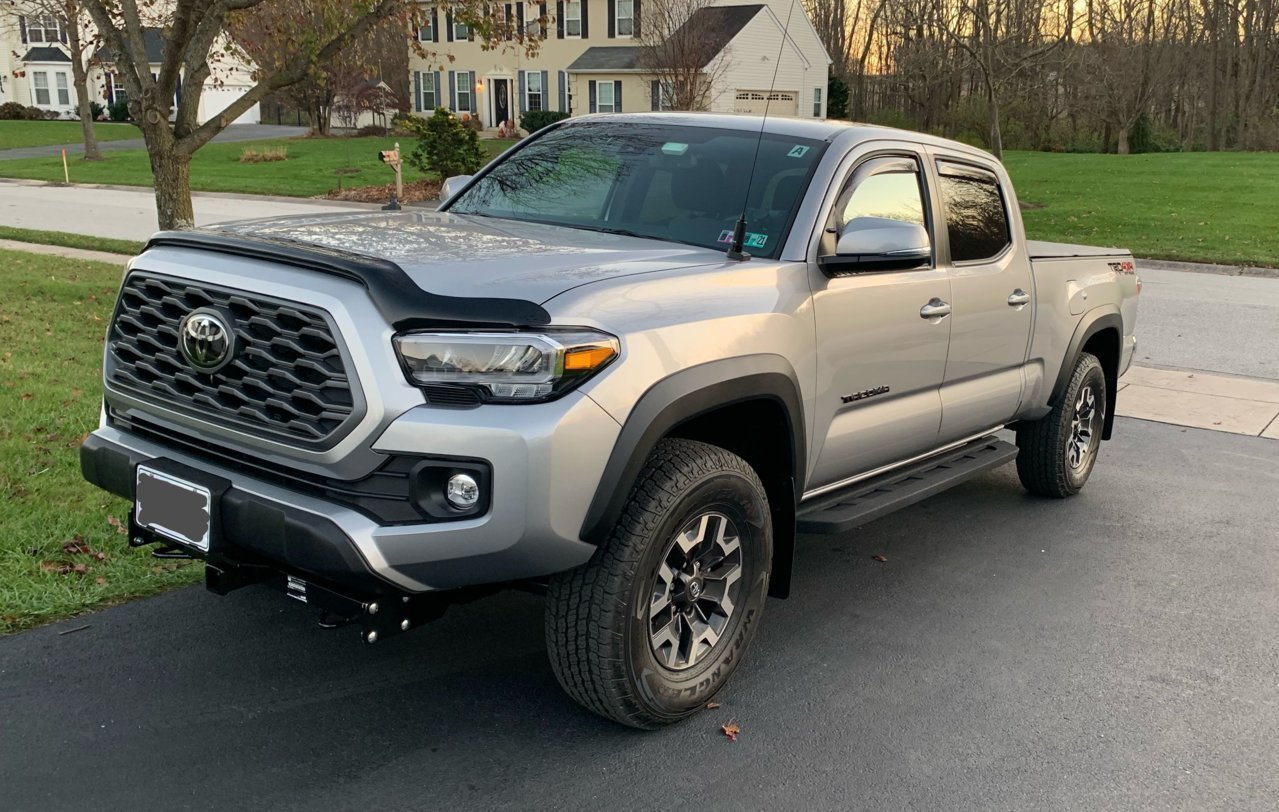

  6. Apr 29, 2021 at 5:40 PM
    #106
    Doc62
    Doc62 Well-Known Member
    Nov 7, 2020
    #346138
    642
    Dave
    SE Pennsylvania
    2025 Tacoma TRD Off Road i-FORCE Max, 2019 Sahara
    Here’s a picture.
    VTCAL and averagejp[QUOTED] like this.

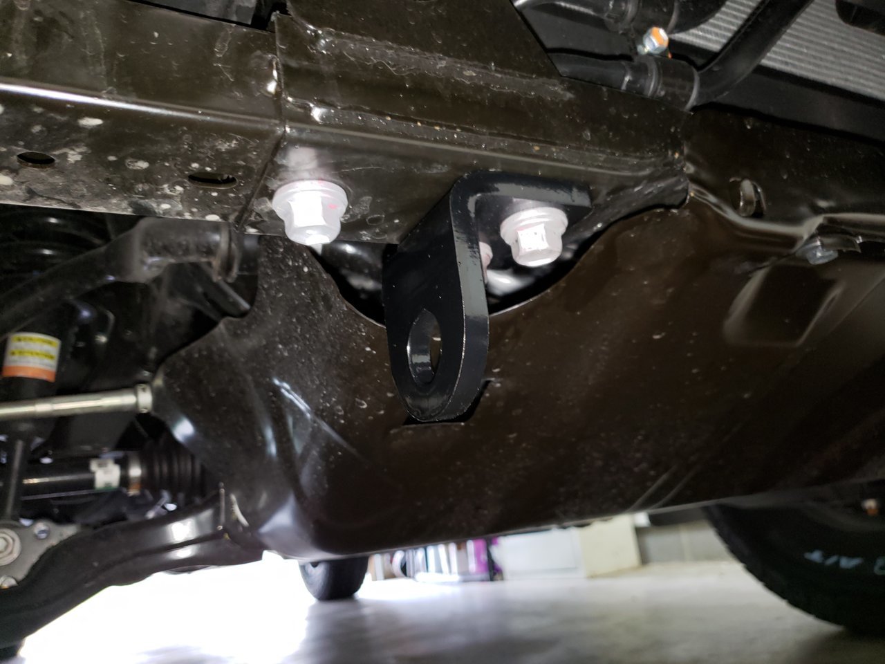

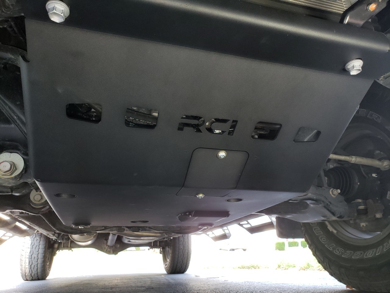

  8. Apr 29, 2021 at 6:05 PM
    #108
    Scottyskywalker
    Scottyskywalker Well-Known Member
    Dec 28, 2019
    #314425
    869
    Scott
    Kantukee
    2020 Silver Sky SR V6 4X4 SX
    RCI sliders, RCI front skid, RCI trans skid, Bridgestone Revo 3 AT, OTT tune, Fox 2.0 rear, Front Summo springs, Truxport roll up bed cover, Tekonsha P3, Meso total tails, rear diff breather relocate. JCW front bumper, Apex 12k winch, bar light. Alpine ILX 507, Kicker DX speakers, amber grill light bar, yellow LED fogs, LED headlights, bed mat, bed lights, front camera, rock lights, dash cam, seat jackers, recovery gear, Overland Equipment Aux fuse kit, C4 bumber braces.
    I have the RCI front skid which is attached with multiple heavy bolts. Could attaching to the plate provide a recovery point? Could hooking onto the plate at these openings provide a recovery option? 3/16" steel plate with two attachments to spread the force?
