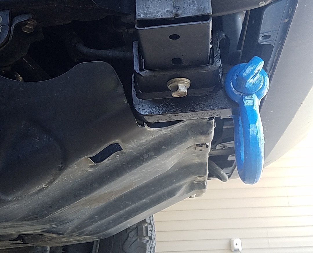

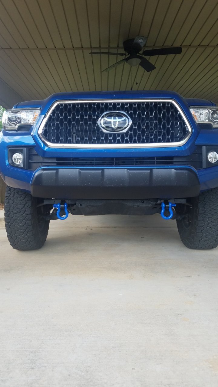

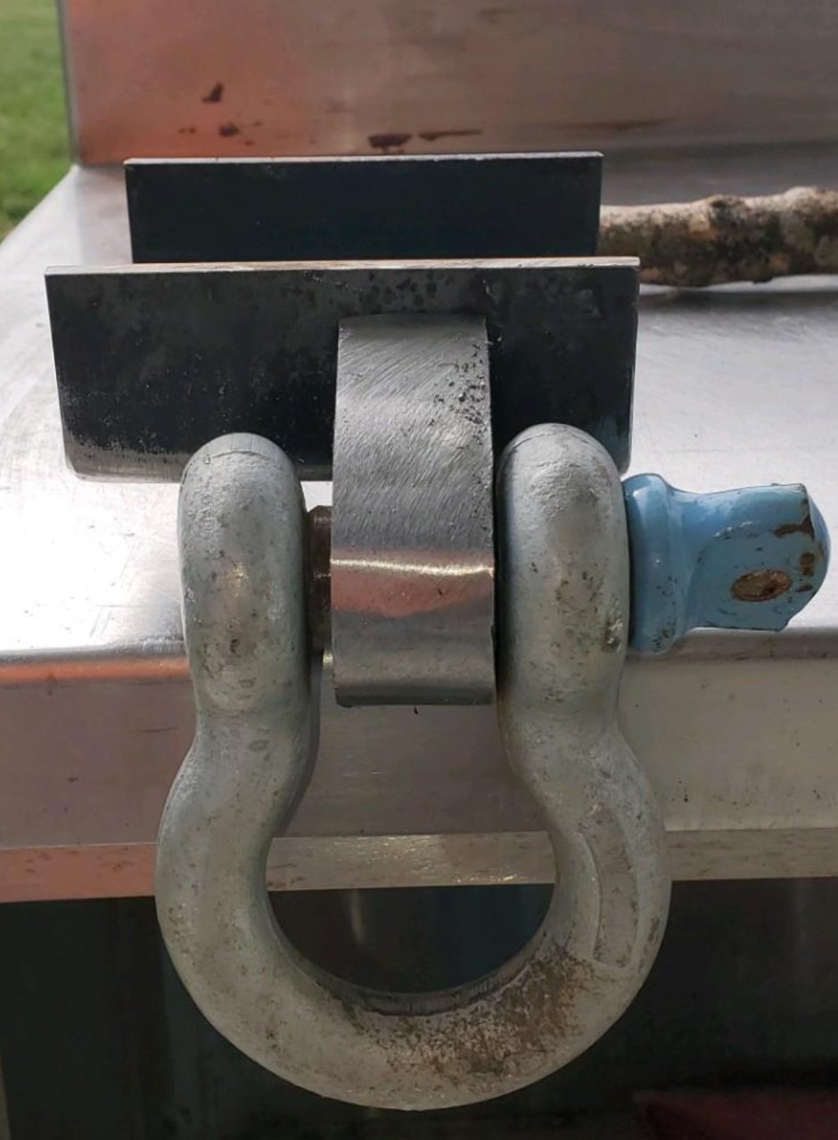

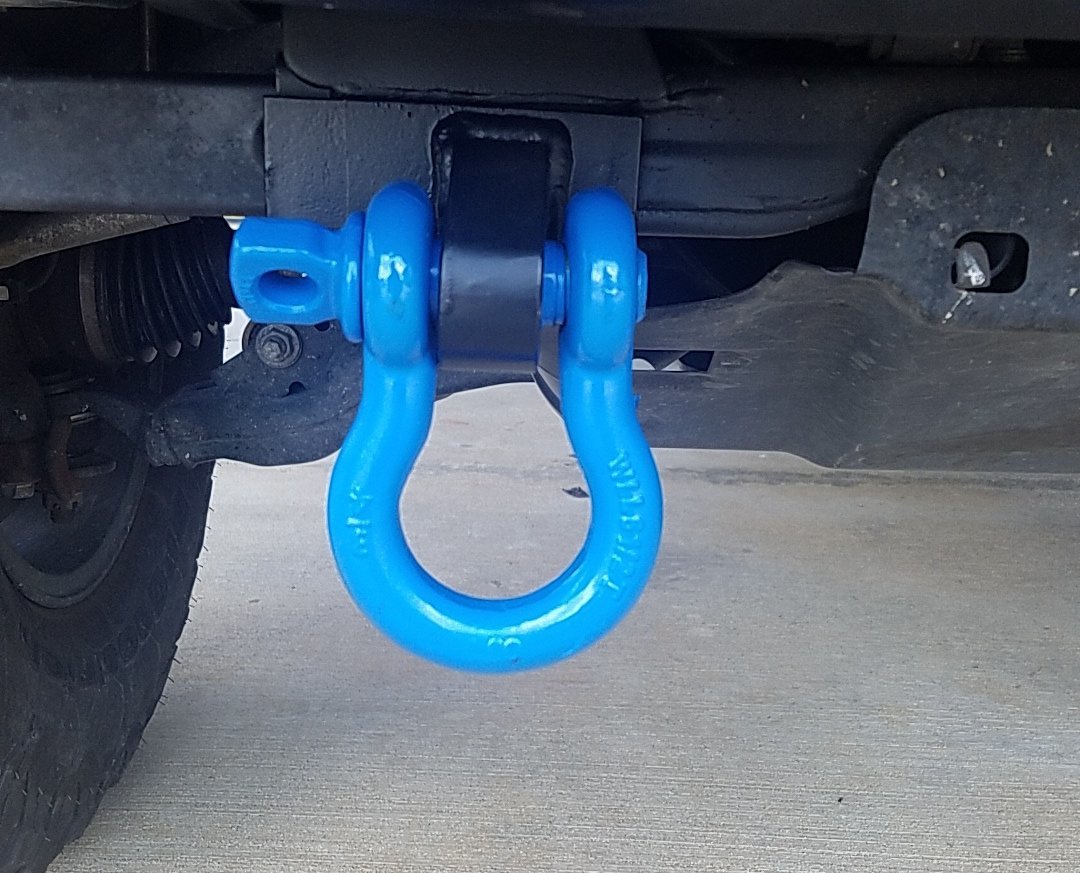

    Yesterday I visited an old acquaintance, whom I have worked with many times over the years, as our careers crossed paths. He is a licensed, practicing Structural Engineer with over three decades of experience, and for whom structural steel-to-steel connections are a large area of his expertise.
    I handed him this hook to evaluate (I only installed the one on the driver's side, so the other one was readily available for him to evaluate). His first words were, "It looks to be well made."
    I then showed him the one installed on the driver's side of my truck, to which he stated, "It looks like a good design, and it should be as strong as what it is attached to there."
    This was a real-world hands-on evaluation by a licensed, practicing Structural Engineer.
    Now, you stated above that "Literally every single one of [my] statements is incorrect in some way, shape, or form."
    But, of course, you never elaborated.
    For others reading this now, here is my statement which you say is so incorrect:
    "The photos in Post #14 (above) clearly show that these are attached to the front cross-member on the frame.
    They are attached to the same front cross-member that the factory hook is attached to.
    They are designed to actually wrap around this cross-member, and pull directly from that wrap-around attachment, and not from the bolt itself. The bolt merely holds it in place, while the wrap-around design provides the strength. These are literally as strong as the cross-member on the frame - the cross-member on the frame will fail before these fail !"
    I stand by my statement - it is undeniably both factual and accurate; and my observations have now been confirmed by a licensed, practicing Structural Engineer.
    But you are certainly entitled to your opinion, and I respect that; although there is no question that we will have to agree to disagree, for obvious reasons.
    I like this hook, and it works for me - literally, experientially, and in the real-world. I use the factory hook on the passenger side, and I pull out a shackle and use this hook when that is the more appropriate connection choice - they work for me, for what I use them for, no problems. I typically find myself pulling out someone stuck in mud, snow/ice, and sand on the beach. I do prefer to pull from the hitch on the back, but there are times when pulling from the front is better, and these hooks work for me. There is no question that a direct connection to the frame is a superior attachment, but these work well for what I am using them for - no problems.
    It's okay with me if you don't like or approve of this product, and again, I respect that.
    But, although I deserve the same respect for my opinion and my personal experience, I now realize that I cannot expect that here. And that is indeed a very sad commentary.

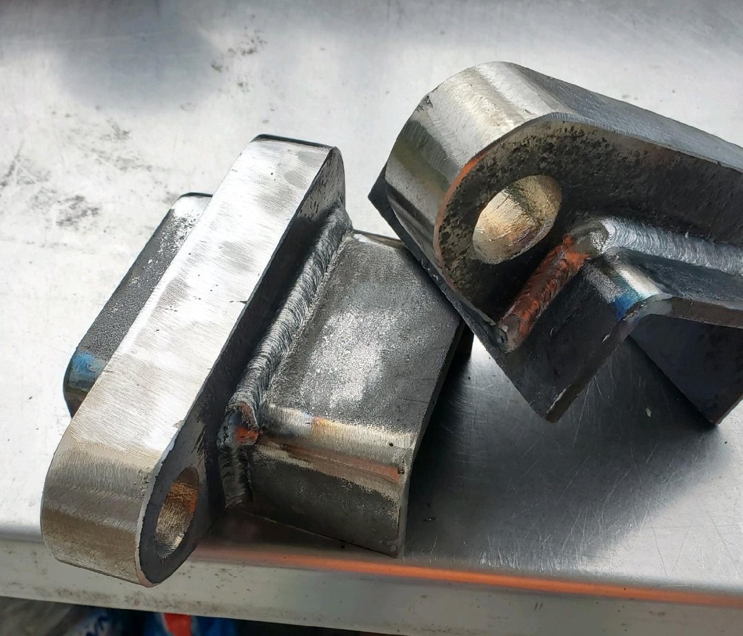

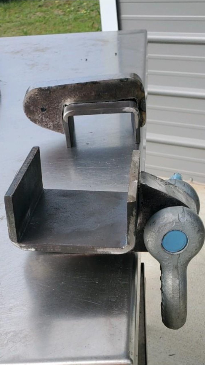

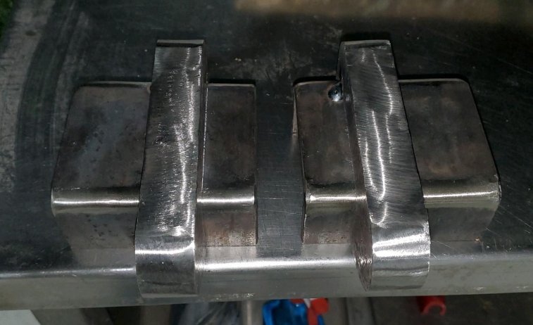

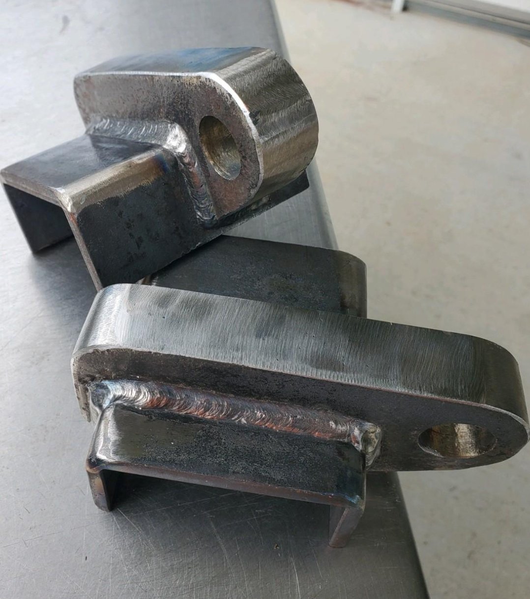

    update on the DIY "recovery" brackets
    BTH1, CalgaryQuicksand, VTCAL and 2 others like this.

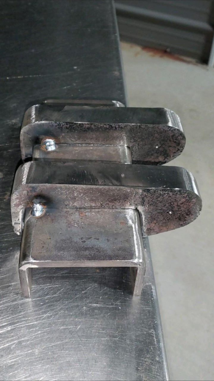

    Final results
    BTH1 likes this.

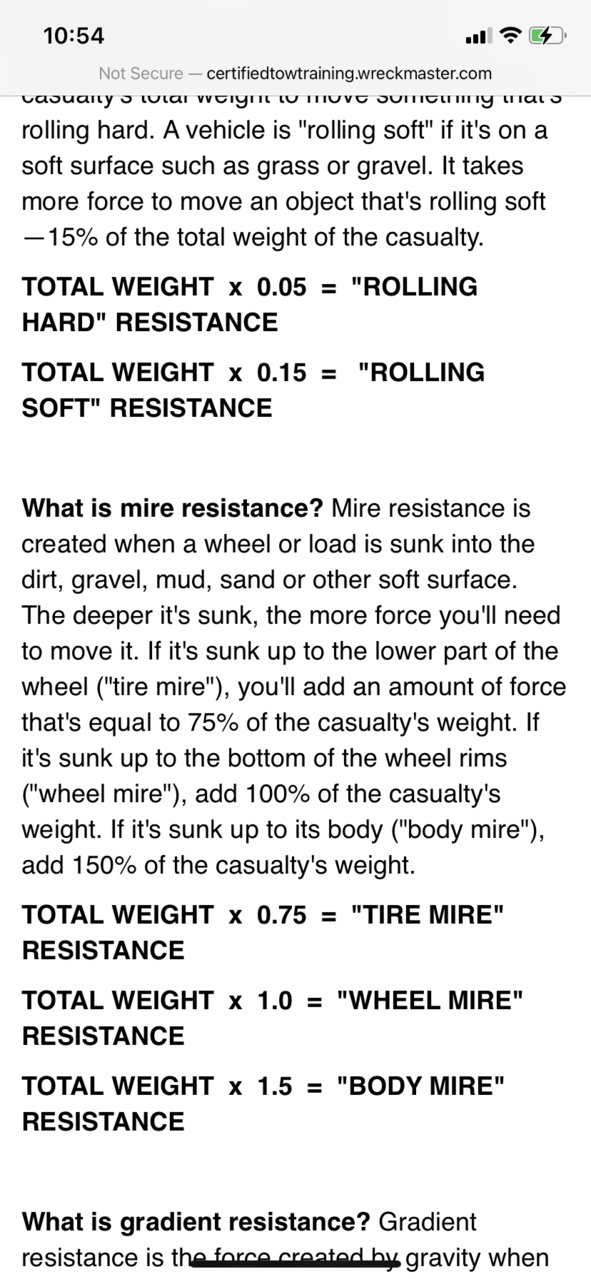

    I think there a couple of big things from a force perspective that people are forgetting here.
    The weight of the vehicle is not the force. There are multipliers based on the friction coefficient. It’s on wheels after all. Lol.
    The coefficient of friction depends on the angle of terrain and the medium stuck in.
    I’m too lazy go in depth of the formulas so I searched some recovery standards for a towing company and a recovery company. The forces are not near as high as people are assuming. Worse case scenario is 135% of the weight of the vehicle but as you can see other scenarios are much less.
    And another thing I think people are missing is assuming forces that are so much higher than the tow rating of the truck. You shouldn’t be trying to pull 10000lbs plus.
    I have no problem with using these demon shackles or the factory points or whatever. It’s for my recovery which as you can see is roughly the tow rating of the truck in the worst case scenario. And I won’t be trying to pull out any large one ton trucks or anything.
    Also, one thing we used to do when moving oil drilling rigs is when the force was too large we’d double line or rig it different. In this instance I’d connect to both shackles just to have an even higher ninny coefficient. That reminds me of another myth I’ve seen. We used chains all the time to drag loads off the bed trucks. No one died. High enough rating and don’t use it kinetic like. Put a mat or coveralls over it or something so it doesn’t fly if it breaks.
    I’m willing to put my money where my mouth is. I will find a way to test this real world.

    My point is you guys are Trolling these guys that are getting these things from your supposed expert opinion. And you don’t know what the f you are talking about. Either scientifically or practically.
    I am a Engineering Technologist and CDL driver with all my experience primarily being in Offroad driving. So many so called experts on here that don’t have a clue. Of course there is a disclaimer on that site.
    It’s not Engineering jargon. It’s from a recovery company that actually knows something about recovery. Lol. But if you actually looked at it you’d realize the most likely scenario for most situations is between 1400-4000lbs force.

    Because you are talking backwards. You said the weight of the vehicle is not the force and then go on to say you shouldn't be pulling 10,000lbs which no one is intending to pull with these hooks. So lets go back to the beginning.
    For practical purposes the weight is used for mass when calculating Force F=ma average acceleration of cars is about 11 f/s/s and we can use a Tacoma GVWR of 5600 lbs that equals about 8-9KN of actual force. I'd love to see you convert Newtons to 135% of vehicle weight...General rule of thumb is that winches and other recovery devices need 1.5 -2x vehicle weight.
    We have seen on several occasions during recovery operations with both kinetic recovery and winches the cross member failing. This is why we see many companies providing frame and bumper reinforcement plates. Moreover the factory recovery hook is mounted with two bolts instead of one and in a location with additional steel reinforcement, the demon hooks do not mount in the same location and do not come with any reinforcement. The common sense question then applies, why did Toyota reinforce this section and double the bolts....

    I can easily convert that. It is 2023.28lbs. I use kN at work all the time. I destroy road sections for testing in a research group at the university. The average force I need to destroy a road section 6 inches in diameter and 2 inches thick at -35 C is 45-60kN.
    I mentioned 10000 pounds of pulling another vehicle because how else would you need something rated for 18000lbs.
    i want to see pictures of these failures. I keep hearing about these mythical failures and people before have asked for proof and no one has them.
    This situation is a box frame encased by a c channel mount. As flimsy as that looks it is what it is.
    135% is in mud and on a 30 degree incline which no one is ever likely to see. 150-200%. Nice to have maybe but not really necessary.
