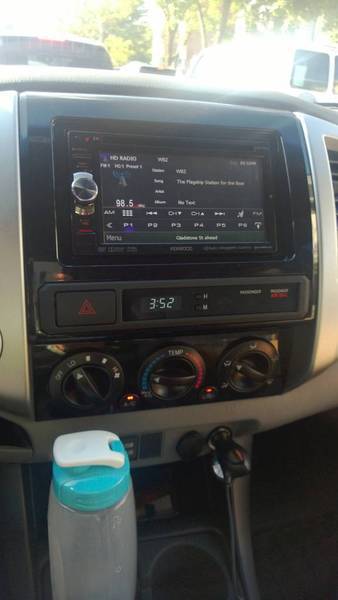

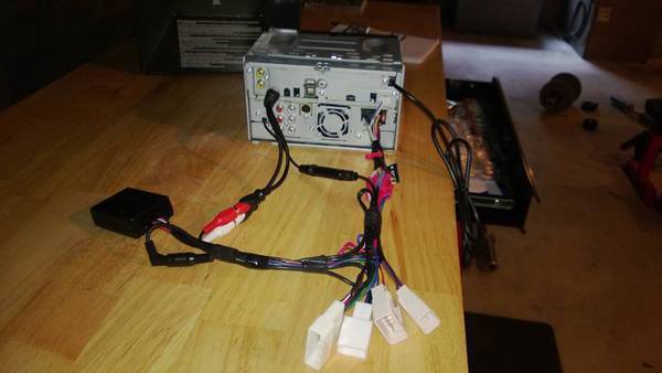

    I wanted to keep all the stock plugs, so I ordered all the adapters.
    Parts list:
    Head Unit
    Kenwood DNX-690HD Navigation Receiver
    Adapter to keep stock USB port
    Axxess AX-TOYUSB Toyota 4 Pin USB Adapter Axxess AX-TOYUSB Toyota 4 Pin USB Adapter
    Adapters for to HU and antenna plugs
    0000530075 TOYO TACOMA 05- MS
    Toyota & Lexus antenna adapter 09-Up Toyota/Lexus Toyota & Lexus antenna adapter 09-Up Toyota/Lexus
    Metra 70-1761C Wire Harness for Toyota/Scion/Lexus/Geo 87-up Metra 70-1761C Wire Harness for Toyota/Scion/Lexus/Geo 87-up
    Steering Wheel Controls (this also lets you keep stock aux-in with RCA to 3.5 mm adapter)
    Axxess AX-TOY28SWC Steering Wheel Controller Add-On Harness with RCA and 28-Pin Connector for Toyota Vehicles
    Axxess Metra ASWC-1 Universal Steering Wheel Control Interface with New Micro B Connector (Black)
    Dash Kit
    Metra 95-8235CHG Double DIN Dash Installation Kit for 2012 Toyota Tacoma Vehicles (Charcoal High Gloss)
    Pretty much all wired up. My friend helped with the wiring, which makes this a lot easier / reliable.
    Installed:
    Some gotchas for the install:
    Wiring the adapters is pretty much color matching. Blue wire from antenna adapter goes the head unit and the blue wire from the main harness isn't used. Brown wire from steering wheel adapter goes to steering wheel control on the HU. I grounded the parking brake wire.
    Take time with removal, there a good video on youtube.
    The metra dash kit is a bit fickle. I used the screws from the stock HU to attach the brackets. It took some adjusting to get the fit right. Reuse the bottom two white clips from the stock unit.
    I ran the GPS and mic through the glove box and up the passenger side. Mic wire is easy to tuck into headliner.

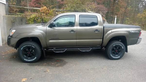

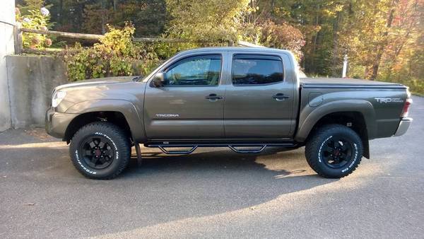

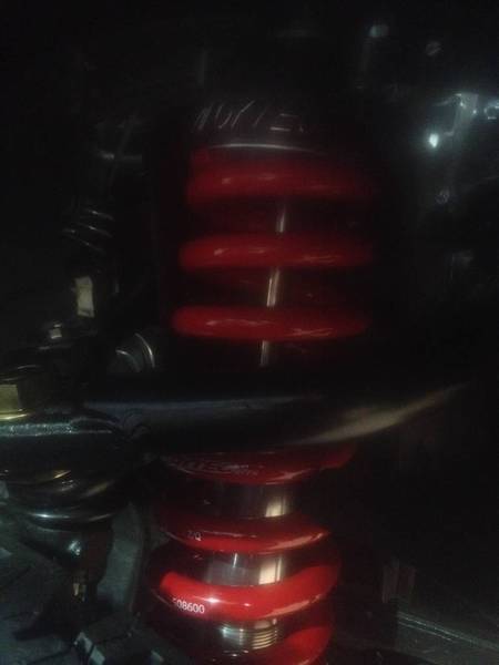

    Sneak peak of the coilovers on. Looking forward to seeing the final package.
    All done, really happy with how it turned out

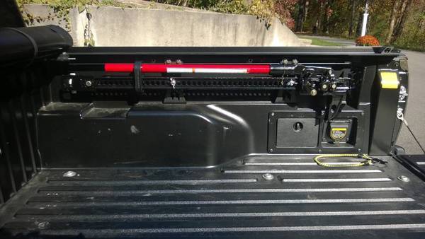

    Relentless Hi Lift Mount

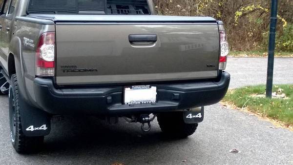

    Dipped the badges and rear bumper

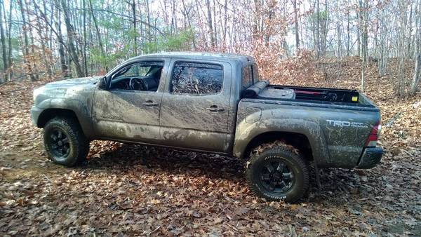

    First wheeling trip up at All Wheels in Maine. Good time, we didn't go only anything too crazy and had some fun in the mud. No steps or front flaps for the trip.

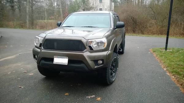

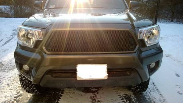

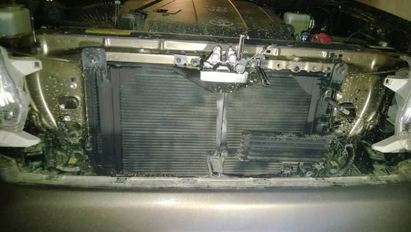

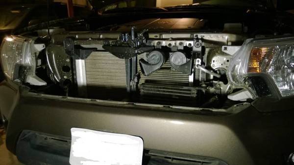

    relocated horns/ temp sensor and painted the radiator black.
    Before:
    Horns / sensor moved
    Painted radiator. It looks bootleg in this picture, I think partially the light. I didn't paint the color matched body pieces
    You can see the difference now with the grille on vs unpainted

    Looks great that's wiring is on point! Good to see when people actually care for neatness when comes to wiring
    Overall perfect height IMO

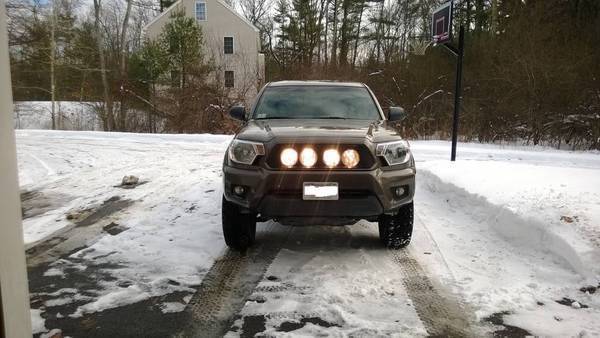

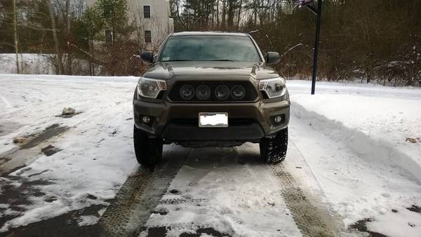

    added the BAMF behind the grille light bar mount with 4 hella 500ff lights controlled by the tundra parts rocker switch.

    Looks great, Only thing I would change is go LED instead of Hella's behind the grille. Less than half of the current draw and much brighter. Also they are rated at 20,000 to 50,000 hrs use.
