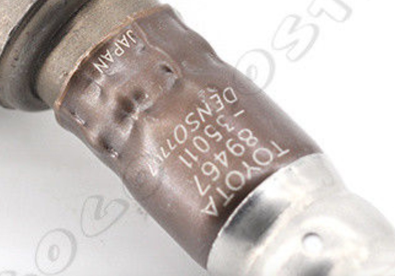

    That's my understanding, yes.
    Note how neither of those has the hex portion on top, which matches what is on Denso's own website. Also, my fake one had slotted mounting holes and the actual one did not.

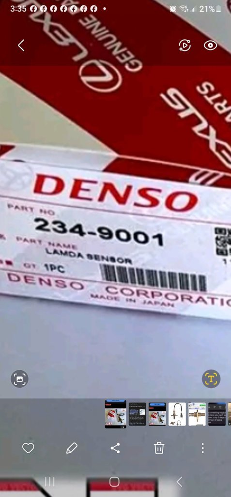

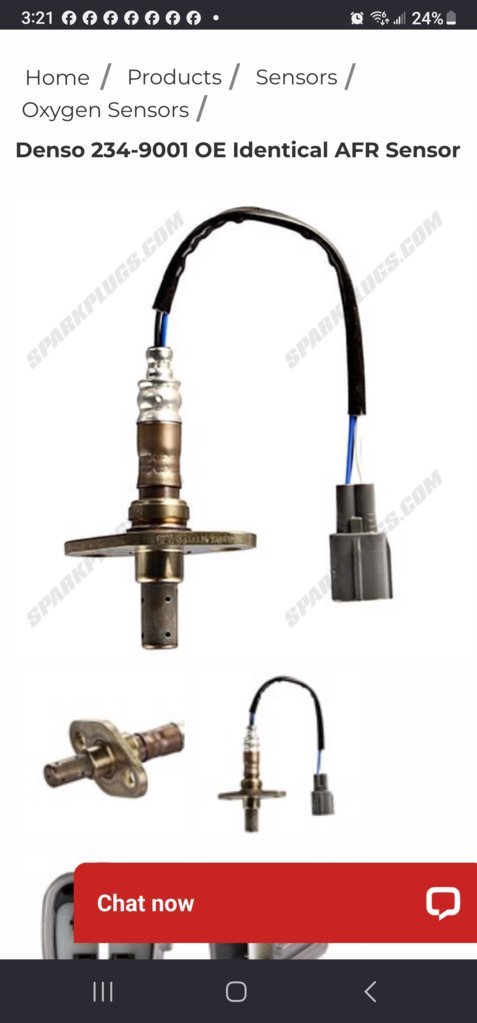

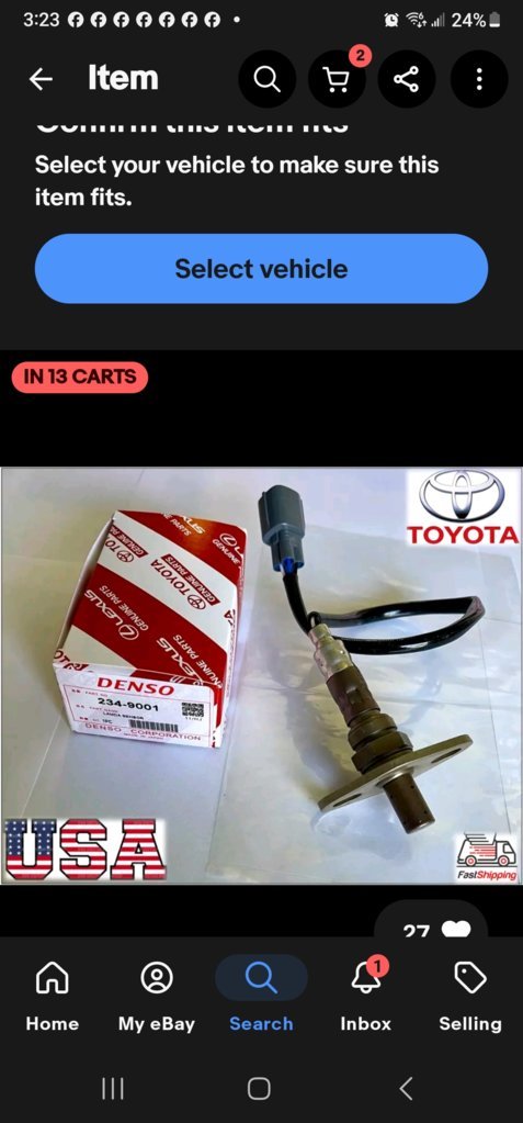

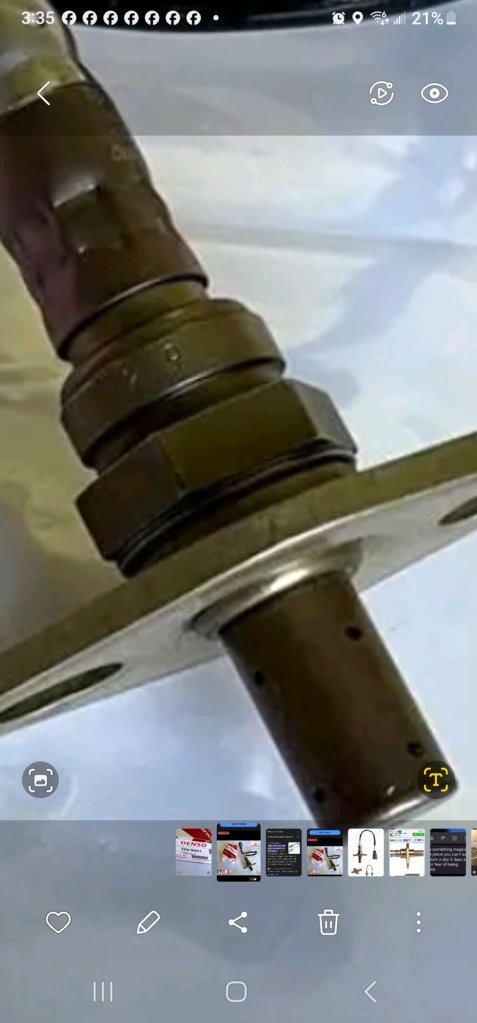

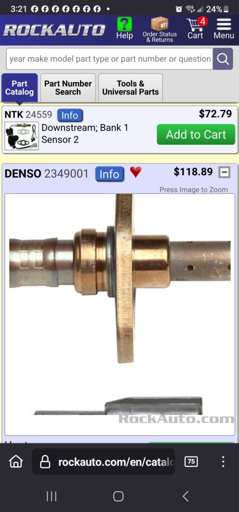

    OEM Denso vs fakes. Denso and Rock Auto do not contain the hex nut built into the body:
    Ebay O2 sensor: has hex built in.
    More importantly, this is known as a LAMBDA sensor. Not LAMDA as it is misspelled on the fake Denso prop box thoughfully included. My 2 cents: not Denso.
    Screenshot_20250504_153521_Gallery.jpg Screenshot_20250504_153530_Gallery.jpg
