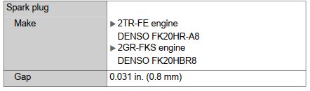

    Tacoma manual calls for 3419 (0.031 gap) plugs, but people seem to have luck with the Denso 4705s (which have a different gap). Anyone have any experience with 4705s? AAP says the 4705s are an exact fit to my 21 Tacoma SR, so would it be a problem?

    Interesting, so no need to adjust gap or anything from 0.4 to 0.3? They're good to go right out of the box?

    Some trucks don’t like those plugs with the .039” gap vs the .032”. The 4.0l engines had this issue with the iridium plugs. Mine wouldn’t idle as well.
    I plan to stick with the factory platinum plugs

    Suggest you install what Toyota would.

    Toyota 90919-01263

    I've been running the twin tips for about 70'000kms and truck runs just the same as with the long life's. Maybe marginally rougher but no change in fuel economy or power. I'll try long lives again next time
