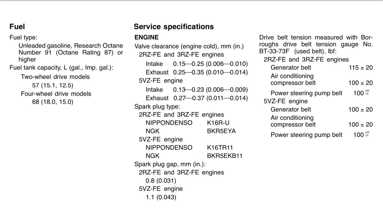

    Sorry if this has been covered. I just bought a set of K16R-U from Amazon. Now I heard there is a K16R-U11 and the difference is the U11 has a wider gap?
    Which plug is the right one for my 2.4 1996?
    And what do you gap your plugs at?
    Thanks for the info

    The ones you bought are what Denso’s application guide shows for copper plugs. The gap widens depending on which Denso plug you choose. Dig out your manual to see what it shows.

    I got this off the Toyota website
