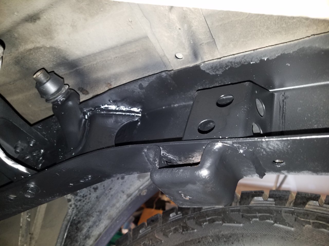

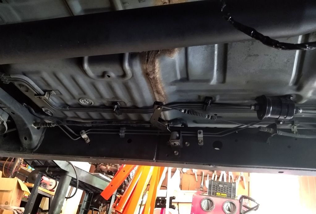

    Get a really good look into the pockets that are created by the shock mounts.
    There’s actually NO drain hole especially the passenger side that slopes down hill.
    I’ve debated about drilling drain holes on both of these.
    The shock mount cover 3.5 of the 4 sides.
    A great place for rust to grow

  2. Jul 27, 2019 at 1:32 PM
    #22
    CS_AR
    CS_AR [OP] Well-Known Member
    Apr 3, 2019
    #289019
    12,905
    1999 Tacoma PreRunner TRD
    Everything but the driveshaft. B03A - 410
    Thanks. When I get into it this fall, I'll post pics for ideas.

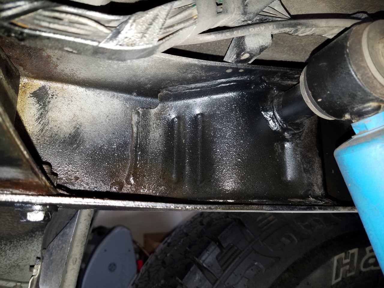

  3. Jul 27, 2019 at 1:36 PM
    #23
    1997tacomav6
    1997tacomav6 V6 5sp,RegCab,TVS1320 Supercharger,Haltech, 800k
    Oct 5, 2013
    #113940
    10,391
    John
    Denver
    97 reg cab, v6 5sp 300hp supercharged, Methonal Injection, 800,001 plus miles, Original Owner
    V6 5sp,RegCab,TVS1320 Supercharger, 56mm pulley, methanol injected Haltech ECU, AC Tvs1320 supercharger,(MUST DO) every 125,000- 150,000 needs rebuild Projector headlights HID 5 speed manual Amsoil for all drive train Smaller 56mm custom pulley, (MUST DO) 2004 DESNO fuel injectors, zero ping ping, 2004 side door mirrors Dick Cepek Rims, Michelin tires LTX, ATM Pathfinders Dynopro ATM ( that last 100,000 miles) Now running Dynopro ATM mud and snow tires KN cold air intake Cat back dual exhaust with ss exhaust tip, Raised exhaust tail pipe to 2" below body line Optima*dry cell battery,red top Alpine sirius radio, 200 watt amp, focal is165 split door pod speakers Focal door speakers Subwoffer behind seat Viper alarm, Electric Locks Dark tinted windows, bucket seats corbeau lg1 Tacoma Rubber floor mats TRD fender extenders, Bilstien shocks, King shocks JBA UCA trailer iv hitch, electric brake control, Drilled slotted brakes, High carbon steel (MUST DO) EBS green stuff 7000 series pads(MUST DO) TRD engine oil cap TRD stick shift, Marlin crawl shift kit. Rear sliding window 2002 4Runner functional hood scoop cut into Tacoma hood, 4Runner dual overhead map light Gentex Auto dim + Compass + Temp, garage,rearview mirror Snow Methonal kit stage 2 Custom 3 core aluminum radiator Linex bed liner Haltech stand alone ECU, Intake supercharger gauge. Stainless steel brake lines, Custom leather wrapped steering wheel, Haltech stand-alone ECU,
    Fluid fluid I’m guessing is the only option, but theses no way to look in there beside a borescope and
    no way to sand in these pockets or paint in there completely
    I actually thought about filling the pockets up with axle grease or with a grease gun to seal up any rust. Haha

  4. Jul 27, 2019 at 1:44 PM
    #24
    CS_AR
    Apr 3, 2019
    #289019
    12,905
    The inside doesn't look bad from what I remember. I want to clean up the gravel rash and surface rust that came along with it on the outside before it grows into something larger.
    Once I'm done refinishing, I'll pump it full of fluid film each year.

    when is a good idea to have this done?
    image not working :redxfall:
  6. Oct 8, 2019 at 5:53 AM
    #26
    GQ7227
    GQ7227 mw survivor
    Dec 6, 2018
    #275019
    29,298
    J A Y
    what is wrong with your frame here?
    is that just dirt you can wipe off to reveal nice 'shiny' black frame paint?
    i have solved this problem (thank goodness!) ... almost $700 to do so!
  7. Oct 8, 2019 at 5:58 AM
    #27
    GQ7227
    GQ7227 mw survivor
    Dec 6, 2018
    #275019
    29,298
    J A Y
    someone in St Louis told me its possible to cut some large section off on the inner rail and then re-weld it back :notsure: perhaps at the factory welds (i don't know)
  8. Oct 8, 2019 at 6:06 AM
    #28
    GQ7227
    GQ7227 mw survivor
    Dec 6, 2018
    #275019
    29,298
    J A Y

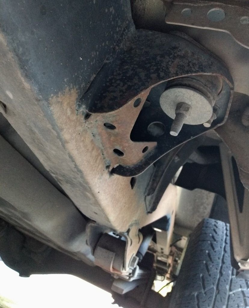

    do you have a pic of the area right where it turns from C channel to the boxed portion, the metal that is at an angle, its somewhat difficult to get at unless you're lifted
    i am curious as to how thick that piece is
    that is the best place for it to grow in my area

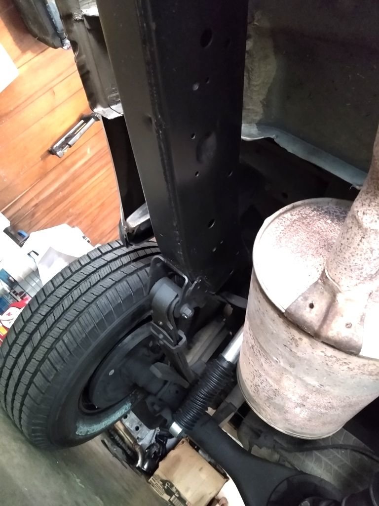

    No, I’m having the bed taken off in a few weeks and clean and paint the top of the frame

  10. Oct 8, 2019 at 6:15 AM
    #30
    CS_AR
    Apr 3, 2019
    #289019
    12,905
    Turned out to be dirt. Just some surface rust around the wheels and the end.
    GQ7227[QUOTED] likes this.

    thanks, it was kinda hard to tell from the pic if all the paint had come off and surface crust or not
    damned chemicals

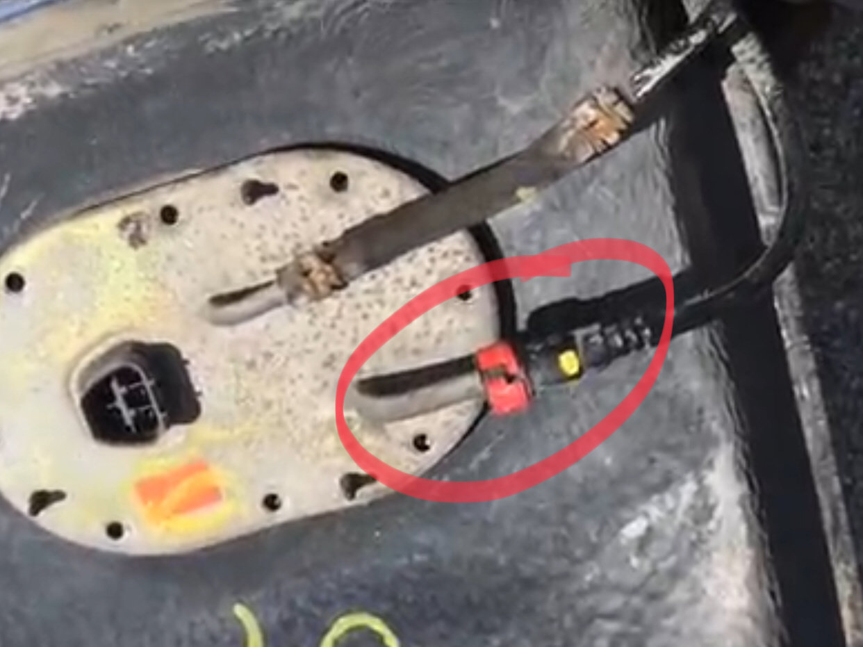

    So your saying to probably replace the two rubber hoses that come off the tank sending unit?
    For the early setup 1997 are the hoses just attached with pressure clamps?
    Getting my parts now for this job.
  15. Oct 8, 2019 at 7:21 AM
    #35
    se7enine
    se7enine MCMLXXIX
    Apr 18, 2013
    #102322
    23,442
    Reno, NV
    They have light tension pinch clamps. It's only about a foot and a half of hose between the two.
    1997tacomav6[QUOTED] likes this.

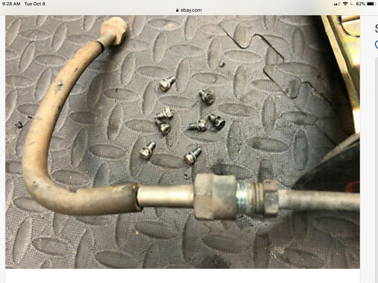

    So for the 1997 is there this type of adapter that I need a special tool for or it just pulls off? Or do you disconnect the hose further down the line and not from this location
    Or 1997 didn’t use this type connection till later.

    It probably is more like this

    Looks like its possibly a flexible nylon hose that bolts on, got it

    The hoses are attached to the hard lines with AN style fittings. Really a quick job if you can lift a good amount of weight, fastest to sneak it out under the bed, run it dang near out of gas so it’s not too heavy. I think pulling the bed is a waste if you have a tonneau cover or shell. The biggest waste of time is getting the electrical connection loose on the pump PITA! It will definitely put pep in your trucks step and take some pep outa yours, ouch! crooked back, lol.:thumbsup:
  20. Oct 8, 2019 at 11:25 AM
    #40
    Luv my yota
    Luv my yota Well-Known Member
    Aug 27, 2017
    #228278
    965
    00 turd lift 33's
    Kings,total chaos uppers, Deavers, JBA headers, Borla exhuast, engine mods, DC power 270 amp alt, 2k watts of sound, gps alarm.
    Make sure to oil the hard lines nut, lol, or it will be a pain to take it off later.
