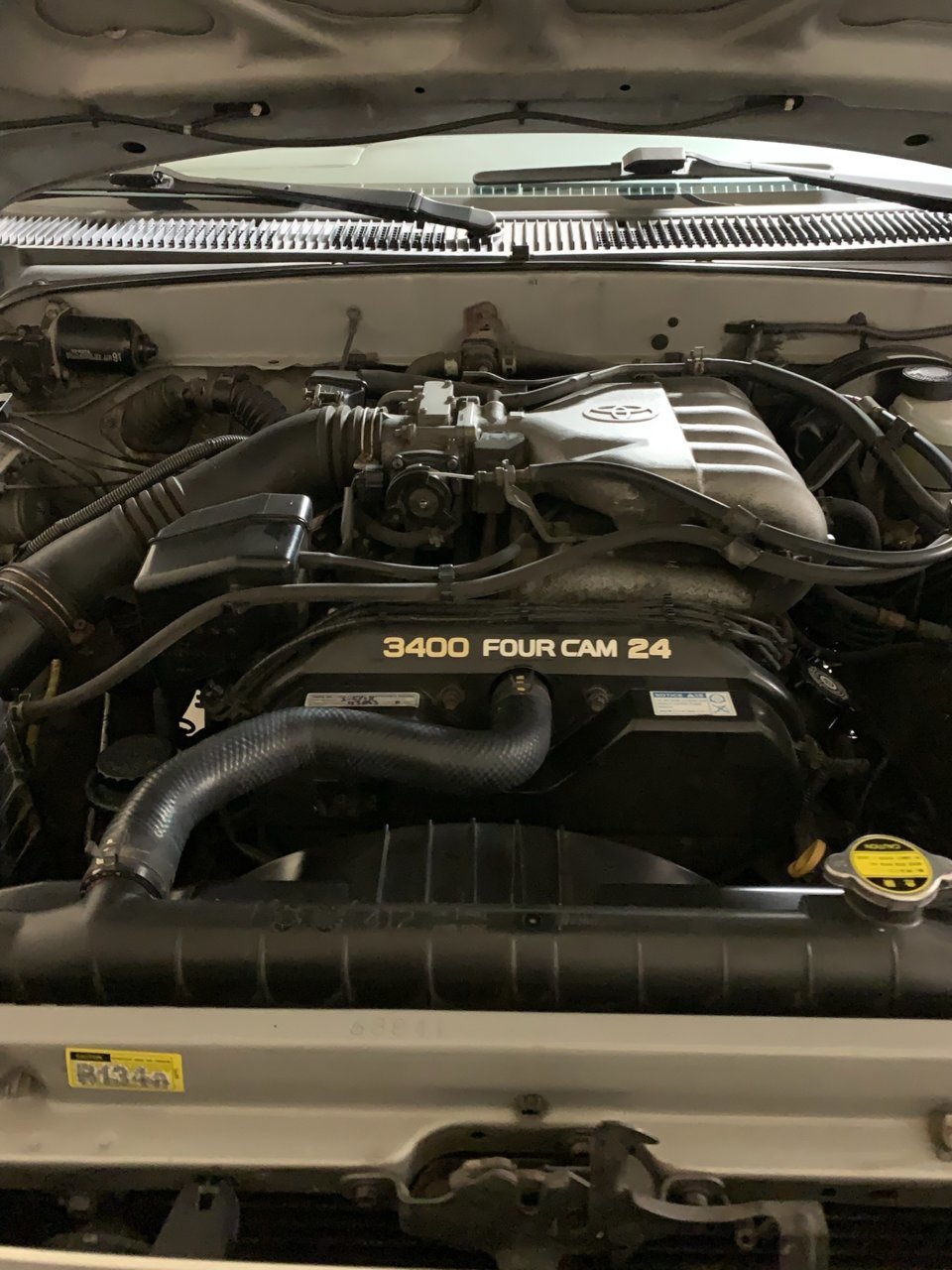

    Hello Friends, I'm a daily lurker on this site, and I have learned so much from you all.
    I was thinking about replacing my radiator, the top and bottom hoses, thermostat (jiggle valve down), and 3 gallons of Toyota (red) coolant.
    It's not leaking and has no issues, but it's a 20 years old. Im thinking its better to replace it now then have an issue in the road.
    Can someone please confirm if part number 16410-0C032 is the correct part.
    My Tacoma is an Xtracab, V6, Manual Transition, 4x4 TRD, SR5, 130K miles. I purchased it new in 2003.
    Thank you in advance, Pete in SA
    Everybody love pictures, so here ya go.
    695868735.jpg69586882911__9E722F44-8EDE-4978-A831-D2CE04BDC77A.HEIC.jpg 69586879263__B9866245-FC95-48C3-814C-B19140E98EE7.HEIC.jpg

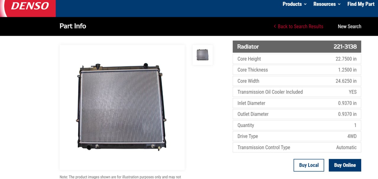

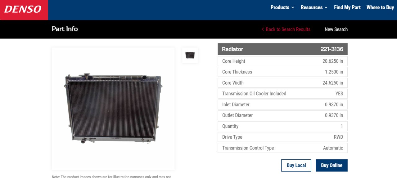

    Using Denso's "find my part" (can plug in your VIN their as well) -
    *Even though you have a 4WD, I'm including PreRunner as well for future searches. Also Denso does not have a MT option in their config choices.
    PreRunner 6cyl
    4WD, 6cyl -
    For reference, the original part#s were 164100c041 which was replaced with 164100c042

    Dude that engine bay looks clean. I wouldn't touch the radiator unless it's leaking.
    When was the timing belt last changed? The radiator hoses usually get changed as part of that process.
