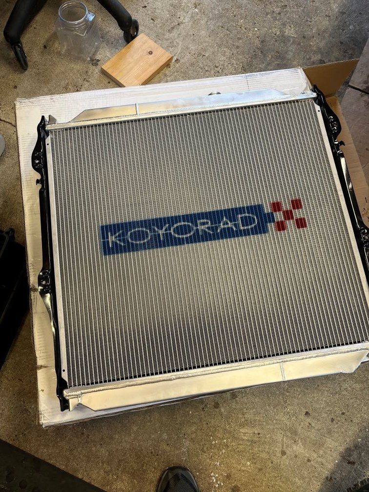

    Just went through this decision process on my 3rd gen 3RZ 4Runner, went with a Koyorad all aluminum radiator.
    Bonus was it does not have the internal trans cooler, which I don't need since mine is manual trans.
    Installing it this weekend, looks like a quality part. (also check out Timmy the Toolman's videos on aluminum radiators)

    Sure did, along with new Aisin WP/thermostat, fan clutch, etc. Figured do it all while I'm in there, replace all the OG parts.

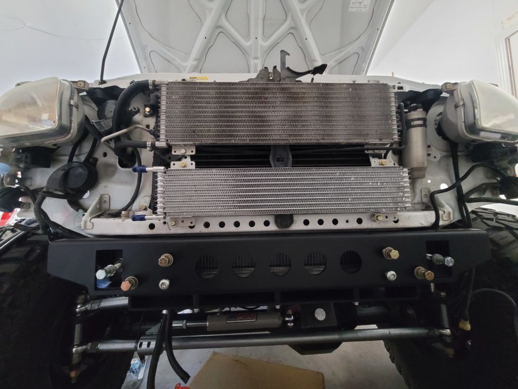

    auto will required an external cooler if you plan on running the koyo as they do not have built in cooler. I have the koyo with Toyota coolant without issue for several years now.
    See post #16
    picture: top is atf cooler and bottom is power steering cooler

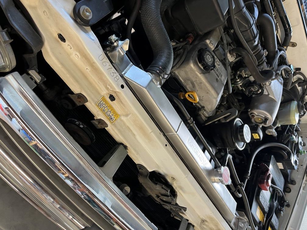

    Koyorad fit was very nice, got everything buttoned up today (note this was a 3rd gen 4Runner), definately gained some coolant capacity, prob a quart or two.
