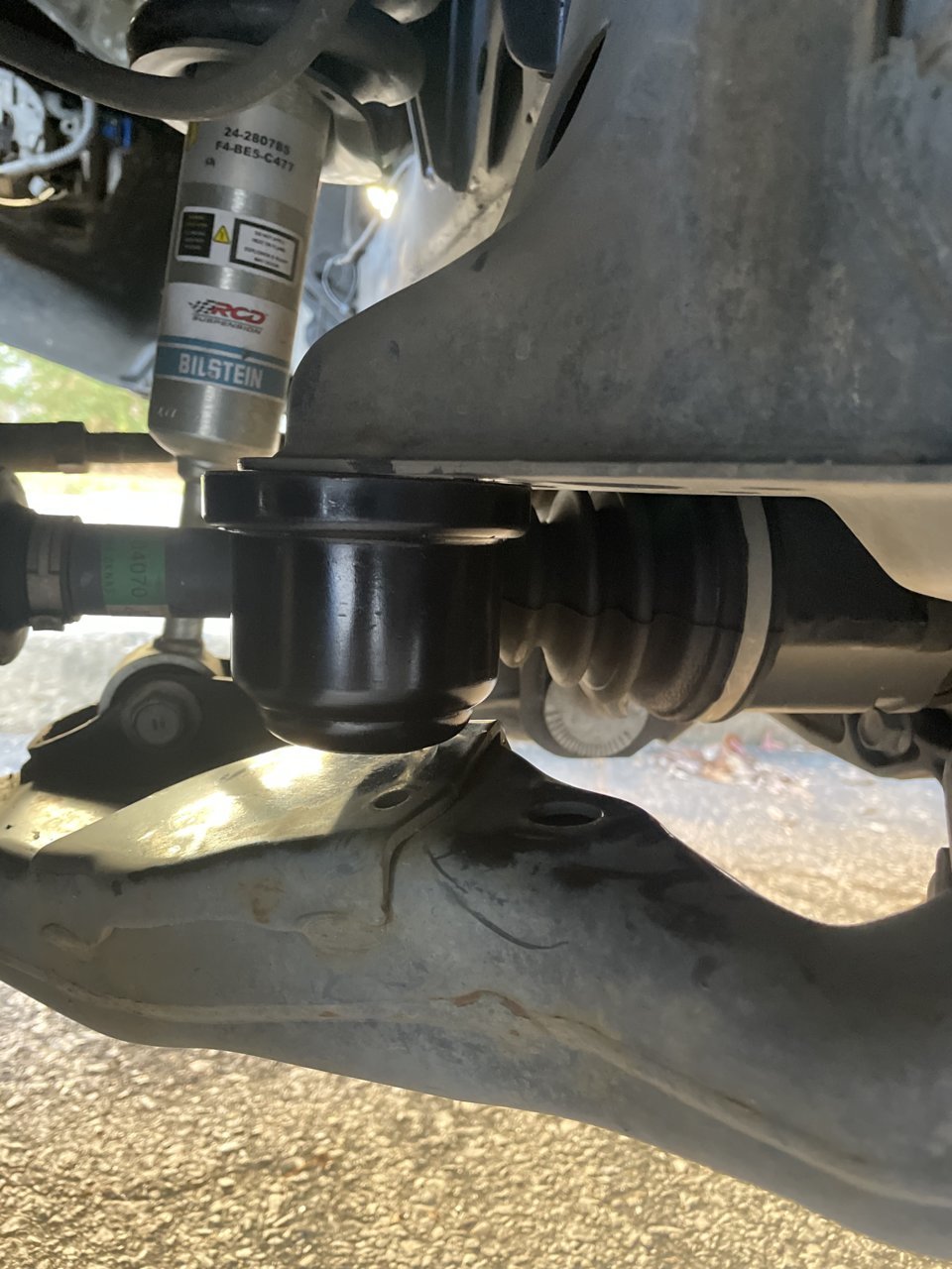

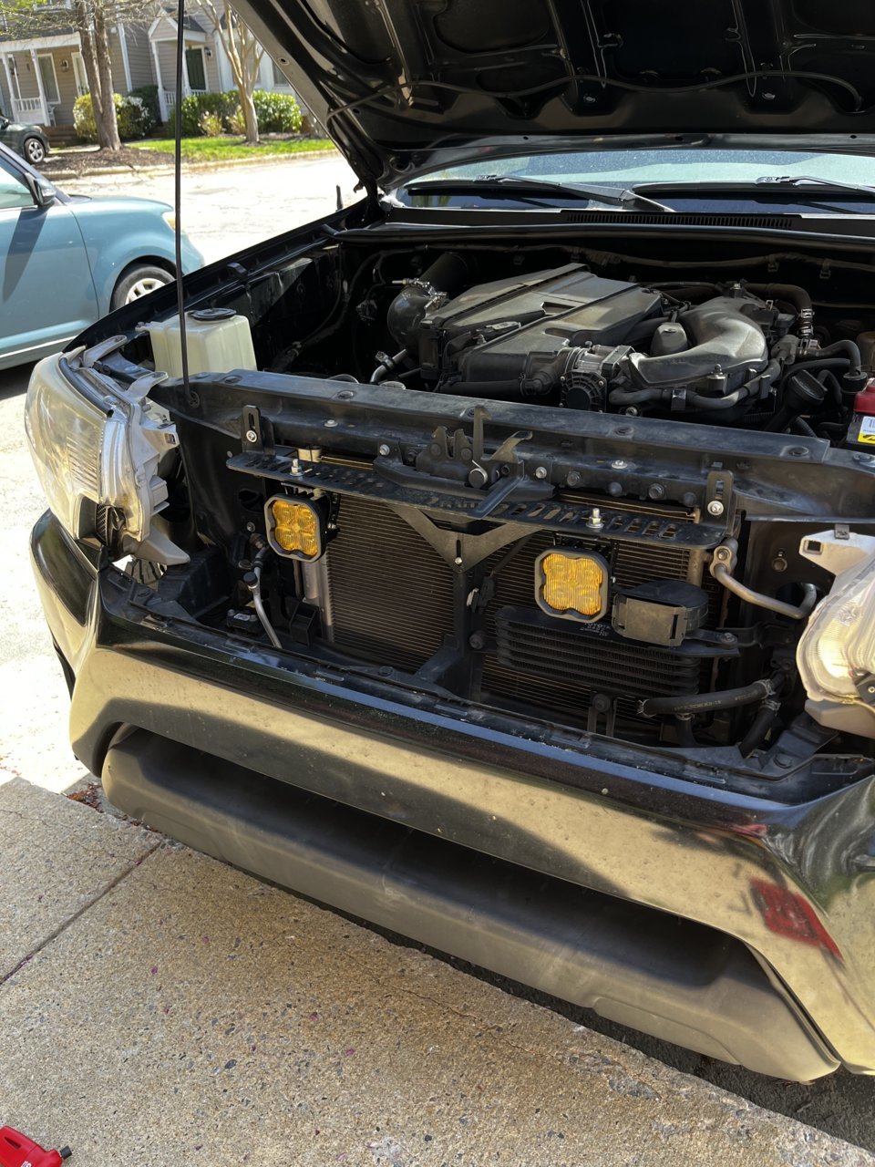

    Managed to sneak away and get a few small things done.
    front diff reinforcement from weldstaco is welded on. Buddy of mine wanted to tig it on and I said sure why not. Looks clean.
    Got some fog pattern Amber diode pros up behind the grill out of harms way since the stick fogs were no good anymore and it’s been a foggy few months.

    What’s the front diff reinforcement? I heard of the arms breaking on 4Runners but never in that spot on any Toyota.

    It’s easier to see if I could get a picture from the top which I can’t. It basically stops the rear diff mount from ripping out, swinging up and hitting the engine. Seen it happen a few times to other people now.

    Interesting, do you just cut a hole in the skid for it?

    As far as I’ve seen on other trucks it all clears with out cutting a regular skid.
