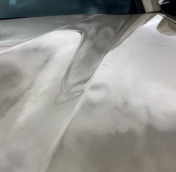

    Both of these statements are wholly inacurate.
    Dealer body shops are do what Toyota says is best for the vehicle.
    They are trained and certified by the manufacturer.
    Just because Jim Bobs body shop says they can fix something, doesn't mean it should be fixed. You could be compromising the integrity of the vehicle, affecting crash management, throwing off air bag timing etc.
    There are a lot of reasons parts need to be replaced instead of repaired, it has nothing to do with being a good bodyman or being able to work with metal.
    It's also not getting done for a couple hundred dollars. I've seen PDR guys work magic, but that ones probably not coming out all the way. Too many body lines, and that's if they can even get to it because the hood is reinforced. It can be repaired and the hood can be painted, but the fender will need to be blended because of how close the damage on the hood is to it.

    I wasn't talking about a $12k collision, but about the hood with a small dent. I'm pretty sure that dent isn't affecting the structural integrity of the hood, or the airbag. I've had quite a few MINOR dents repaired that a dealership wanted to replace the whole bumper, fender, or hood.
    I'm sure if he took that hood to a new car dealership body shop, most would recommend replacing the entire hood.

    I just noticed a similar dent on my hood:(

    And sometimes when you have small dents like that, auto body places just replace the hood since the metal is so thin, it is hard to fix those and easier to just replace, I worked for years in a shop and we would just replace them..

    The crease means it’s not a good candidate for PDR.

    perhaps not a good PDR guy...we have a local PDR guy and he works miracles. Posts lots of pictures of multiple sharp line creases with massive denting that's repaired to probably 95% or more. Ask around...
