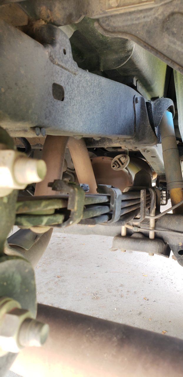

    2) Leaf Spring concerns
    - Should my leaf springs look flat/bent/curved over the rear axle? (I don't have a great picture of them, I'll get one when I take the rear wheel off)
    - I have been reading through threads about leaf spring packs needing to be replaced as well as ways to change them out. Mine don’t look anything like some of the ones that you can buy and replace.
    - I imagine the ones with more of a curve lift the back end up more - I don't want that, but I feel like the leafs are more bent than they should be?
    - If they look okay, can I lube or grease them? If so, how and with what?

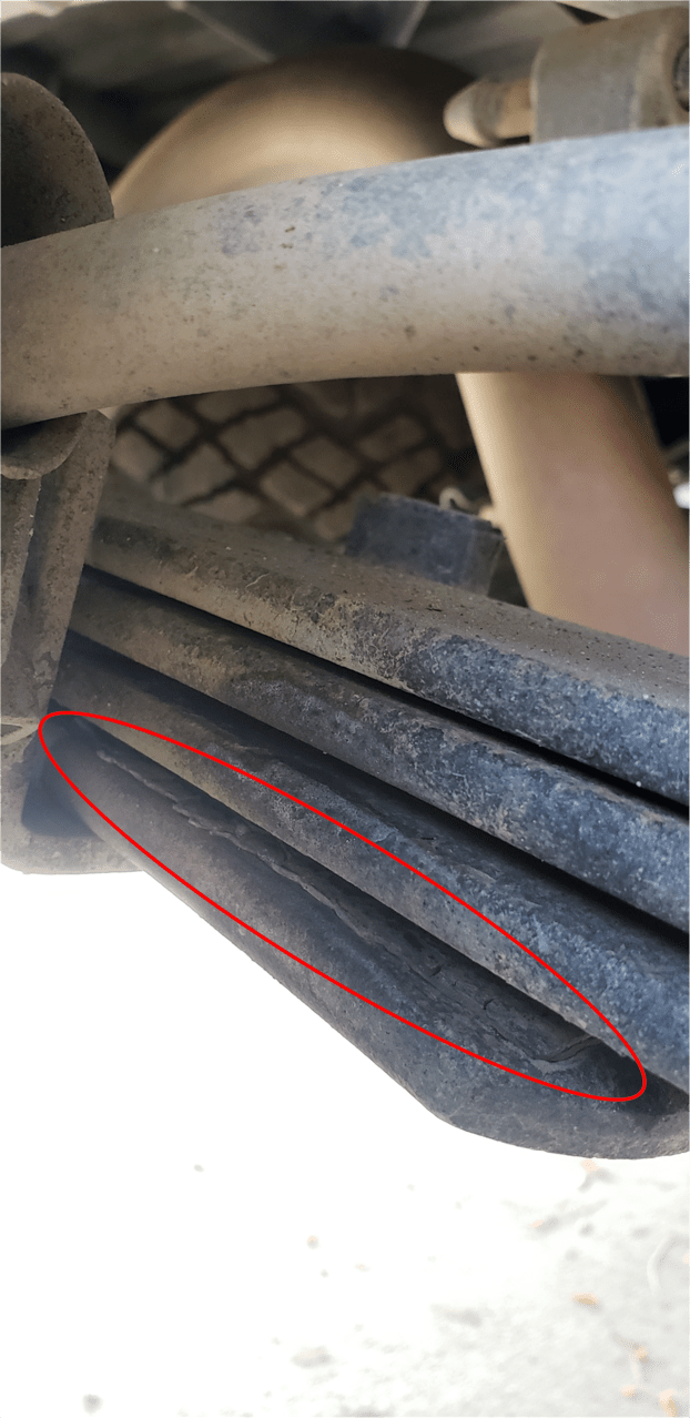

    - It looks like there is some kind of cushion between the leaf springs that looks like it’s falling apart - is that an indicator of something concerning?

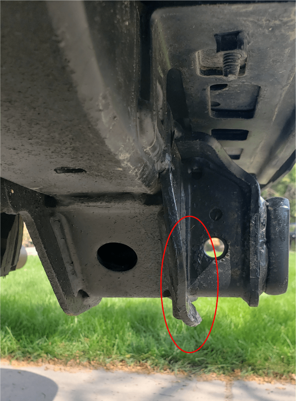

    4) Tow Hitch - should that be bent like that?

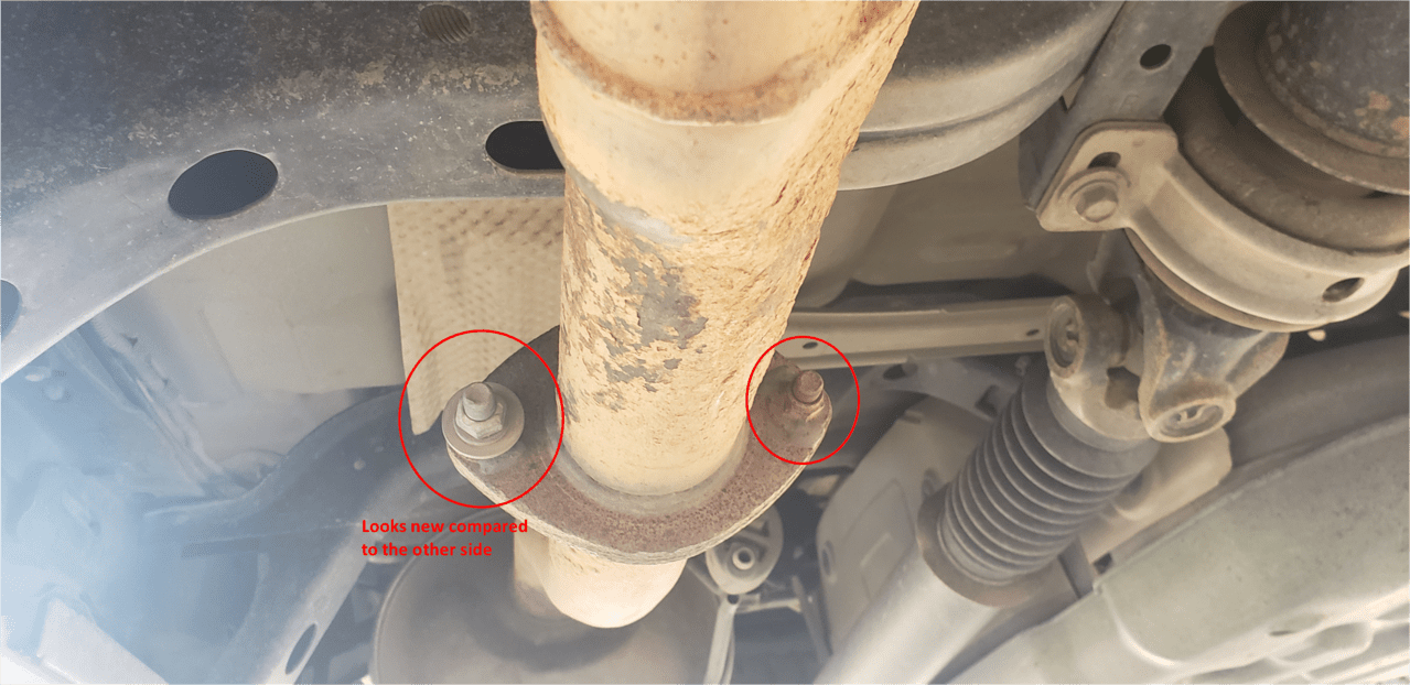

    - Exhaust Screw Replacement - It looks like one screw on the exhaust line connecting to the muffler has been replaced? Is that normal, or did the previous owner royally mess it up?​

    The leafs look a bit flat but could be normal. There may be a TSB for the rear leafs. There is for previous 2nd gens. The suspension seems normal after cleaning all the mud off and you say it has quieted down since cleaning. It should quiet down once the two metal parts rubbing find a happy medium. The hitch looks as if it was bashed on a rock. It's fine and should be safe to use as a hitch. Many of ours looks the same. The 'damaged' portion looks to be where you would connect the safety chains.
