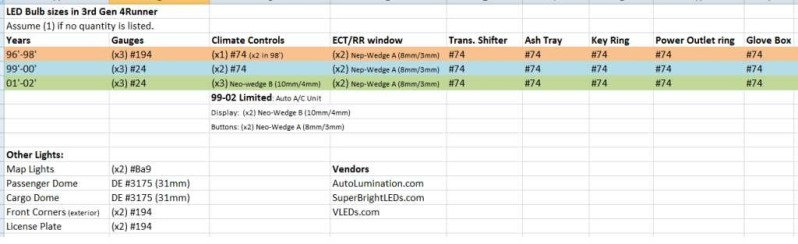

    Not sure what "us " 3rd gen 4Runners have? Is this something you can help us with? Or do we have light bulbs like first gen Tacos and have to get condoms? Thanks...
  19. Oct 31, 2013 at 11:56 AM
    #359
    yosh2000
    yosh2000 [OP] Well-Known Member
    Sep 18, 2007
    #2733
    2,936
    CO
    '17 Tundra CM 5.7
    you have bulbs and condoms. here is a sheet i found on t4r.org though.
    im looking at picking up a 3rd gen 4runner one day as well. already have the tundra springs for the front!

    Thanks Yosh! Although now I'm more confused?? That chart says "LED bulbs"?!?! No worries...I think I'm going to call someone a one of the outlets that sell these. They should know...I hope..lol!!
