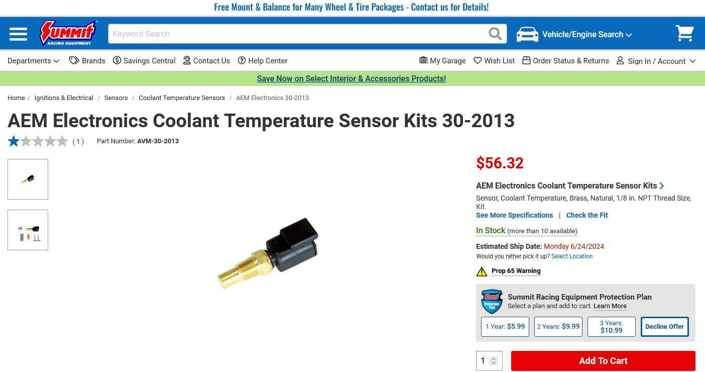

    If anyone hates the included temp sensor as much as me this is a much better replacement. I’m probably the only one with issue but I had the most trouble disconnected the stupid sensor included in the kit. I guess I damaged it because it stopped making a good connection.
    https://www.summitracing.com/parts/avm-30-2013
    This threads into the mishimoto adapter no problems, and it has a tab you can press to disconnect the sensor. You will have to make sure number 1 & 2 dip switched in the fan controller are in the down position with this sensor. No more fan going full bore randomly because of a bad connection :)

    Still running my kit with the original sensor has been working good for a couple of years now. In the beginning I was overheating found out the sensor was bad. Nice to have a 2nd option if needed Thanks!

    I had replaced that sensor as well. My biggest issue with it was the connector. I was too dumb to be able to easily remove it haha.
