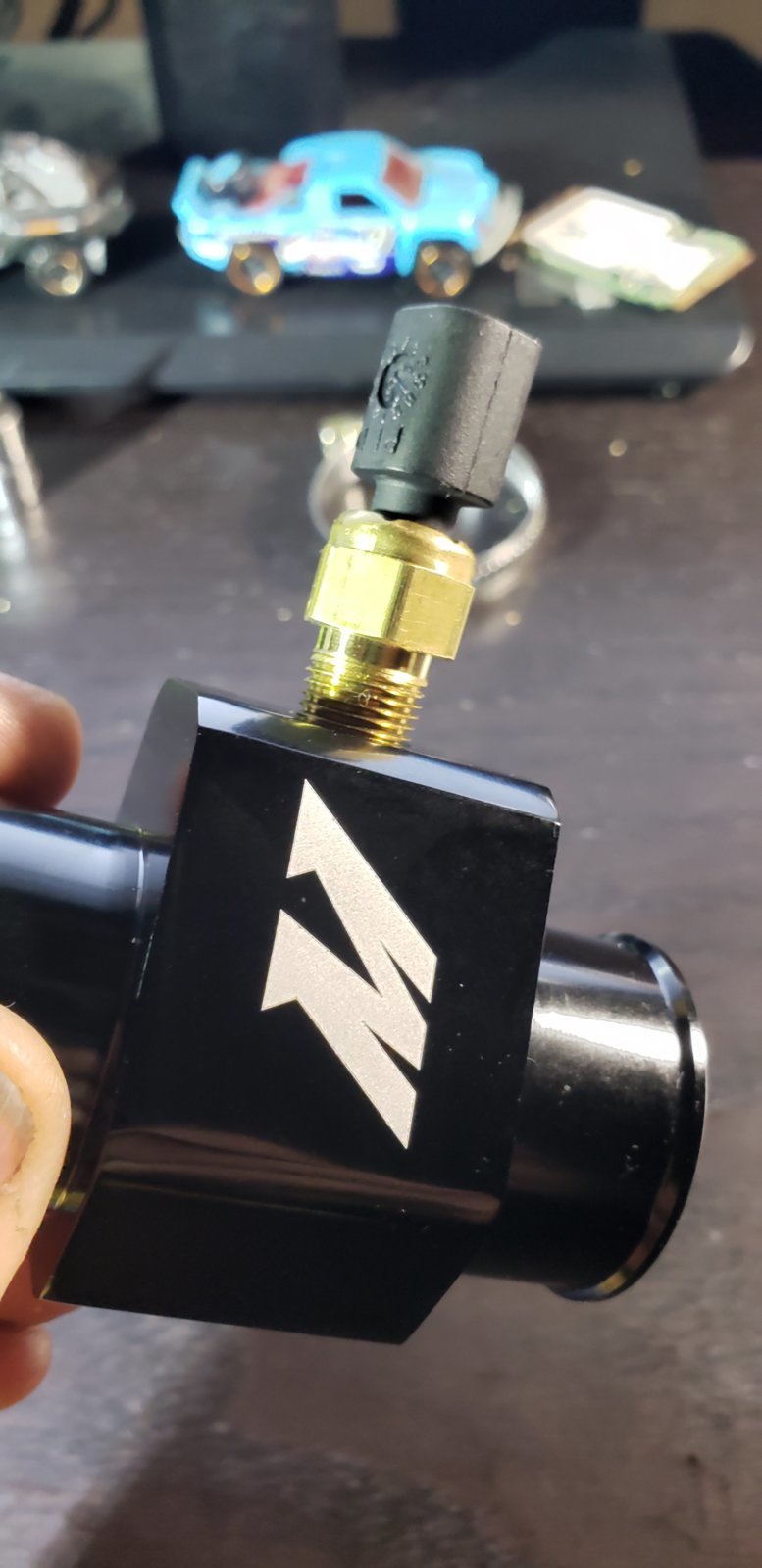

    My apologies I meant to say what temperature sensor housing are you buying? There are multiple different millimeters as far as the ones that fit in the upper radiator hose. To hold said sensor

    Ordered directly from Mishimoto
    TWTaco likes this.

    Is the sensor housing the 32mm? Do you have the part number?

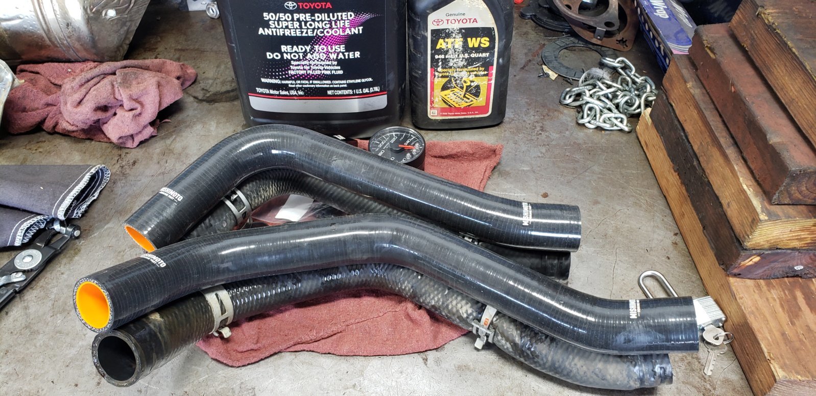

    Pretty sure it is, ill have to dig it up when I get home. I also got their Radiator and Silicone Hose kit at the same time
    TWTaco[QUOTED] likes this.

    jimbob2388 was asking about housing size.
    MonkeyProof[QUOTED] likes this.
