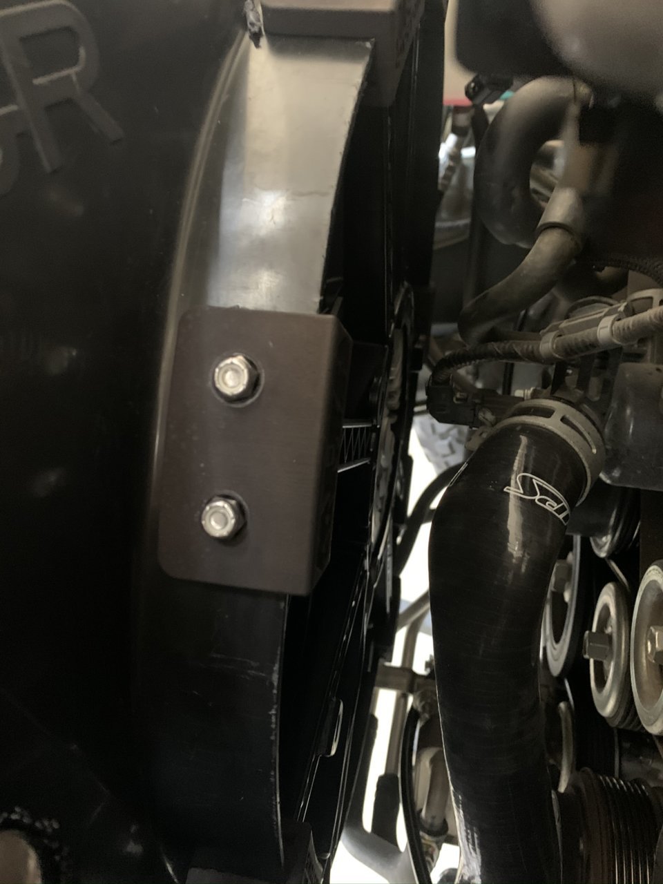

    hey guys. we have stuff on the way to start making these kit. the 3d printer is running 24hrs a day.

    598

    the 40% was a mistake by me from bad info at lingenfelter. the initial command is 15% and we set it low at 150 to it has movement as it heads up and to make sure the ac condenser always has air flow. this also gave us a nice stabilization temp of about 203 degrees which is right where you want it with a factory 186 degree thermostat. those running a 160 can choose to start it earlier if you want to stabilize lower.

    this is why we have the starting point set below the thermostat opening. this ensure the fan is already spinning bringing in cool air no matter what. you also want to stabilize you coolant just beyond the thermostat setting to ensure you dont have thermostat flutter or constant opening and closing. this can be bad for a thermostat.

    This fan really is a sweet bit o kit. Coming up on a week of daily driving. No issues. Sometimes I like to hit the bypass switch just to hear that sucker roar.

    Nice! Install was pretty easy? how did you run the bypass? MainLy curious as I have a ton of crap and ran out of easy spots to run wires
    Edit: n/m saw in your other post. I need to out my switch pro back in. Ha
