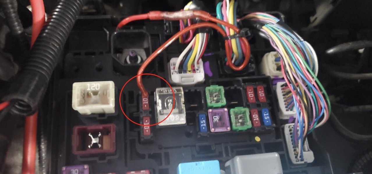

    Another question, can this red wire be connected to an aux fuse panel or does it need to be connected to the engine fuse panel as shown in your instructions? Sorry for the hassle...5FCD2A9A-6288-476F-8D7A-45D7BAF7E286.jpg

    The kit piggy backs off the 10A switched ignition fuse in the main fuse box. The key is the Lingenfelter needs to be powered off of a switched source.

    Thanks appreciate it :thumbsup:

    I am going to add a fuse to to the 7.5 power outlet above the one circled in red it is switched power supply. "NOT THE RED CIRCLED FUSE"

    I was going to run power inside cab fuse box but i already used all the fuse locations (with other add a fuse's)!So i have been trying to run the power wire into the engine bay fuse box no luck! Going to drill very small hole into the side of the lid and just seal it up good!Should be ok other then it may look like crap!

    Tried to force the wire in this spot but its not going thru.( RED ARROW)

    If you unscrew that bolt right below the circle with the arrow in your photo and release the locking tab, that plastic part that holds the wire comes right off (just pull up after releasing the tab). Then you just remove the tape add your wire, re-tape and slide it back into place. If you want pics go to the magnuson website and view the charger install procedure. It shows this in detail on page 42 and 43.
    Here’s the link: https://www.magnusonsuperchargers.c...es/manuals/89-89-35-001_Rev.F_3.5L_Tacoma.pdf
    It’s a little more work, but at least you won’t have a hole with a wire sticking out from the side of the box.

    Nice thanks ! I was going to try and remove that nut and see if it would give enough to get the wire thru.
