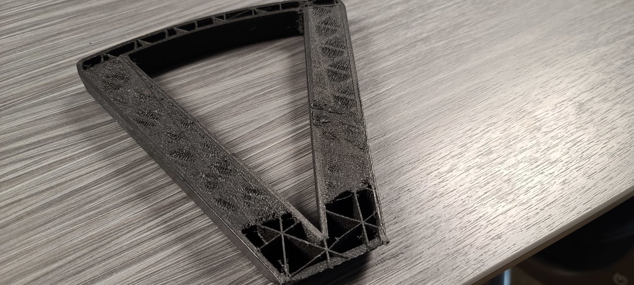

    Here is a failed print to show the internal structure of the part. I can't even break this one and a big dude

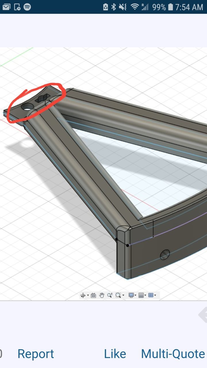

    It's not the overall structure that concerns me. It's the mounting tangs on the inside that I'm referring to that bolts to the fan assemblies single studs. If you take one of those arns and mount it to the fan you should try and see how much force it takes to snap the mounting tangs off. Once they are hot as well, because you know they will get hot they may become more pliable and more easily influenced to bending or breakage and up and down jarring motions which comes inherent to wheeling.

    Take a look at the area which I'm referring to.

    Well I can't break that tab by hand. Or in a vice without a hammer. The tab is solid piece no internal structure.

    That was my also as when I initially had it set up on the shroud there was deflection in both directions that the fan assy could move. Utilizing the gm fan mount there was zero deflection, overall still happy with the OP’s product.

    That's comforting to know actually. To improve on the setup I would recommend you use something to unify the 3 pieces to give it more structural rigidity. That's at least, what I recommend. If you do wind up doing something like that please keep the myself and the initial group buy guys updated. I like the MESO setup, and I like the integration your set up has. Definitely a lot of quality, it just leaves us to some worry on how well it would stand up to abuse like wheeling over time.
