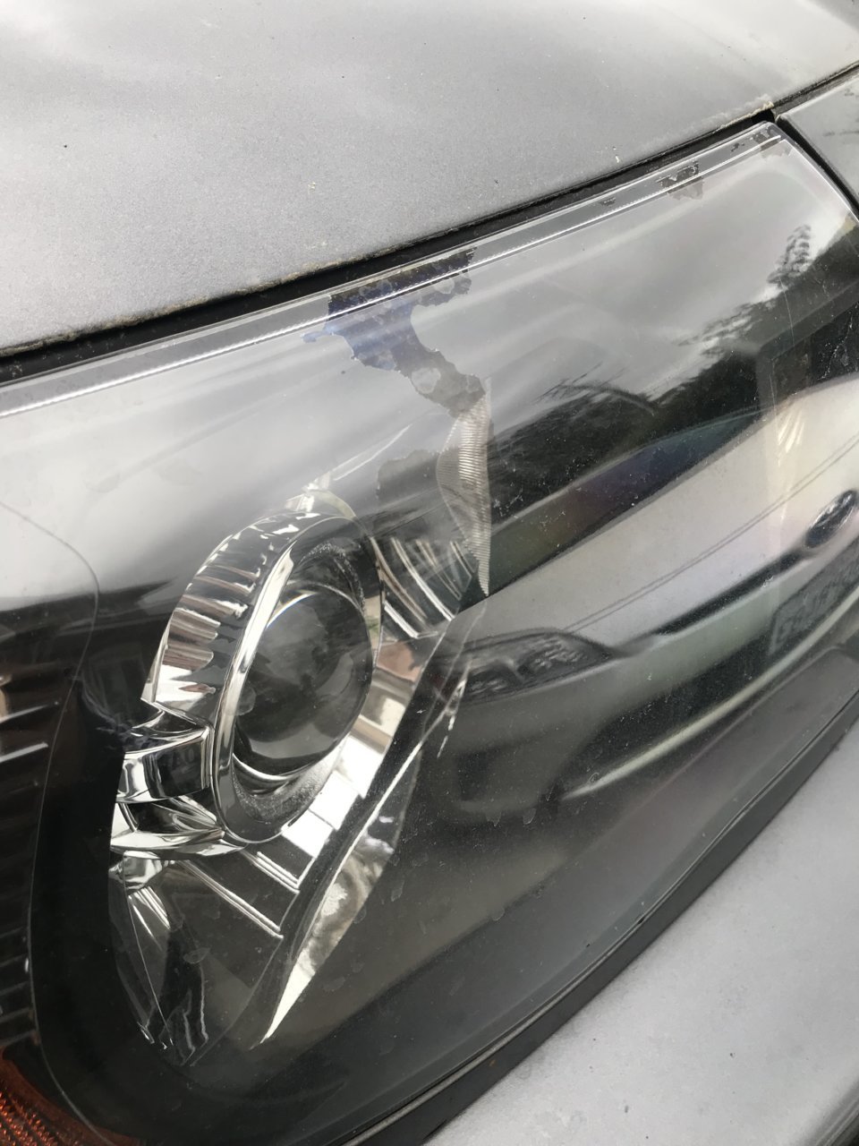

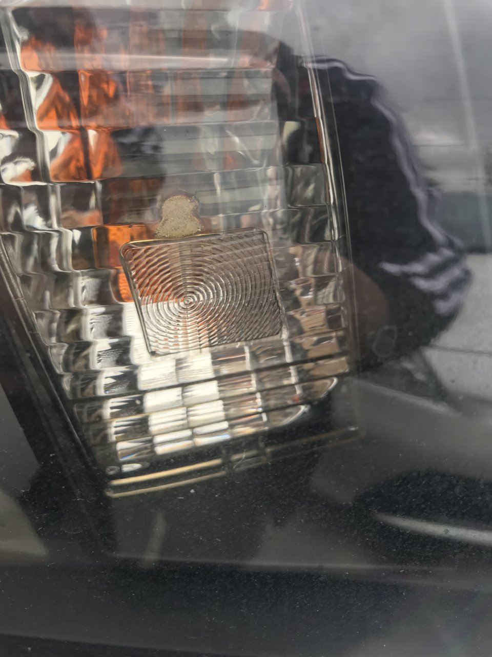

  4. Apr 16, 2019 at 11:44 AM
    iRepLONGBEACH
    iRepLONGBEACH SoCal Reppin
    Mar 7, 2011
    #52506
    781
    SoCal
    10 MgM dcsb TRD Sport
    I would suggest using OEM housing. Less than 2 years old, my depo’s clear coat is peeling and dtrl lense starting to melt..57002BC6-CB0A-4D6A-84A4-8A8579FE4862.jpg77966CD3-EE65-40BA-A0E5-1CAC62B423FE.jpg
