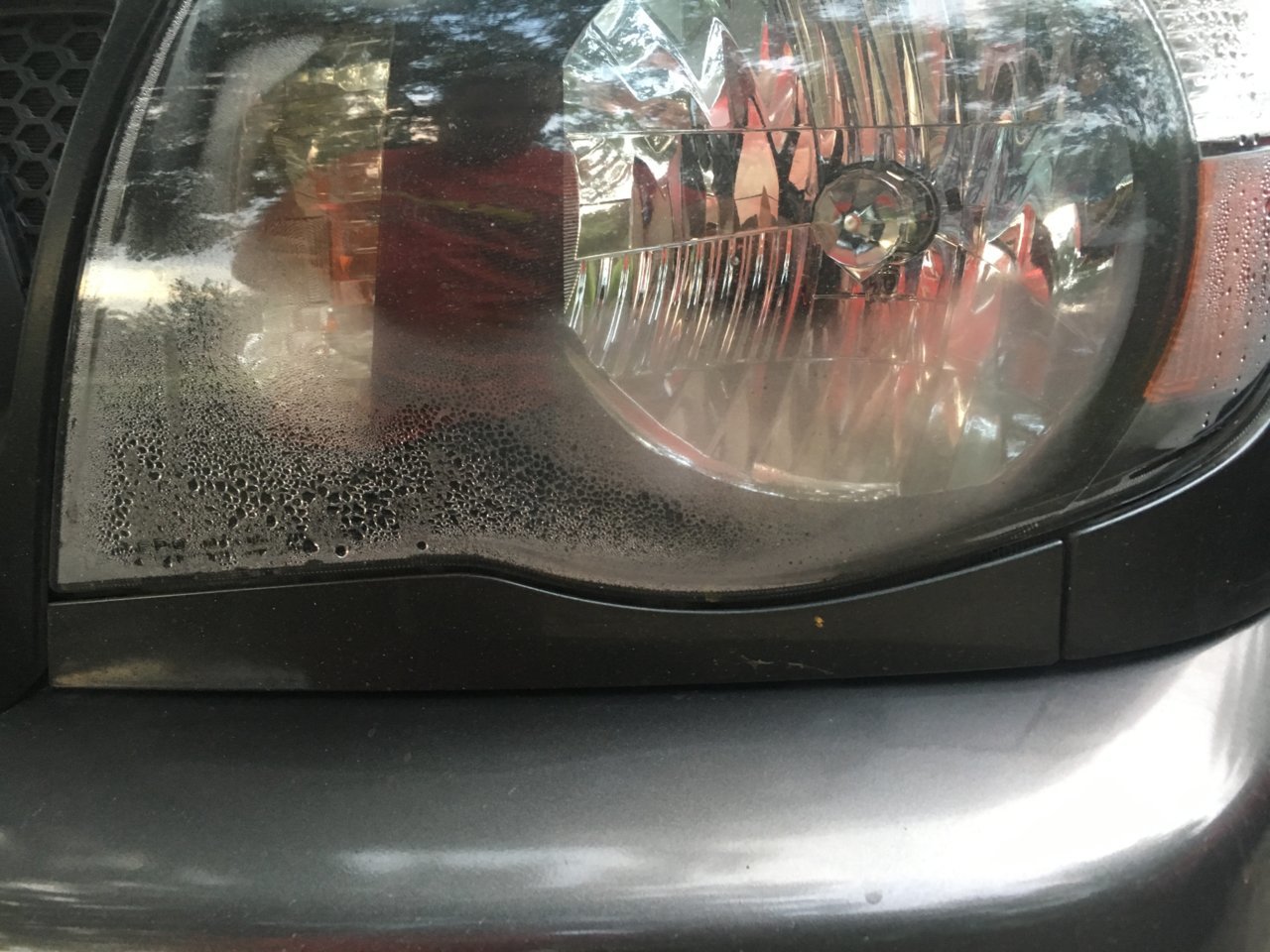

    Reporting back that having my lights now for about a year and they've started to condensate with the high humidity we've had here in Central Texas the last couple of weeks. I sealed mine before install so a little dissapointed. I'm OCD about this kind of stuff, so I'll probably go with another brand here very soon. I might even go with a projector housing this time around (maybe).

    That's Not a bad idea; I might give this a shot to hold me over. Here is how it looks this evening. I drove home (45+ mins in traffic) with my headlights on attempting to dry them out.

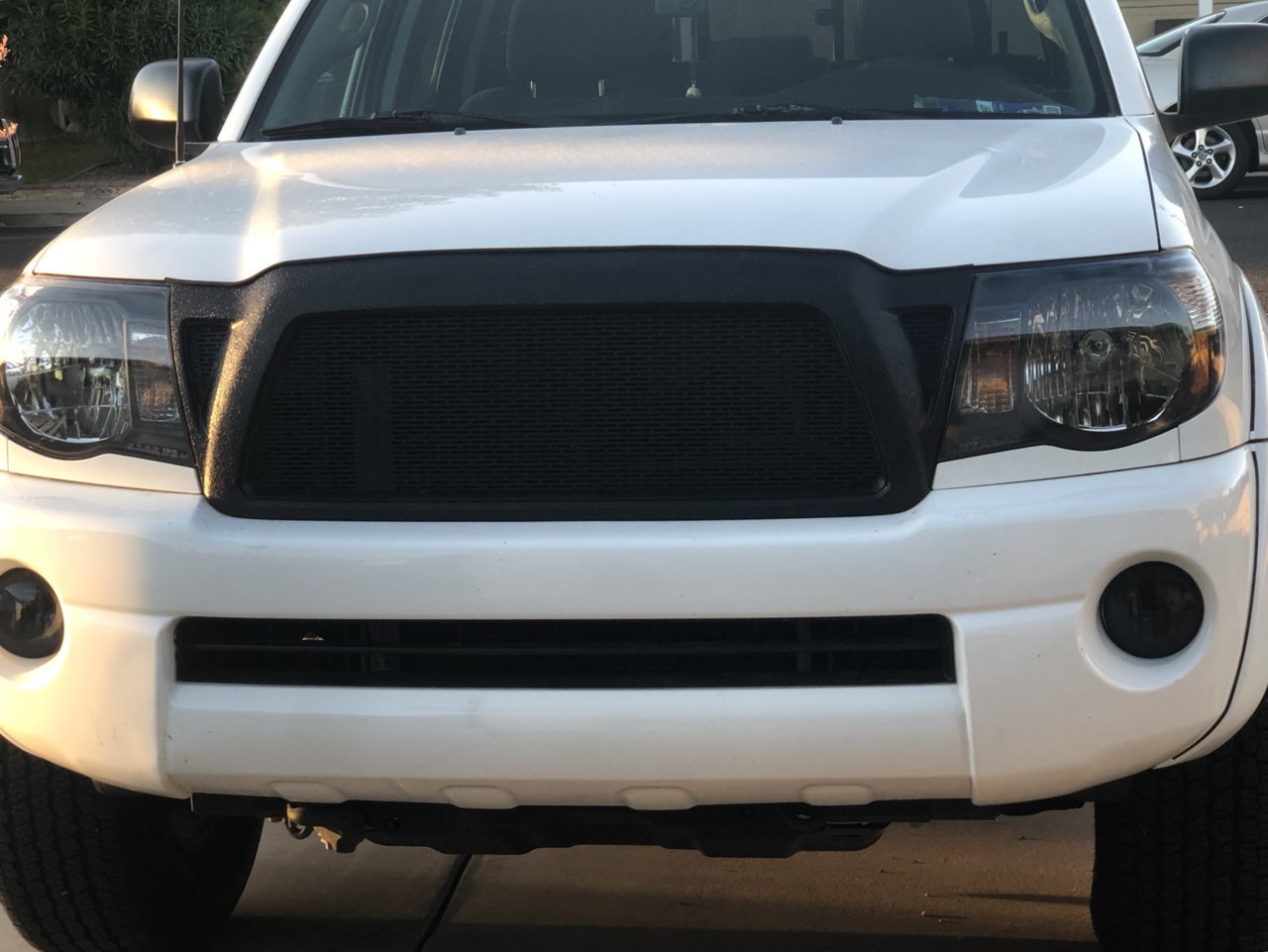

    i just installed a set. didn’t reseal because i live in az, so i’m hoping i’ll be fine. but i did reuse the oem connectors, thinking they might seal better?
    one thing i see often is people trying to use silicone and other types of sealants on these. wrong. the correct way to reseal lights would be to bake them, pull apart, apply morimoto butyl rubber and seal back up. silicon and other products will not form a permanent, water right bond.
