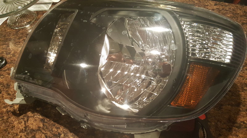

    I believe so, I had no issues at all prior to going through the automated car wash. The next day I was walking back out to my truck and the drivers headlight was full of condensation. I done some research and have it in the oven at the moment set at 170 and it's 99% dried out but now I have some water spots. o_O

    This is what we have thus far. Note: The water spots developed when I was using the fan outside (40* and sunny today) not while baking.

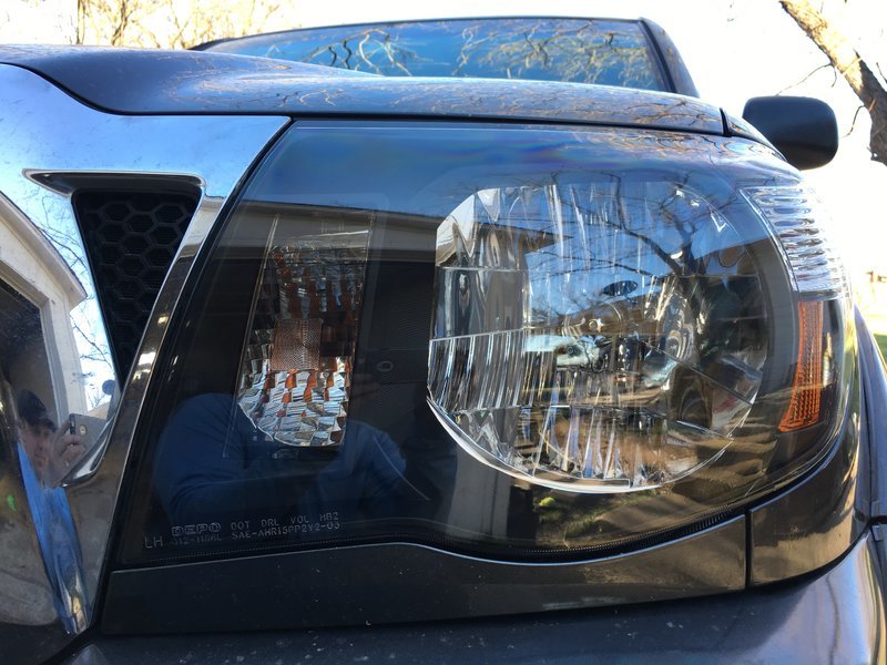

    Just installed a set of these last weekend and added a bead of silicone all along the housing and where the lense connects. Spent about 30 mins on each one making sure I filled in all the gaps. I also glass multi coated the lenses with a product from Dr. Beasley's coatings so hoping this keeps them fresh for a long time.
    Overall I'm very satisfied with the light output after aiming them. They were really high out of the box. The black housings match my truck's color theme (magnetic grey and black).
