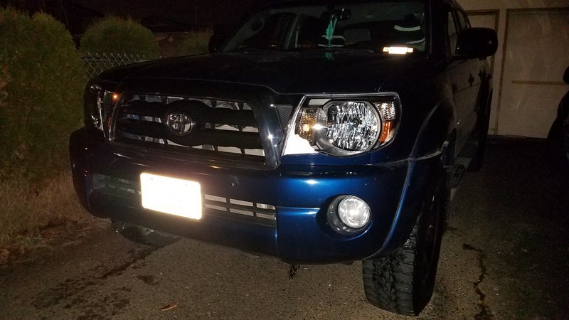

    Got mine installed tonight as well.20170222_231226.jpgNotice the immediate fogging in the bottom left. Not even one full night, and already having issues, on a clear night. Liking the new look though, haha.

    Did you seal them with silicone like everyone has been saying?

    Yes. But not all the way around. I felt like i missed a spot, so that must be it. I'll get a bunch of silica to fix it.

    And for anyone wondering, mine haven't fogged YET. They've been great thus far. I really hit it hard with the silicone though making sure to fill EVERY SINGLE SPOT even if it looked sealed already.

    For those with fogging, pull the rubber boots on the bulbs and slip two or three silica packets into the housing behind the reflectors. That should help.

    Make sure all the moisture is out first.

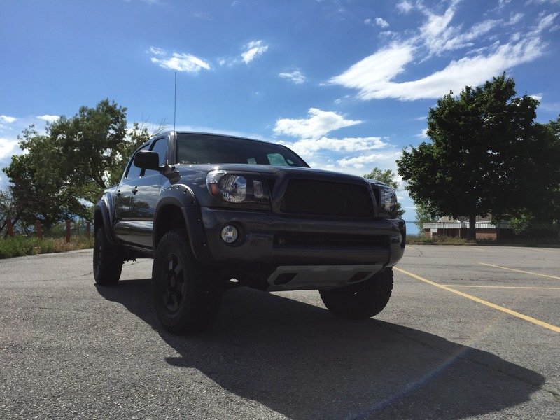

    I've had the Depo lights for almost three years now. I sealed them with silicone when I first got them, and I make sure to wax and seal them properly with every detail. They have been coated with Optimum Opti-Seal twice a year since I've had them.
    The first thing I noticed after installation is the light output was somewhat reduced compared to OEM, attributed most likely to the reflector design but expected of an aftermarket headlight. After about a year the UV lense coating started coming off. At a year and a half they started getting condensation on them (no condensation issues otherwise up to that point), and a reseal with silicone has since fixed the issue. Within the past year the lenses have begun to yellow. I also noticed that the bezel inside the light on the passenger side seems to be a little loose, it will rattle around slightly but not enough for me to bother with.
    That being said, unless I find a pair of OEM lights (to do BHLM and retrofit on) in excellent condition locally, I'll most likely purchase these lights again. I feel for the money and a couple of mods before install make these a decent purchase. The mods I would recommend doing are to seal very thoroughly with silicone (or something more durable if it exists, silicone tends to "dry out" in my climate which is what lead to condensation in the lights over time) and then cover with Xpel or similar clear bra material prior to installation which should help mitigate the degradation of the lenses over time.
    These are the older models that had the orange reflector that appears to have since been changed over to clear;
    308AA083-249D-463C-838F-53EB745F4007_zps_b4e5f548abe41ec0703ffa34a5726ec922a71ee4.jpg
    Hope this helps!
