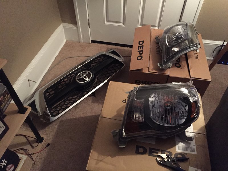

    Silicone applied and bout to put all this on my 2008 at once. Really gonna refresh the front end for sure

    I installed mine after letting the silicone cure for about 20 hours. It's pretty humid outside right now and they've done well over the past 6 hours. Still in the process of getting them aimed. Anyone know which way points the lights left and right? I know how to adjust vertically, but I'm not sure about horizontally.

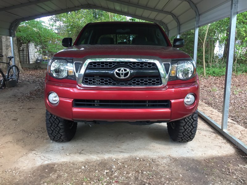

    Here's a daytime pic. I like it

    ‘13 SUPERCHARGED DCLB TRD SPORT
    I've always loved that grill!

    Looks great.

    Happy to report back that the lights have not fogged up at all after two very humid days and nights. Sealing them with silicone is definitely a must

    Awesome. I detailed the Tacoma yesterday using my pressure washer to knock down the initial dirt layer and followed up with a snow foam bath. Still no leaks so I too am confident the silicone bead around the headlights has made a difference. Very much enjoy the look of these lights and the light output after being aimed is excellent.
