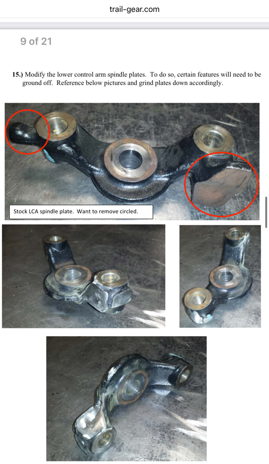

    Ok so has anyone used the supplied spindle gussets. If so, can y'all post a picture of how they look on the spindle . debating on just ordering a set or using the applied ones? :popcorn:
    Also no pictures of the gussets on the site

    I think they work fine. They're dimensionally the same. I got mine from Toyo steering so I know mine can still use the sway bar. Even though I haven't put it back on yet

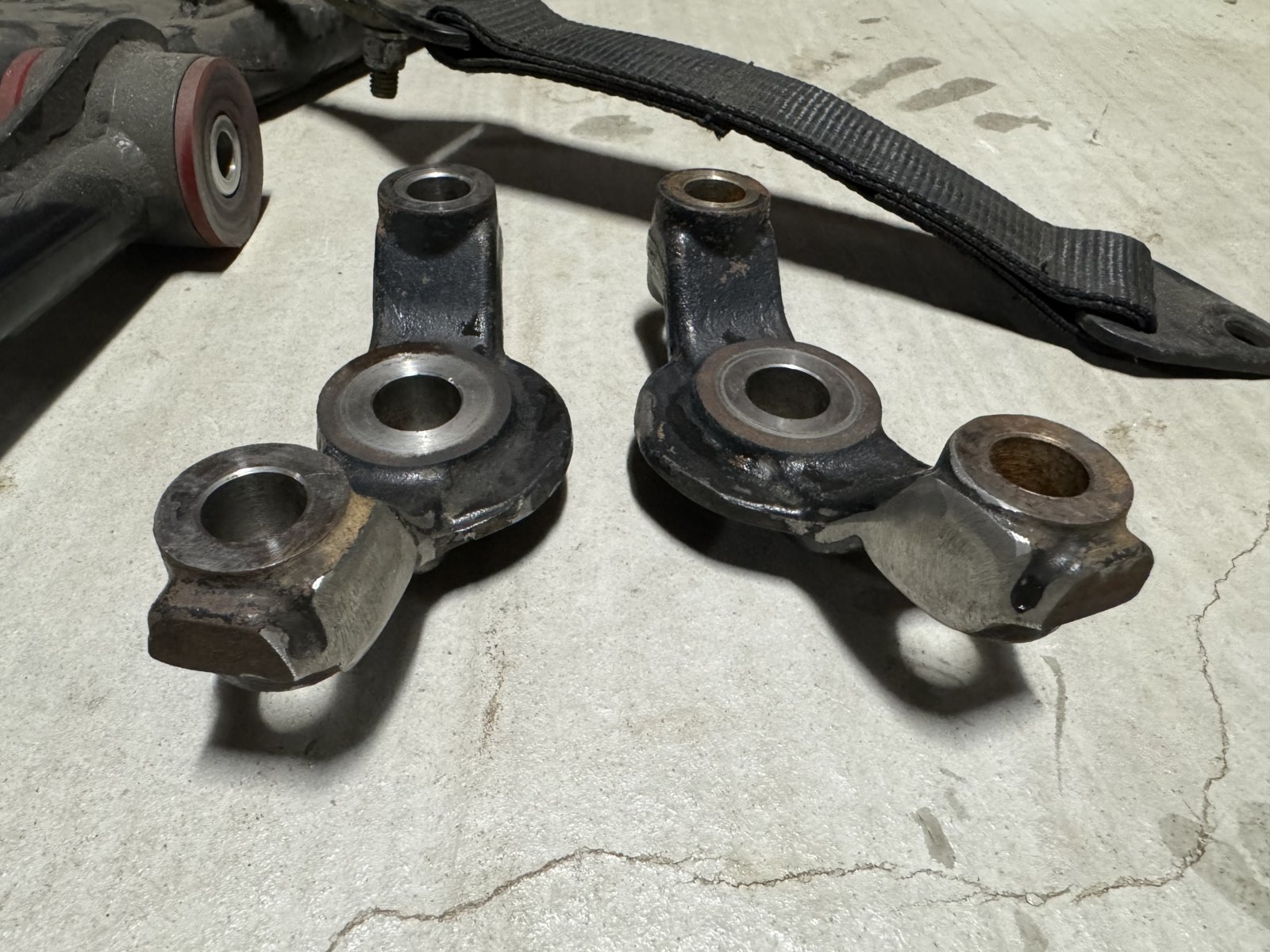

    Picked up a spare set while I wait on shocks. Think I trimmed enough?

    Yes

    I'm assuming you need to do that for the turning radius ? Also curious on why you would need to do that?

    yes turning radius and also its part of instructions.

    As @Brian422 said, I'm following the directions.
    ... but I bought these off a parts truck, so I have my originals if I need to go back for some reason.

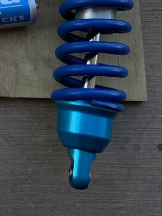

    Do we know which King rod end/eye is required to clear the CV?
    It looks like these are too small, but will 2” clear? Or is 3” required?

    that rod end too small.
