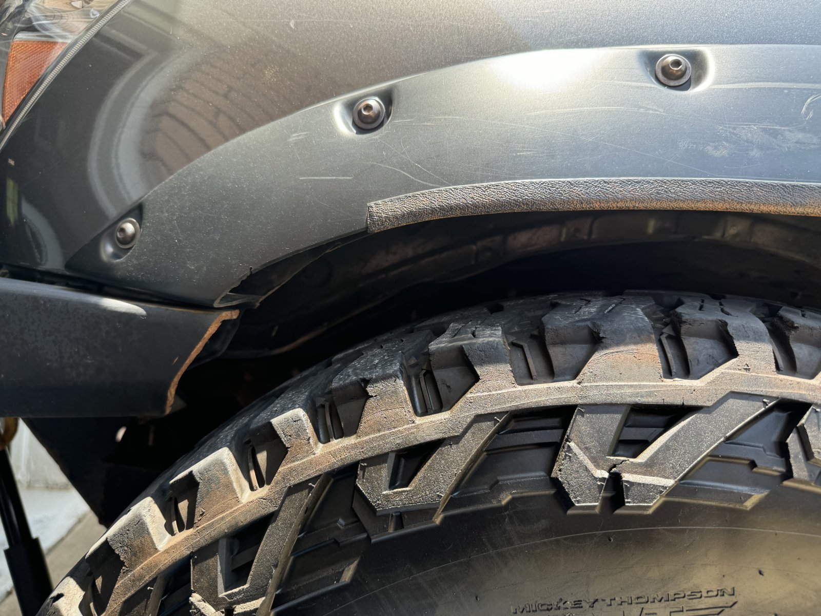

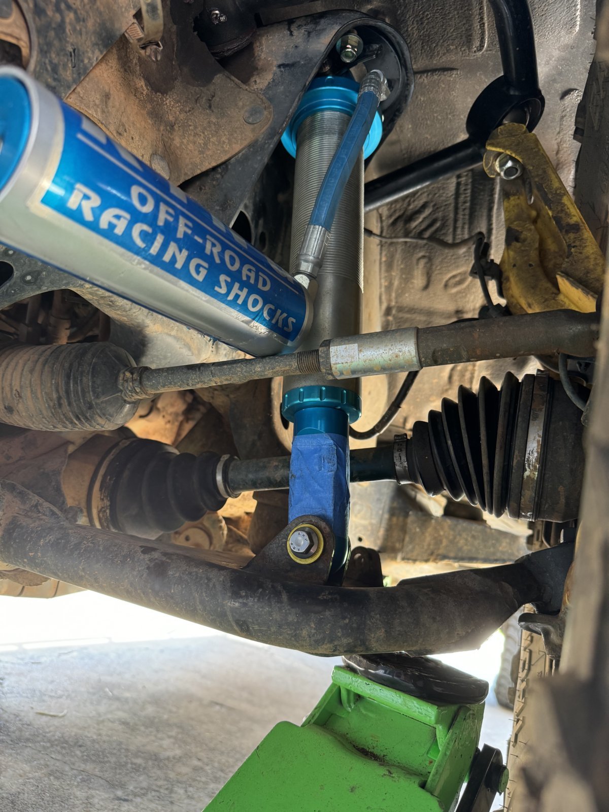

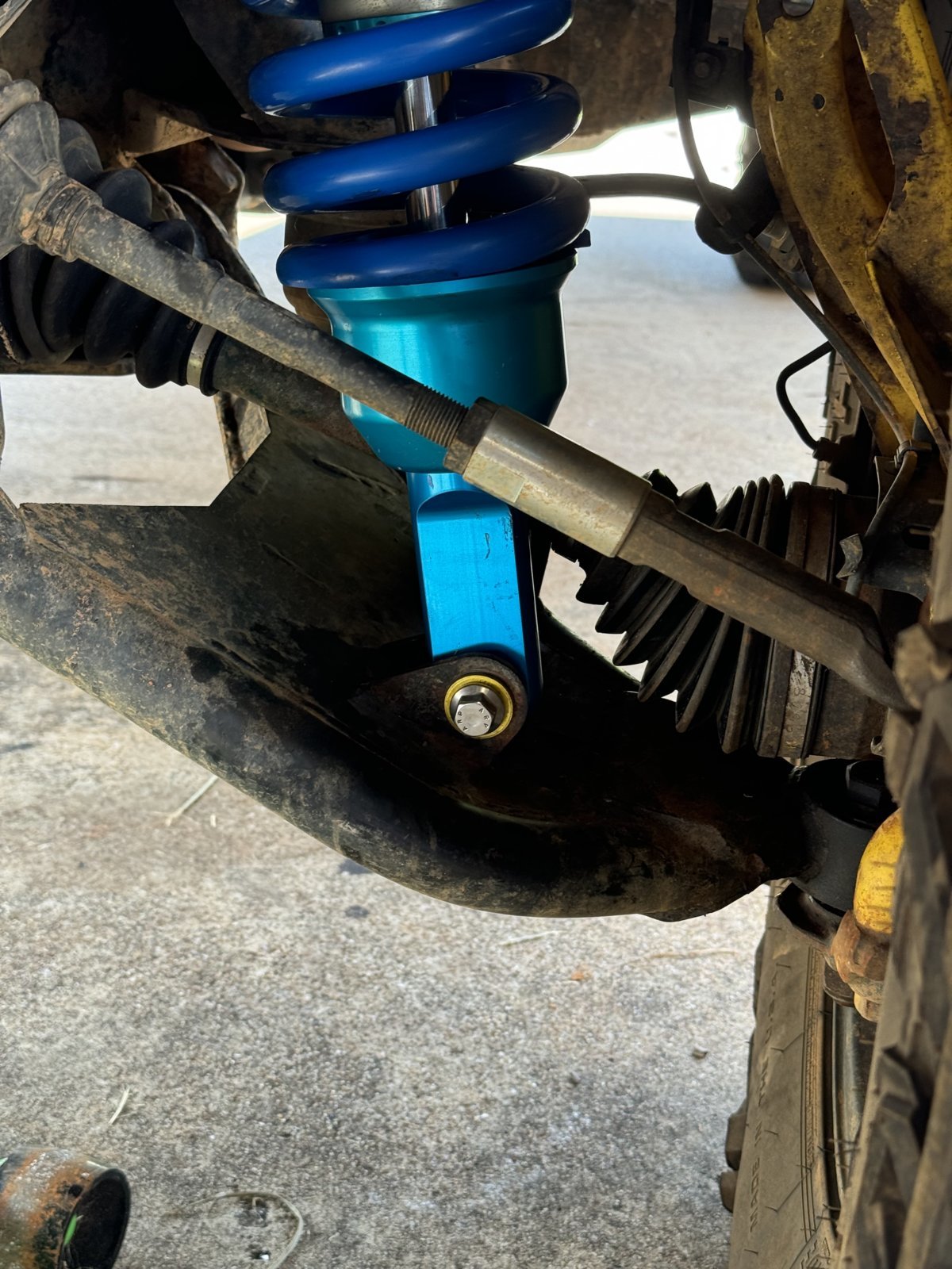

    And after a long Sunday of mock ups, measuring, and assembly I finally got my shocks installed.
    looks like I need to go 37’s based on the wheel well.
    Fender, flare, and bumper all trimmed obviously, but I’m surprised not to be hitting the inner fender/headlight bucket.
    The rod end is the required length to clear CV shaft. This is the +2” rod end I inquired about a few posts/months ago. KRS-25005-003
    I currently have the “tall” spring perch. I don’t love it, and I’ll buy the shorter one to see if it fits/reduces preload on the spring.
    I’m at ~.25” preload on each shock and I’m still surprised with how high the truck is sitting. Don’t love it. Hopefully the springs will settle a little bit? Or the spring perch will help lower it.
