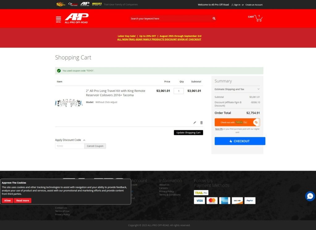

    Yet again the all pro kit is on sale. discount code "toyo" still works too Screenshot_29-8-2024_21811_allprooffroad.com.jpg

    Damn with shocks? No brainer lol
