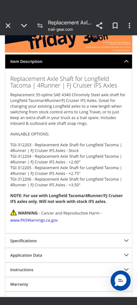

    Got my depo +2 kit yesterday
    Got +2 shafts from trail gear super cheap (104.00)

    Those +2 axle shaft you got from them won't work with stock CV inner or outer . You need the long field ones . You might want to read the part that says NOTEScreenshot_20241201-155736.png

    Thank you for the save. Returning the shafts and ordering full sets. Even better I'm only going to carry a spare shaft instead of an entire CV axle.
