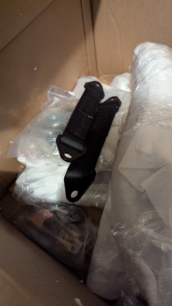

    My kit came in yesterday and I'll unpack everything tonight . Also, are there any instructions that are supposed to be with this? Not that I need them, just curiousPXL_20250114_230508845.jpg PXL_20250114_230515111.jpg PXL_20250114_230529935.jpg

    Almost lost mine when my limit strap weld gave out. Extended barely feels
    clicked on 03-09 4Runner instructions and AP still gives this. DR doesn’t send instructions. Do yourself a solid and test fit each of your zirk fittings to the uca/lca holes before you start. Way Easier to tap before install. Good luck

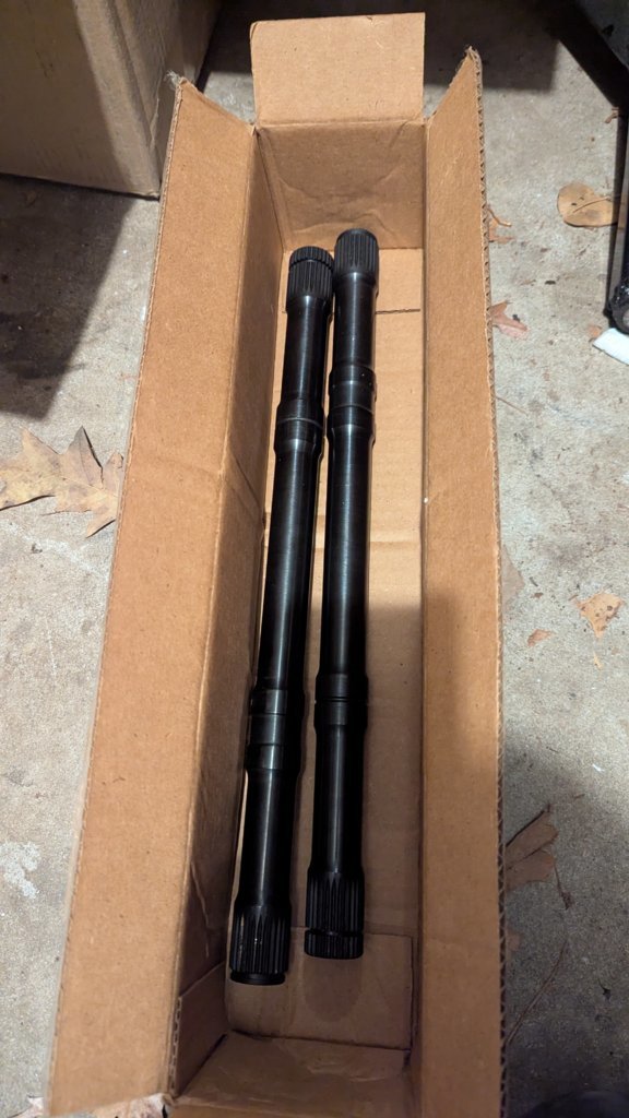

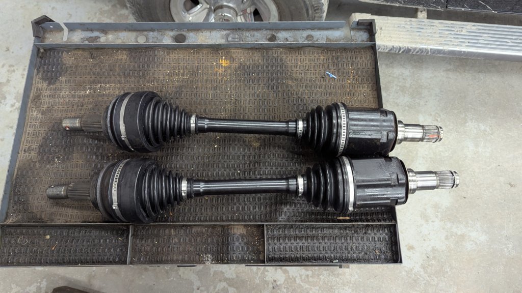

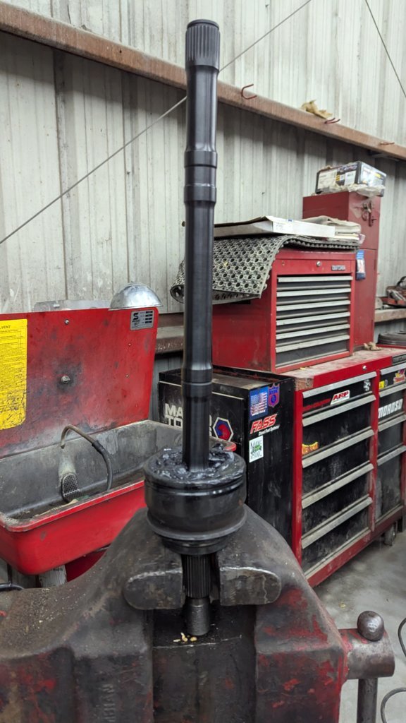

    Finally got the CV Boot kit in yesterday and assembled the CVS this morning PXL_20250129_111910948.jpg PXL_20250129_113529826.jpg PXL_20250129_114030429.jpg
