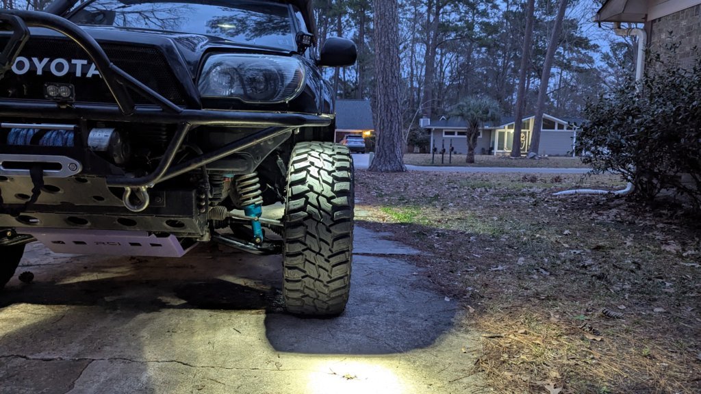

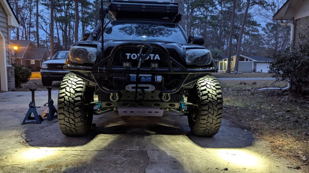

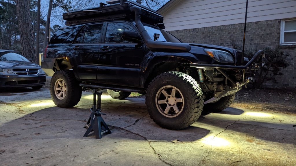

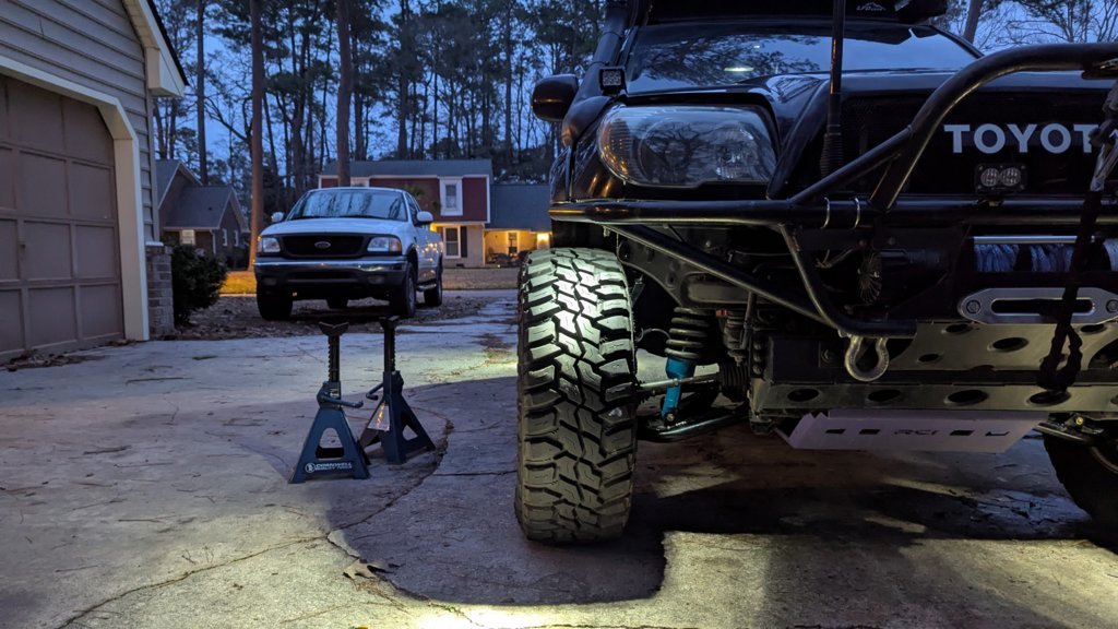

    Well the new tie rods came in yesterday.
    No thanks to racing depo for fixing there fuck up and trying to make things right but either way. Here it is . getting it towed to my shop so I can tweak on the coilovers some and do the alignment. PXL_20250218_231205378.jpg PXL_20250218_231212792.jpg PXL_20250218_232157200.jpg PXL_20250218_232206144.jpg PXL_20250218_232214659.jpg PXL_20250218_232301126.jpg PXL_20250218_232310243.jpg

    So since I have everything on now . I noticed that they are binding before I even get to full drop so they are my limiting factor as of now . Have you noticed that on yours

    I finally got bigger tires 2020 Long Travel Tacoma 1997 MAGNUM
    My limiting factor are my CV's. So no, I have not experienced that

    Build thread in sig... 4-link long travel
    You have any photos of yours at full drop? We were quite surprised, setting up his limit straps today. Completely expected the CVs to bind first, not the steering.
    More regarding the steering than the axles. We thought the axles would bind first, but it was the heim hitting the misalignment spacer of the outer tie rod. Quite surprising.

    So does anyone have any pictures of everything at full drop with wheels off . Mainly looking to see how your tie rods are . The PRG ones I ordered and running seem to be binding and limiting me to achieve full drop so I'm considerate putting tie rods back on

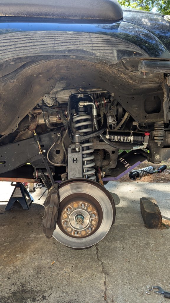

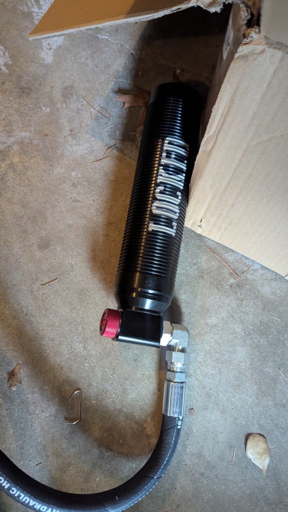

    So I ordered LT coilovers from locked off-road should be here mid next week

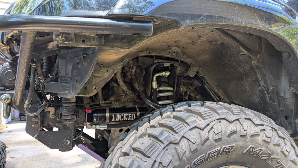

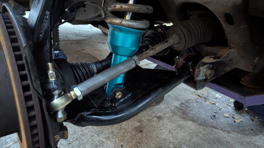

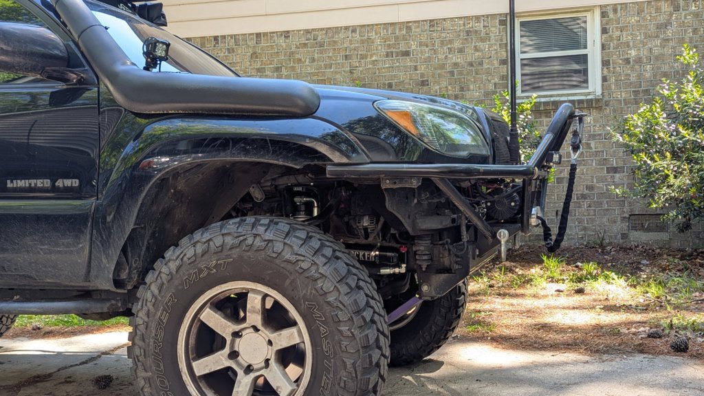

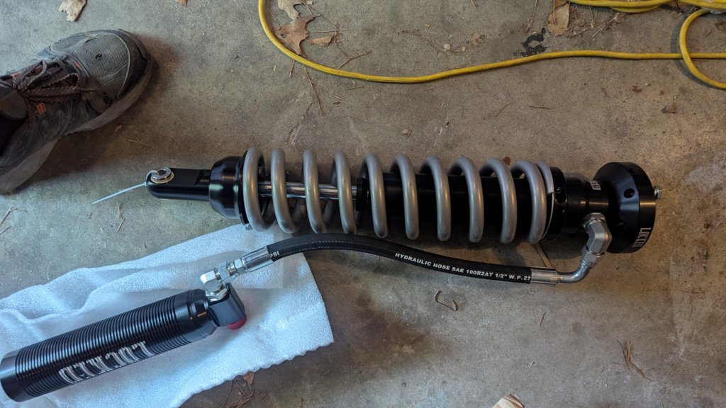

    So I finally had time to get the coilovers from lockedoffroad installed today PXL_20250409_214943696.jpg PXL_20250409_215044316.jpg PXL_20250413_164121499.jpg PXL_20250413_180307187.jpg PXL_20250413_180808813.jpg

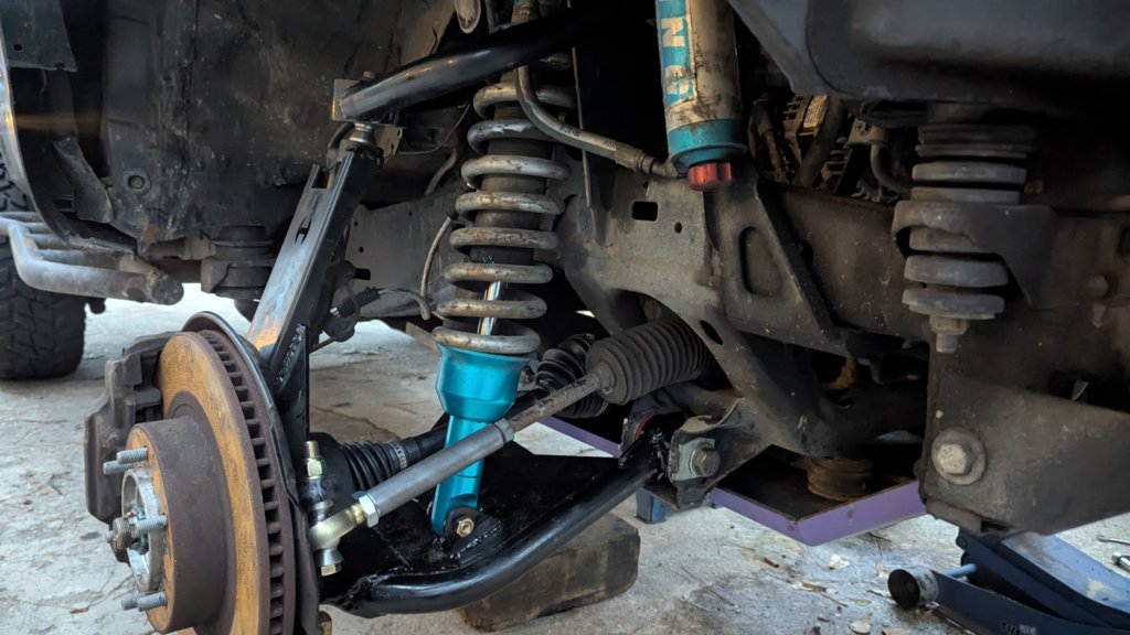

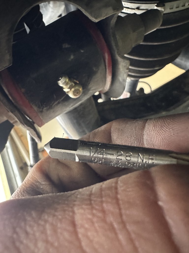

    DR support non-existent, and the kits seem to have machining quality issues here and there. If you have issues, find the All-pro part as a replacement. One of my LCA bolt sleeves was a hair too small and I had to hammer the bolt in and out. AP bolts didn’t slide in either so I know it’s the sleeve.
    Some UCA/LCA grease fitting threads aren’t right either but can be tapped straight with a 1/4 tap (no pre drilling). I was able to do LCA threads on the vehicle by pulling the shocks and compressing the arm.IMG_4397.jpg

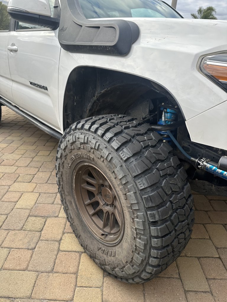

    If you’re running kings with this kit and finding the road/slow speed compression really harsh, might be your preload. Got my shocks tuned for lower compression, sat at 1.5”, then later 1” preload passenger and the ride still sucked on the road and slow speed obstacles.
    Dialed it back to .25” passenger, .5” driver and it drives great in all situations now, even hangs in the whoops still with less bump travel.
    600lb springs and have 150lb winch/bumper combo. No sway bar.

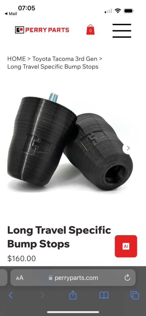

    So another question. What bump stops are y'all running on the front . The stock ones or aftermarket ones .

    Perry parts

    ^^^Perry Parts. $160. (All-pro kit in the drop down)
