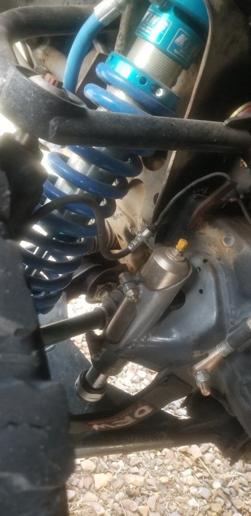

  10. May 25, 2025 at 10:04 AM
    #430
    JoeDirtPNW
    JoeDirtPNW Member
    Dec 6, 2022
    #412467
    9
    Anyone know what these larger bushings are for?
    The smaller ones seem to be for the limit strap bushing.
  11. May 25, 2025 at 10:34 AM
    #431
    mauctopa
    mauctopa Well-Known Member
    Jun 24, 2021
    #369477
    726
    I
    Did you check the other end of the limit strap where it attaches to the lca?
    JoeDirtPNW[QUOTED] likes this.
  12. May 25, 2025 at 1:34 PM
    #432
    ahspurlock
    ahspurlock The TW Mechanic
    Oct 29, 2014
    #141311
    19,072
    Adam
    summerville.south Carolina
    08 T4R V8 Limited AWD
    Front long travel and Rear long travel including upper and lower rear control arms. Running 456 gears with rear ARB locker . LFD full roof rack with clamshell RTT
    They are for your coilovers . Depending on which misalignment spacers they currently have in them, you may need to run these ones
    JoeDirtPNW likes this.

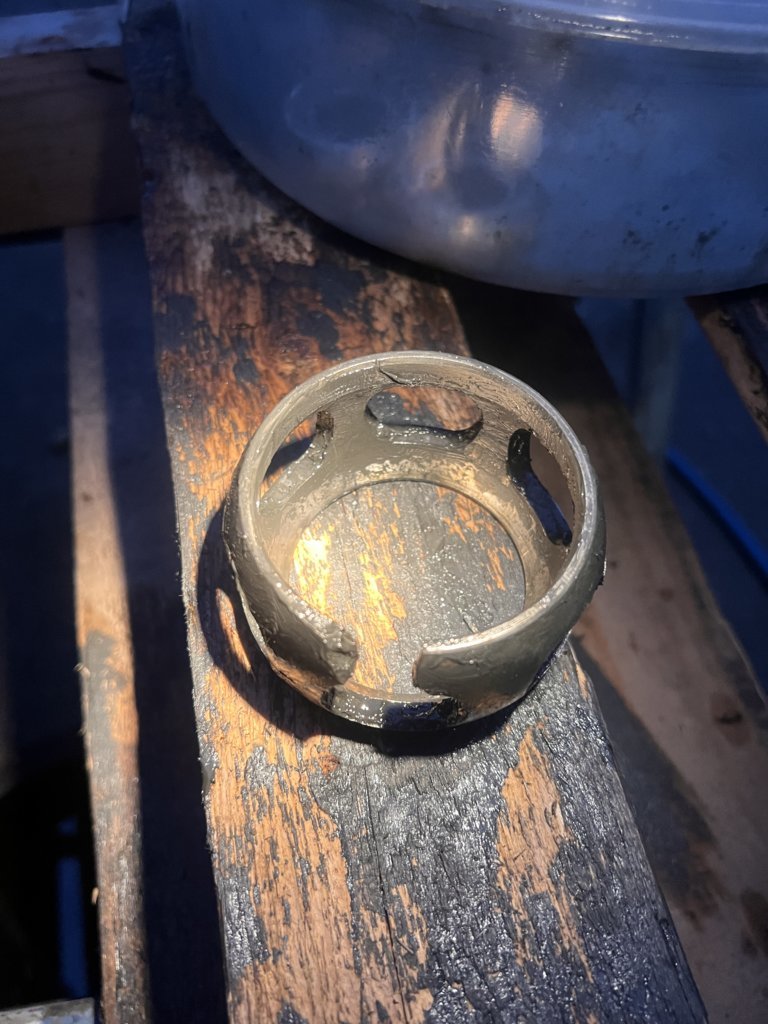

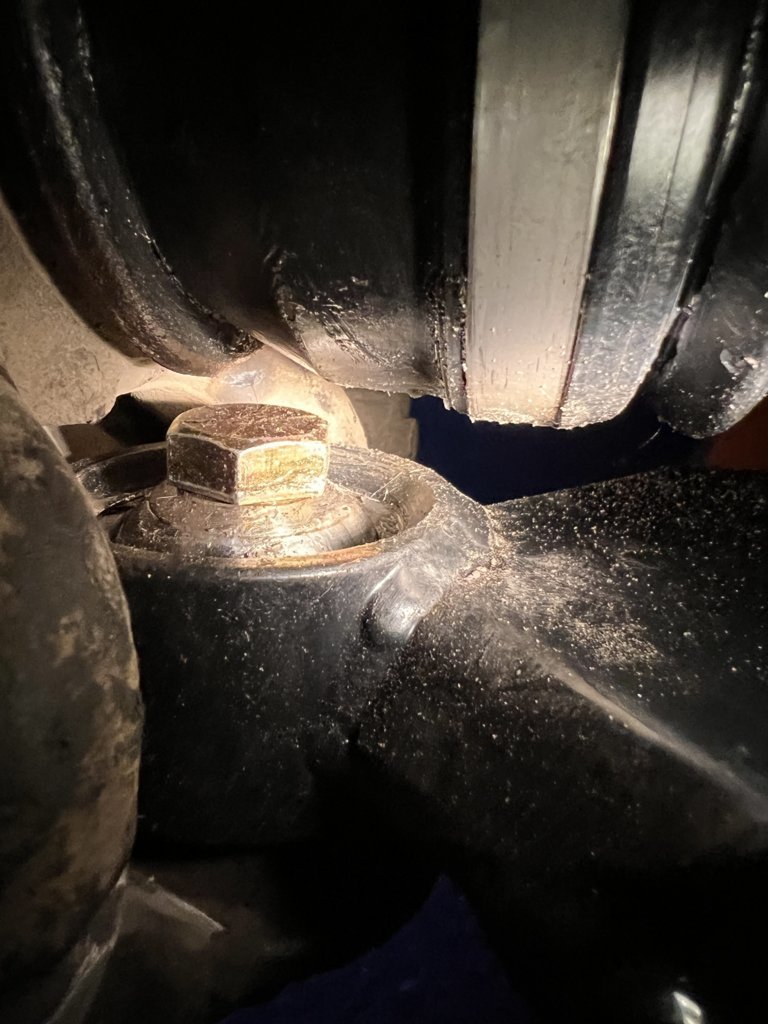

  13. May 25, 2025 at 9:18 PM
    #433
    JoeDirtPNW
    JoeDirtPNW Member
    Dec 6, 2022
    #412467
    9
    I ended up using a hex head for the LCA bolt, no travel limitations.
    Anyone know a good place to buy CV parts, found my cage broke when installing the +2" shafts. Having trouble locating a spare OEM CV.
  14. May 26, 2025 at 4:18 PM
    #434
    ahspurlock
    Oct 29, 2014
    #141311
    19,072
    Adam
    For OE parts used. I use this site
    http://www.car-part.com/

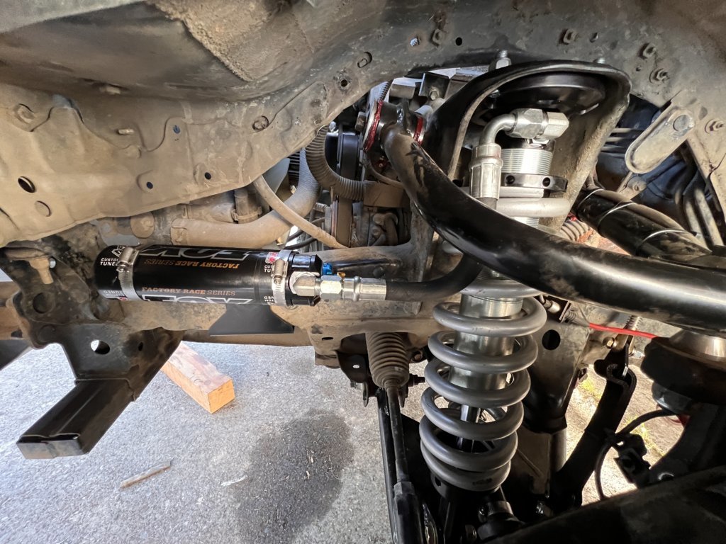

  17. Jun 15, 2025 at 7:20 AM
    #437
    JoeDirtPNW
    JoeDirtPNW Member
    Dec 6, 2022
    #412467
    9
    Went with the Fox 2.5" DSC from Accutune.
    Naveronski and ahspurlock like this.
  18. Jun 15, 2025 at 11:07 AM
    #438
    JoeDirtPNW
    JoeDirtPNW Member
    Dec 6, 2022
    #412467
    9
    Questions,
    How much preload do you guys typically add for the Taco lean? I have lowered the preload nut 1/2" so far, seems like a lot for not having anything aftermarket (bumper ect)
    Also how are you guys running your brake lines? I modified the factory brackets with longer trail gear lines but they seem to be a little too long...
