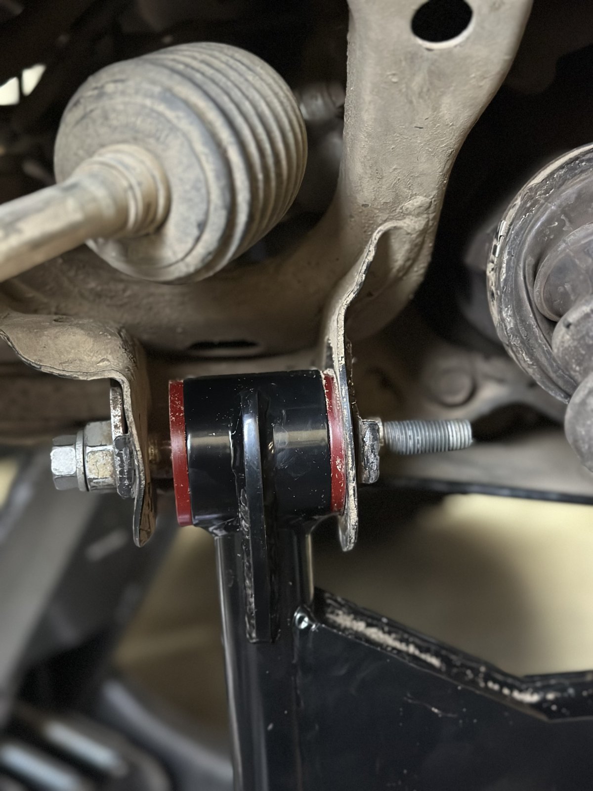

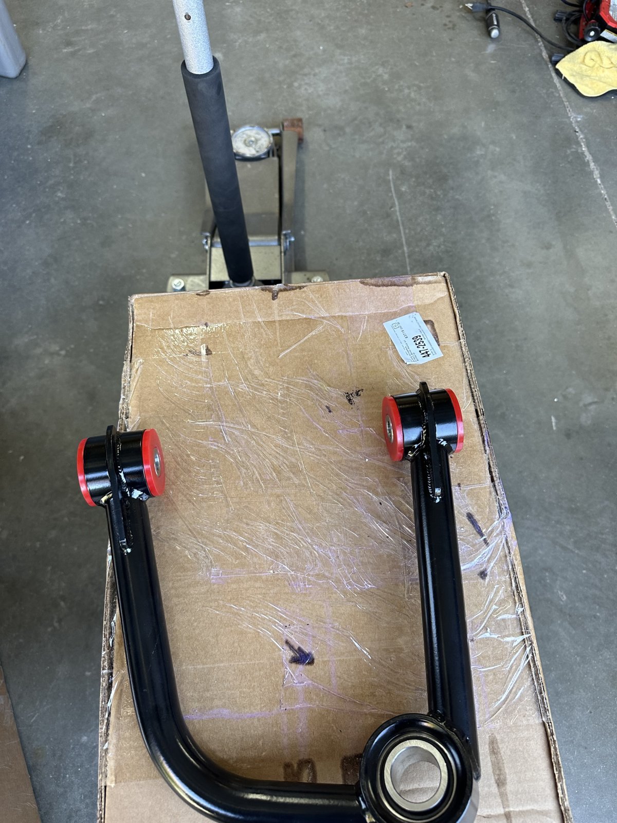

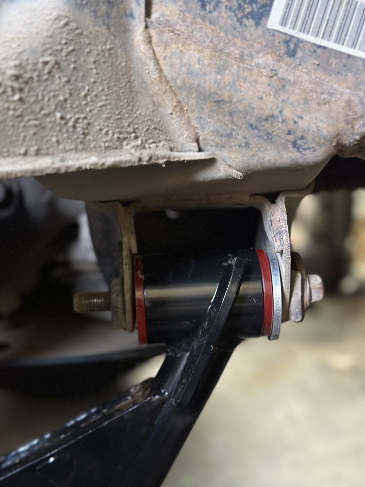

  16. Oct 31, 2023 at 2:41 PM
    #56
    Origin_Offroad
    Origin_Offroad Member
    Sep 28, 2023
    #434429
    9
    This doesn’t seem right…..
  17. Oct 31, 2023 at 2:55 PM
    #57
    Brian422
    Brian422 [OP] I fell into the pit that is TW
    Jun 8, 2011
    #57958
    15,657
    Brian
    Birmingham, AL
    2012 DBCSB F/R Locked, 35's ,Long travel, 23 Tundra 4x4 limited
    Not Stock
    I used both washers
  18. Oct 31, 2023 at 2:58 PM
    #58
    Origin_Offroad
    Sep 28, 2023
    #434429
    9
    That’s the problem the front side is so tight to the mount that you physically can’t get a washer in there
  19. Oct 31, 2023 at 3:37 PM
    #59
    Brian422
    Jun 8, 2011
    #57958
    15,657
    Brian
    Birmingham, AL
    Not Stock
    Can’t remember what I used but I may have used one of the upper washers that’s a different thickness lol for the other side.
  20. Oct 31, 2023 at 3:47 PM
    #60
    Origin_Offroad
    Sep 28, 2023
    #434429
    9
    Interesting I’ll give that a shot
