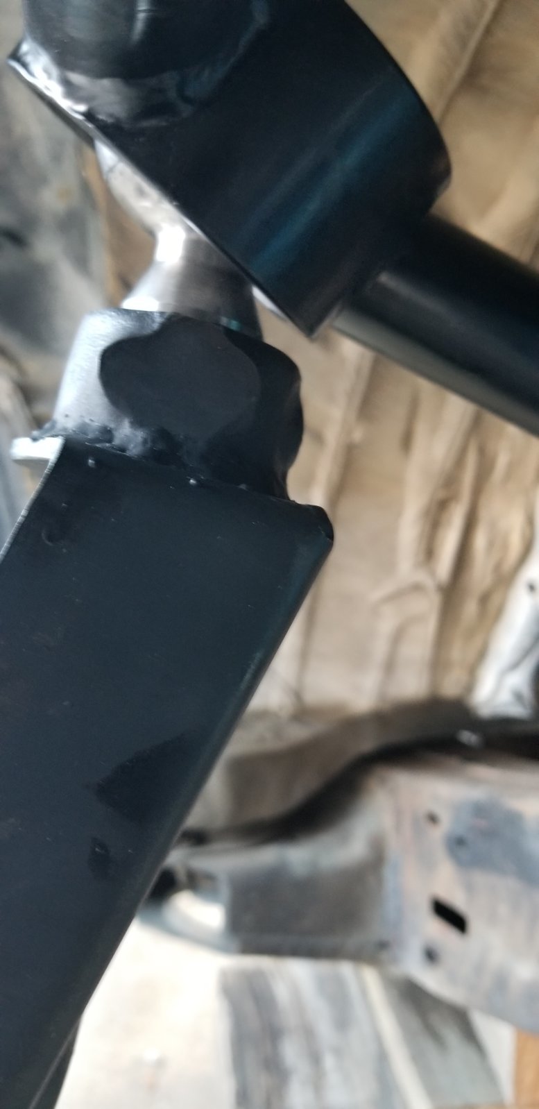

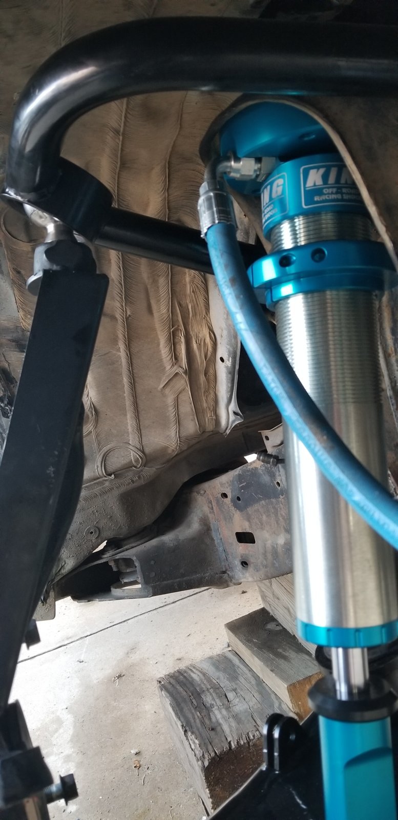

    You're going to need this to limit the uptravel of this kit. If you're running standard 8" shocks the limiting factor on this kit is not the shock, it's the upper arms uniball cup in relation to the spindle. Ideally at full bump you're going to want to leave 1/4" gap between the cup and spindle. Without any sort of bumpstop extension you risk blowing through that travel and putting some serious strain or breaking the 9/16" uca uniball / spindle bolt.
    I mocked up the depo kit today with total chaos LT spec kings and have it bumped and strapped pulling 11.25" of travel.
    @ Full droop I have it strapped with 7" of shock shaft showing and at full bump 1.75" of shaft.

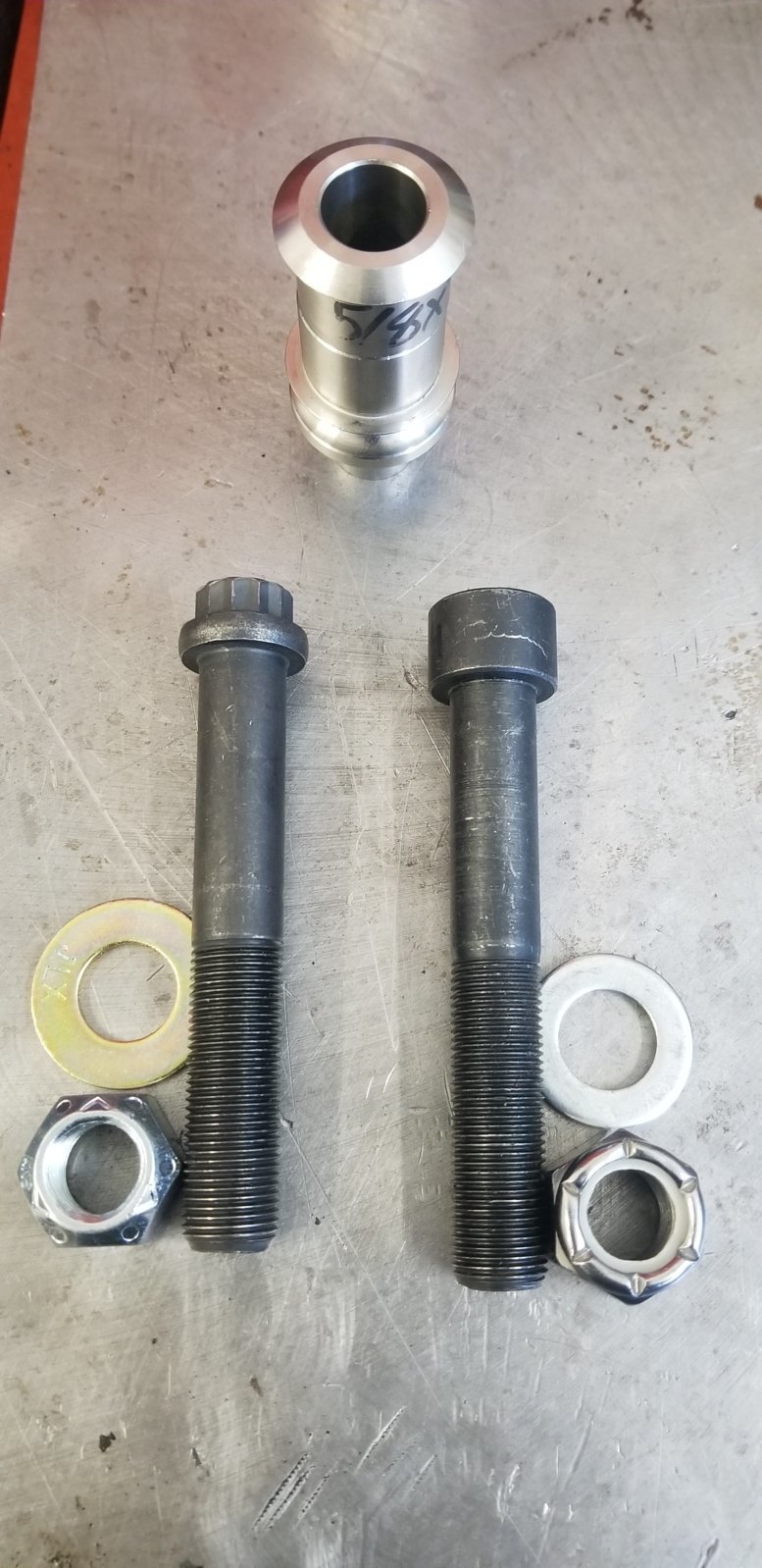

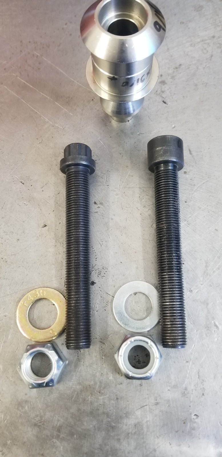

    Few other things to note, use 9/16 bolts for the LCA limit strap hardware not the included 1/2" hardware. It's also worth replacing the UCA ,LCA 9/16 and 5/8 hardware with some grade 8 12pt hardware. The included socket cap screws dont really give me the fiz, no bolt markings on the head indicating the grade etc. 80 bucks of bolts for piece of mind is worth ever penny imo.
    The LCA washers included in the kit all have .750 holes you need 4 washers with the .750 hole for the 2 front lca mounts, and washers with a 9/16 hole for the rears. In total you're going to need twelve of the 2.25" od x 3/16 thick washers with 9/16 hole and four of the 2.25" od x 3/16" thick washers with a .750 hole.

    picked up new grade 8 and 8.2 9/16" and 5/8" hardware to replace the included socket cap screws, i'll throw the originals in the trail bag as spares.
    depo kit @ Full bump maxed out clearance between spindle and uniball cup. 1.75" of shock shaft showing at full bump.
    Rear LCA mount washers with .750 hole , replace these with the same washers that the upper control arm uses. 2 1/4"od x 3/16 thick w/ 9/16 hole. You can source these from allpro, dirtking etc.
