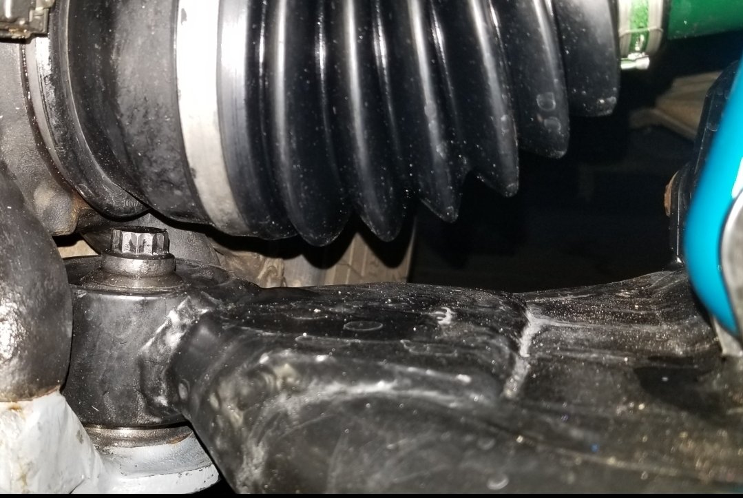

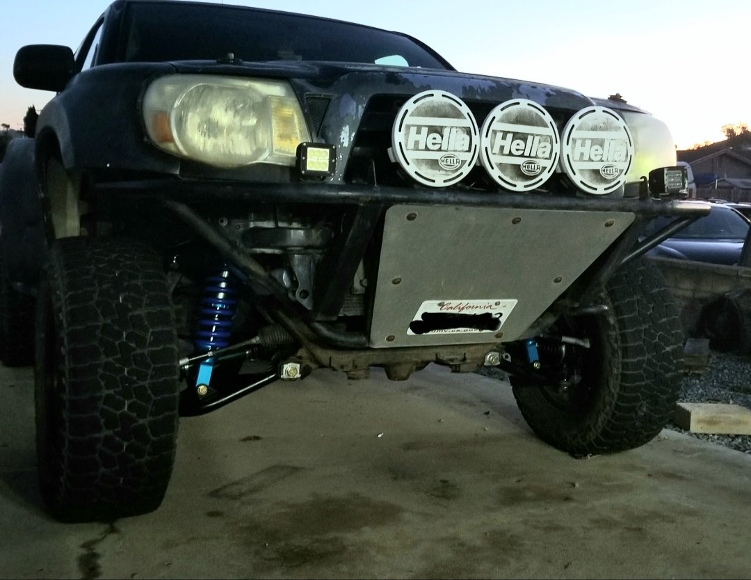

    Anyone notice how the LCA pivot bolt is making contact with the CV dust cover? Anyone figure out a fix for that?
  10. Feb 11, 2024 at 5:28 PM
    #110
    Anteupp
    Anteupp Mega Member
    Sep 5, 2011
    #62962
    2,239
    Post a pic, you could shave a few mm off the top of the bolt head.for clearance.
    FishingInSand likes this.

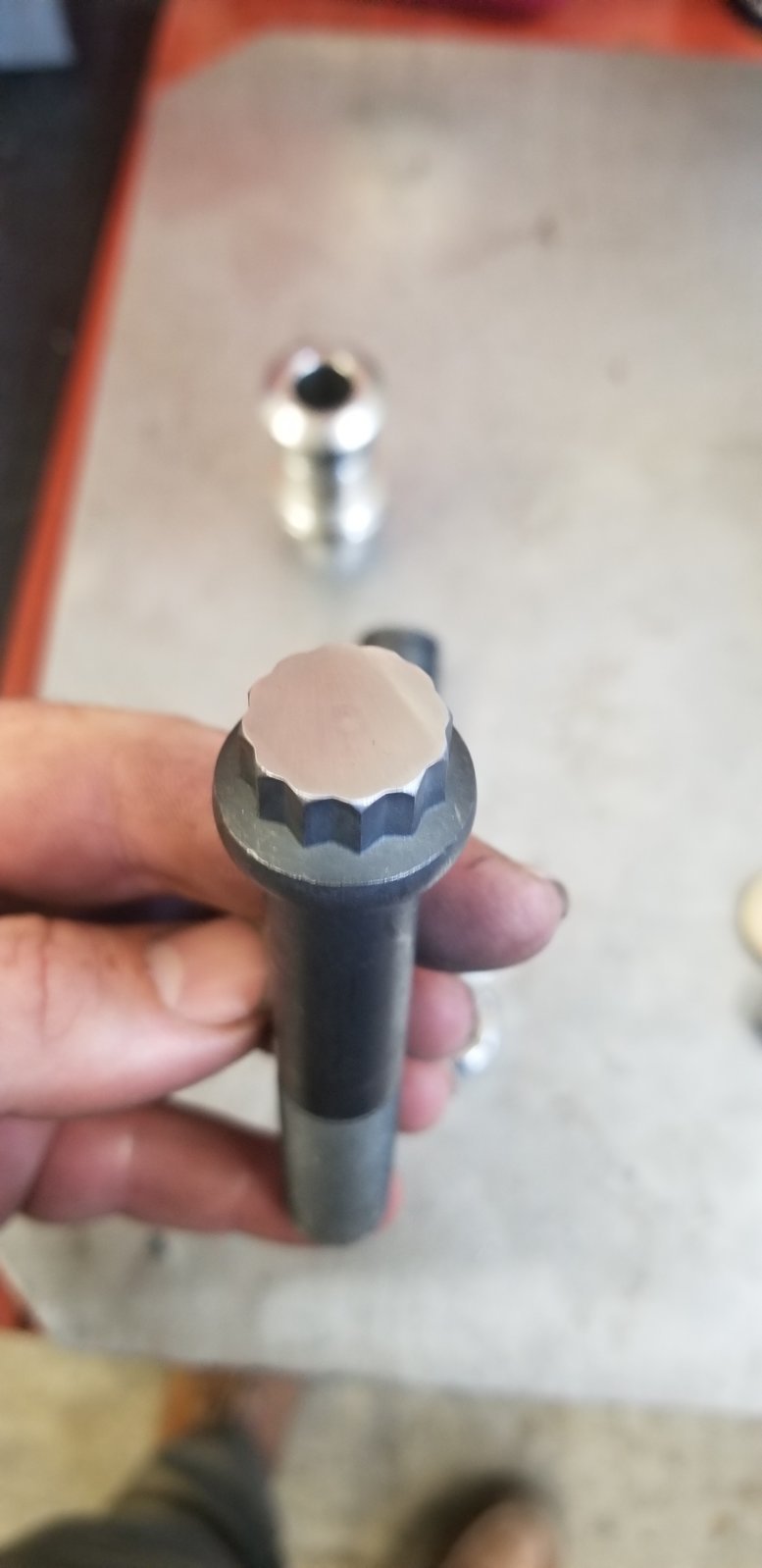

    That bolt looks nothing like the bolt I was given lol. Where did you get that one?PXL_20240212_013237512.jpg
  12. Feb 11, 2024 at 6:35 PM
    #112
    Anteupp
    Anteupp Mega Member
    Sep 5, 2011
    #62962
    2,239
    Sourced all the hardware from allpro. Threw the original bolts in the trail bag as spares.

    The included 1/2" x 2 bolts for the lower shock mount are short, yes the mounts are going to suck in some but not enough to catch the nylon insert on the nut. Go and get yourself some 1/2" x 2-1/2 grade 8 bolts and some stainless steel nylok hex nuts.

    Got the truck buttoned up today, the poly performance taco tabs - camber set to the neutral setting, caster maxed out @ furthest outboard position. Drives great, looks good, has more clearance between the ground and the LCA compared to the TC kit that used to be on this and is now on my 4runner. Just need to set the toe, burn in the reservoir mounts, add some bumpstop spacers and adjust preload accordingly.
    Despite the small things I've mentioned about the hardware, the fit and finish of the kit exceeds my expectations, for a thousand bucks you can't beat it. Now will it hold up in the desert?? Only time will tell, will update as needed.

    Ah makes sense I wonder if it's just a fuzz shorter. It just needs to clear barely right?
  16. Feb 11, 2024 at 8:02 PM
    #116
    Anteupp
    Anteupp Mega Member
    Sep 5, 2011
    #62962
    2,239
    yeah it just needs enough clearance to not rub. Yours will probably self-clear lol
