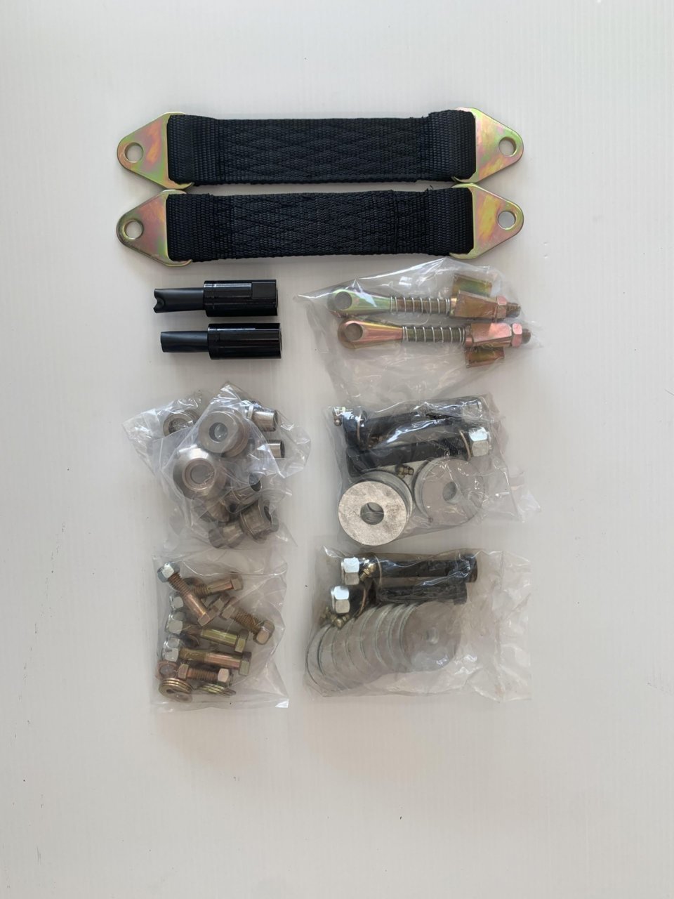

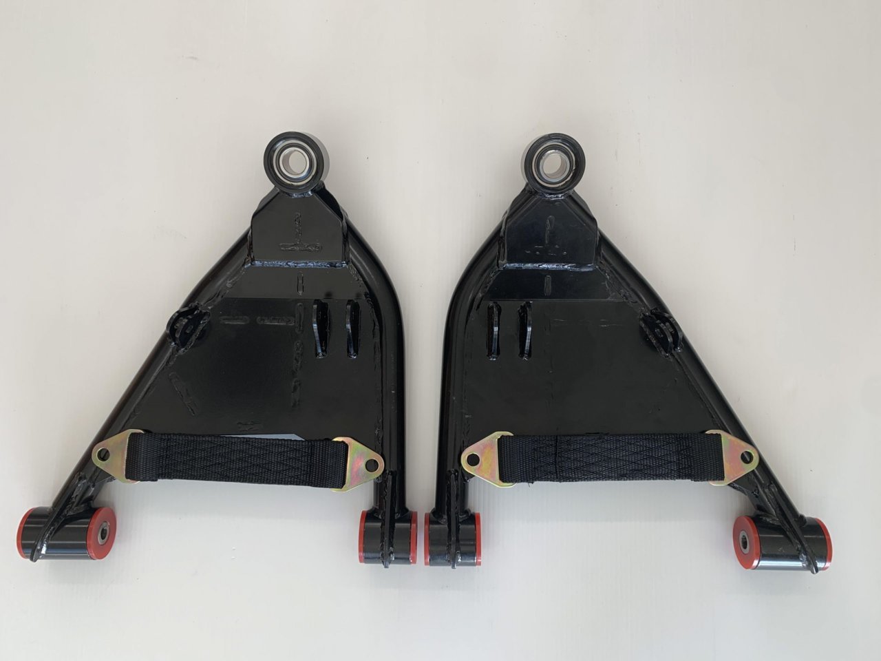

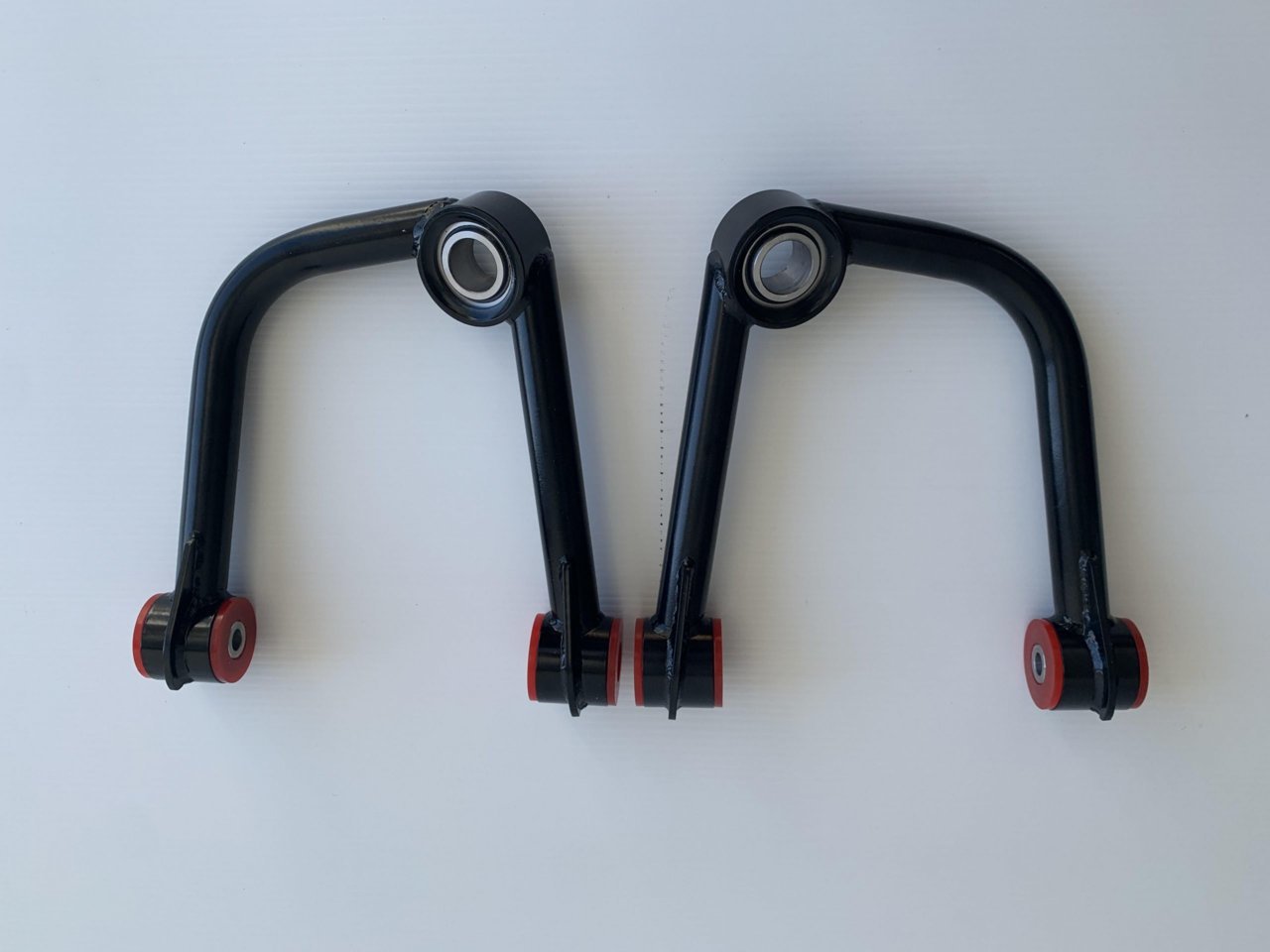

    I was forwarded this information regarding this kit out in the market what are y'all's thoughts about this kit.
    2pcs – 2″ extended each arm – 35mm diameter tubular 4130 Chromoly upper A-arms with a 1.25″ Teflon uniball for maximum travel & strength and zerk fittings for easy bushing lubrication.
    2pcs – 2″ extended each arm – 40mm Diameter tubular 4130 Chromoly lower A-Arms, We then Fully Box them to make them Gorilla Strong – A Billet CNC uniball adapter connector and bumpstop contact point – this strong design provides the utmost in off-road function and durability. The Lower Control Arms have been boxed and plated for added strength, durability and skid protection on the trail
    All Hardware included: Bolts , Washers, Nuts
    2pcs Heavy-duty spindle gussets (requires welding)
    2pcs Limit Strap Kit (requires welding)
    2pcs Tie Rod Extenders for Tacoma included some models need longer or shorter
    Includes eyelet spacers to allow use of Fox Shocks with Lower A-Arm (spacers not shown).
    1″ – 4.5″ Lift Height
    Long Travel shocks and extended IFS axle shafts required to complete installation. Front Bump Stops recommended .

    It's a black all pro offroad kit, re-brand , or copy
    Edit - Made in Taiwan per the website
