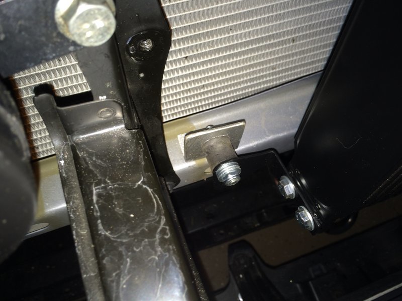

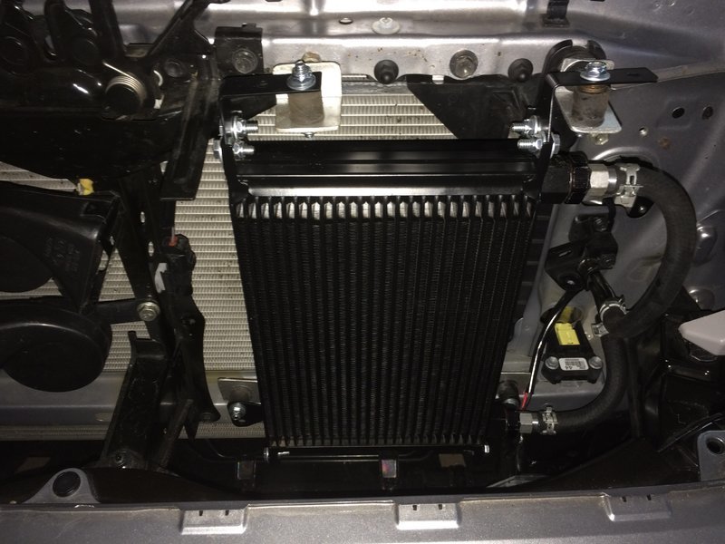

    Relocated horns on center support post making room for the cooler. Did not change or lengthen any wiring, just drilled two mounting holes. Shock mounted with Lord rubber mounts. On a 100 degree day while pulling my 4500 lb RV Trans temps would sometimes reach 200 degrees on steeper inclines. I replaced the dinky factory cooler with this one. Never gets over 170 now. IMG_2853.jpg IMG_2857.jpg
