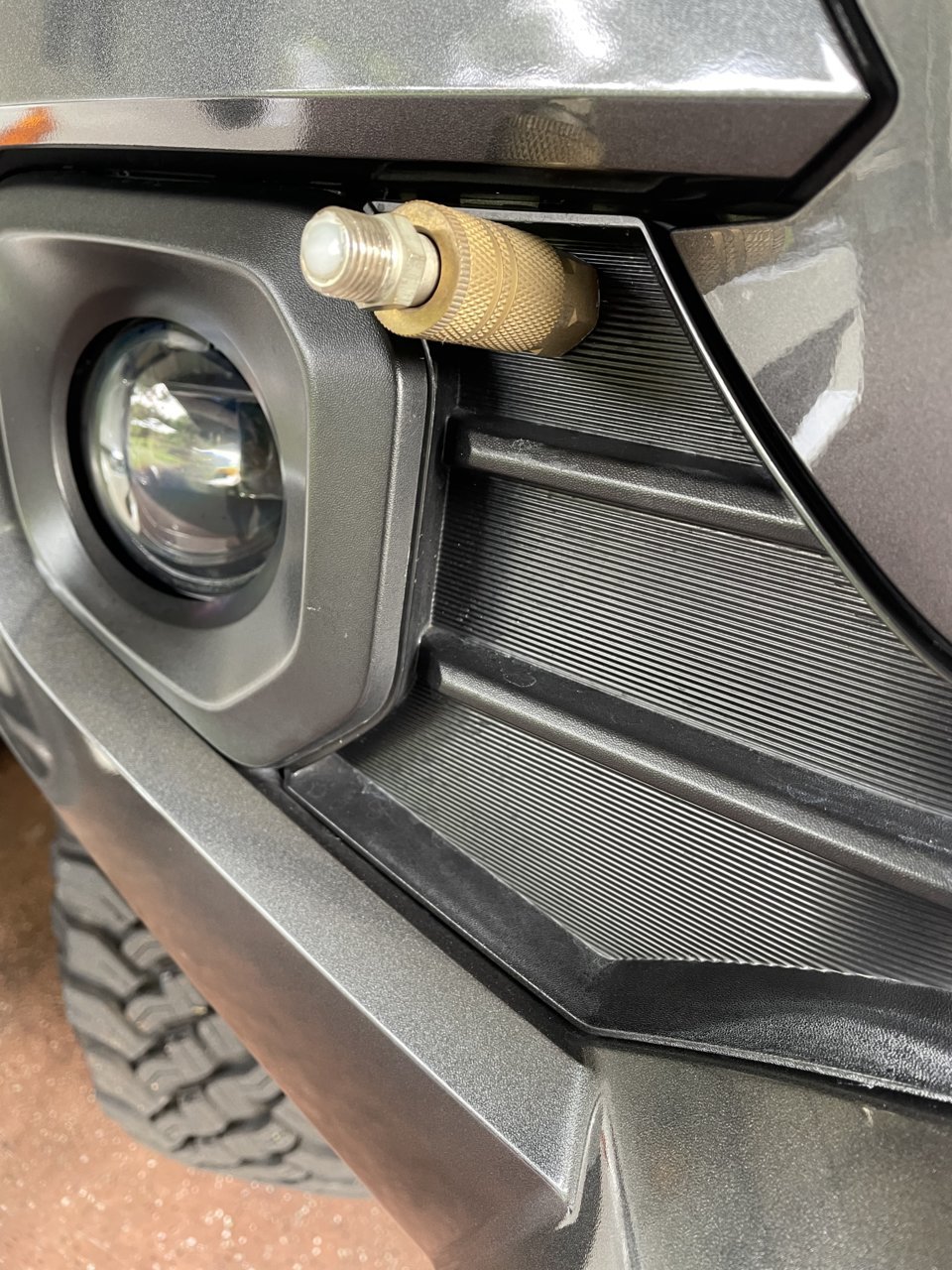

    This is just my preference - under hood and I route it to the front bumper. That way I don’t have to keep my hood/door open in dusty conditions/salt (I fish quite a bit).

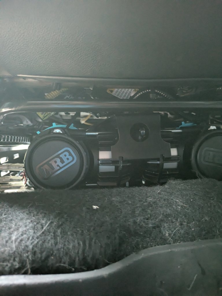

    Ummm. I have a single arb under the passenger seat. Doesn’t get hot, isn’t loud. Made a custom length harness, loom and all. Not a bad install. Also made a wifey hose, works great.

    I've installed my arb single under the drivers seat with a homemade bracket. Decided to keep mine in the cab since the truck will be running w/ A/C while I air-up and the noise doesn't bother me too much. Plus it'll keep the compressor and filter cleaner than under the hood. I've run the air lines through the floor with a rubber gasket then splits to both sides of the truck so I can connect the air hose on both sides.. capping them with brass fitting caps to prevent debris from clogging the qd air chucks.

    I have thought about doing this but need to verify there is a floor grommet on the passenger side. Love the quick access outside. If it is not feasible I will probably just leave the tap inside.
    I totally get that, I spend alot of time in Utah and the fine sand gets into everything. Not to mention the wind.

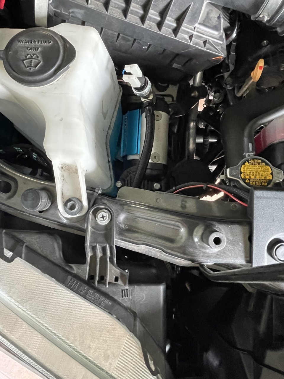

    Custom mount or purchased?
    I think this is the first time I've seen it next to the washer reservoir.

    I purchased it. SLEE’s 2nd Gen mount works for the 3rd Gen luckily

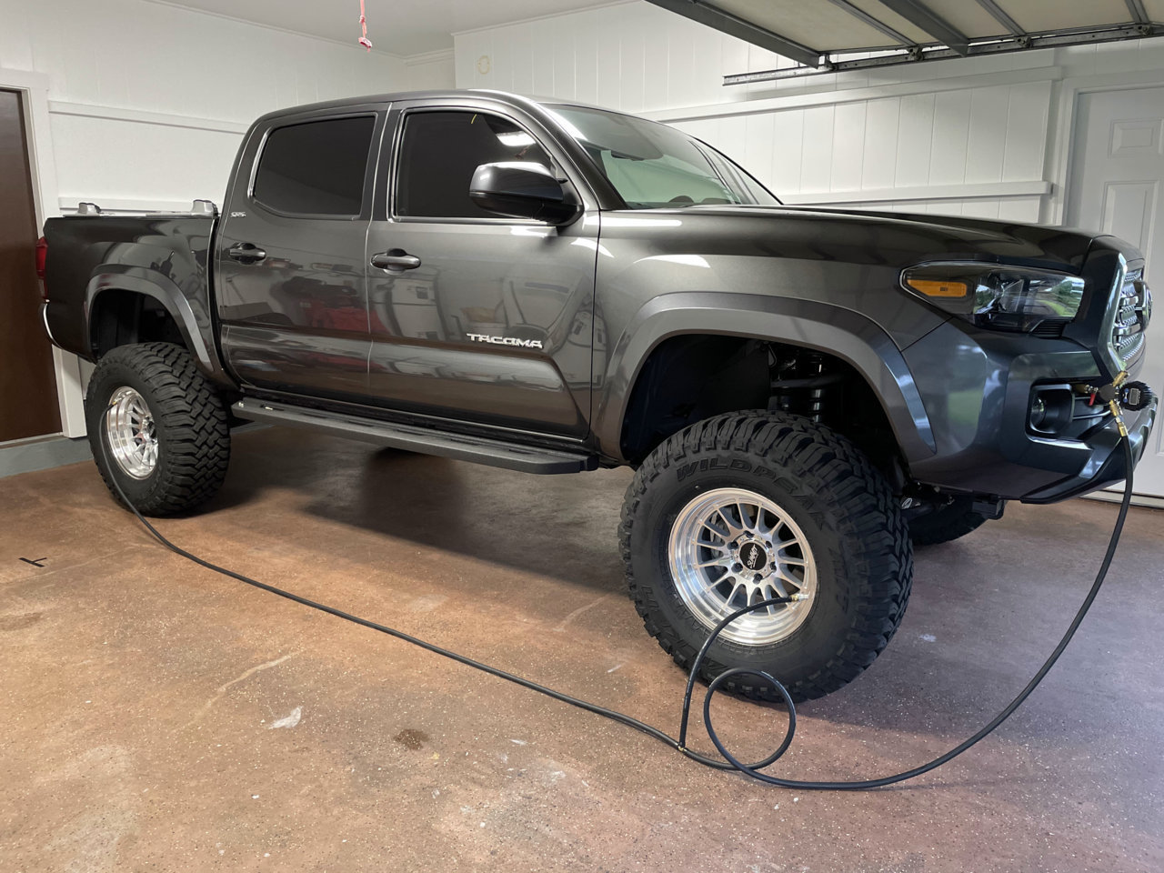

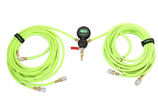

    The guy that came up with the idea named it wifey , maybe his last name was wifey. I can’t remember. But it’s all four tires at the same time. 678FD955-7E12-4C0E-B469-145DCD71BF49.jpg Kinda like this.

    This is a little late to this post but for anyone who ends up here, the run can be done via the center console towards driver side. Twin ARB fits perfectly with enough space for the seat and the compressor not to touch. upload_2024-10-31_21-57-39.jpg
