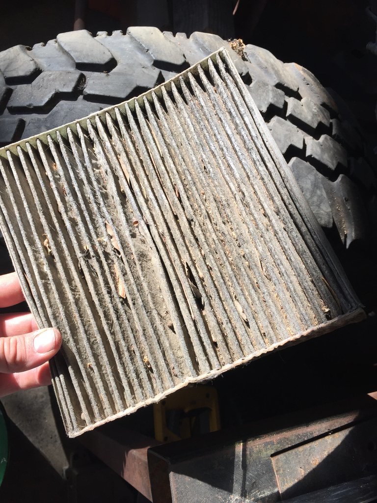

    So yesterday was a decently productive day. Spent the morning sleeping in as a week of the new sleep schedule caught up to me. This "dog dad" life has its perks and I don't mind early mornings, I'm just not wired for them. I have always been one to stay up through the night. Not wake up at 4:30AM every morning. The pup is doing well though.
    I finally did a small portion of my much needed maintenance. New plugs, new air filter, new cabin air filter, cleaned the MAF sensor. The process did not take very long and was much easier than previous plugs I have replaced. My Ranger was at the top of that list as far as difficulty. The location of the plugs were garbage plus the driver's rear was seized. We had to go through the bottom of the wheel well with a 1/2" ratchet and lifted ourselves off the ground trying to get it to break. This process was much easier.
    I ran NGK G-Power Platinum plugs as that's all that O'Reilly's had in stock that met OEM requirements. I wouldn't run any other manufacture other than the Denso or NGK plugs. I've always had good luck with NGK so I have faith in them. It's surprising to me that these trucks use a standard copper core plug, but 30,000 miles is good enough for me. I don't think these have ever been changed out and I'm about to hit 100K.
    The most difficult plugs to replace were the two driver side rear. I removed the top bolt of the bracket supporting the air box and loosened the bottom bolt to move it out of the way enough to get the COP out. For the rear I just took off the hose that blocks the COP from coming out. It was easy to remove by hand. I believe its just a vacuum line for the manifold pressure.
    I believe I was overdue for a cabin air filter...
