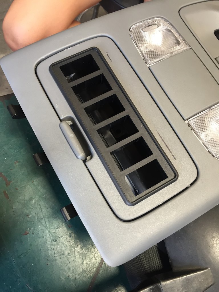

    Would have been nice to know before I took a dremel to my dash. Haha. All good though, because even a clean install on the locker would still leave the issue of the compressor switch. At least where I put it there are only 3 slots so it'll look uniform once I put the front locker in.

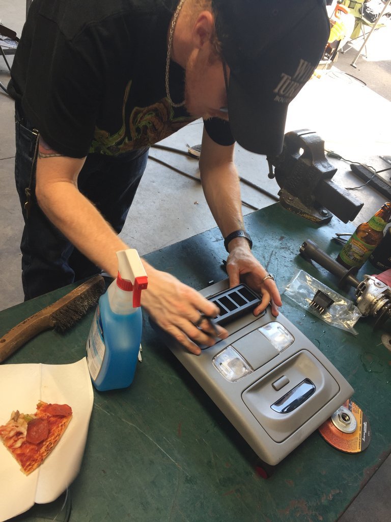

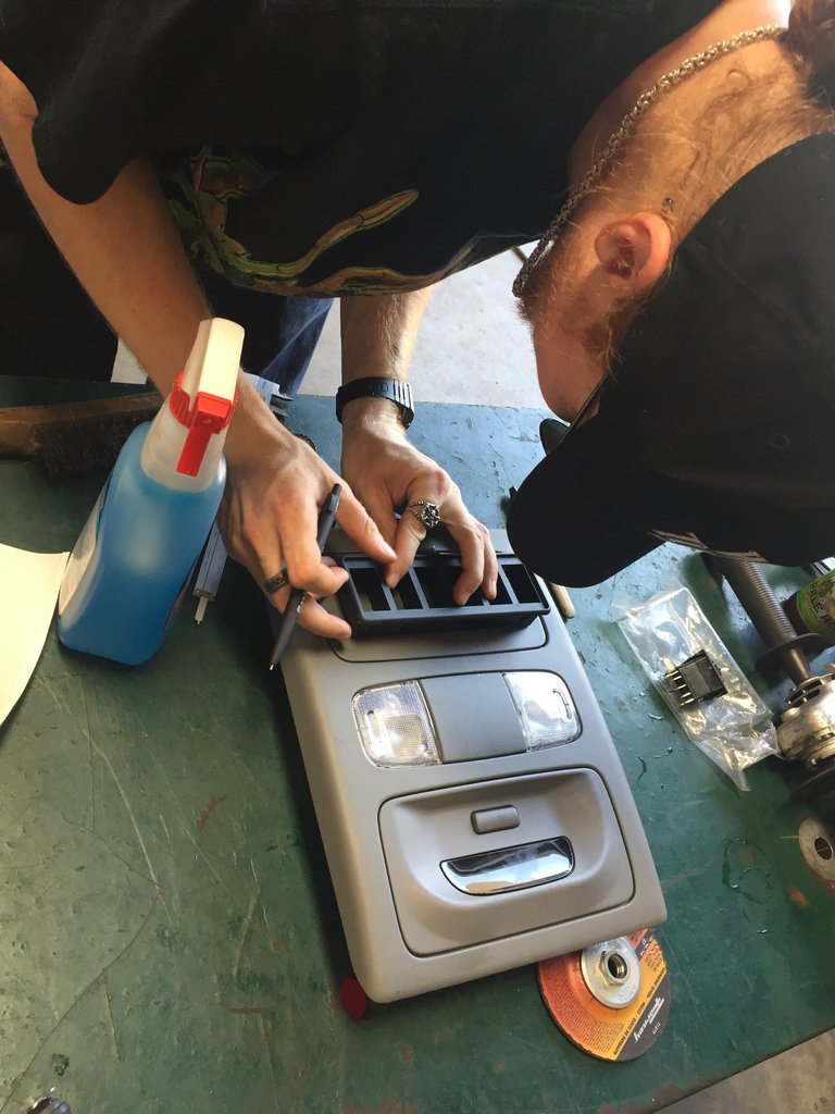

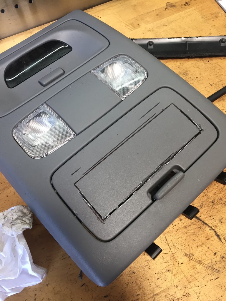

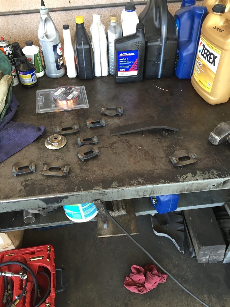

    Had a little fun with the group today and started a little project I have been wanting to work on for awhile.
    @erice doing what he does best and making shit square.
    @Dessertjunkie858 doin work...

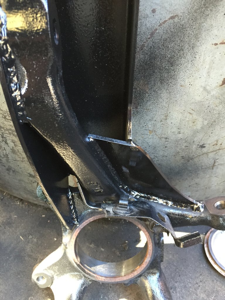

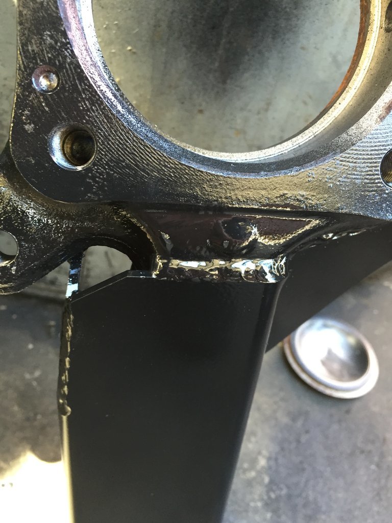

    It's a little late, but I found some old pics of the spindle gussets that I had @jeffz0rz do the welding to. Great work with the welding and took his time. If anyone is in the SD area south of the 8, I would highly suggest him. Just trying to keep the thread up to date!

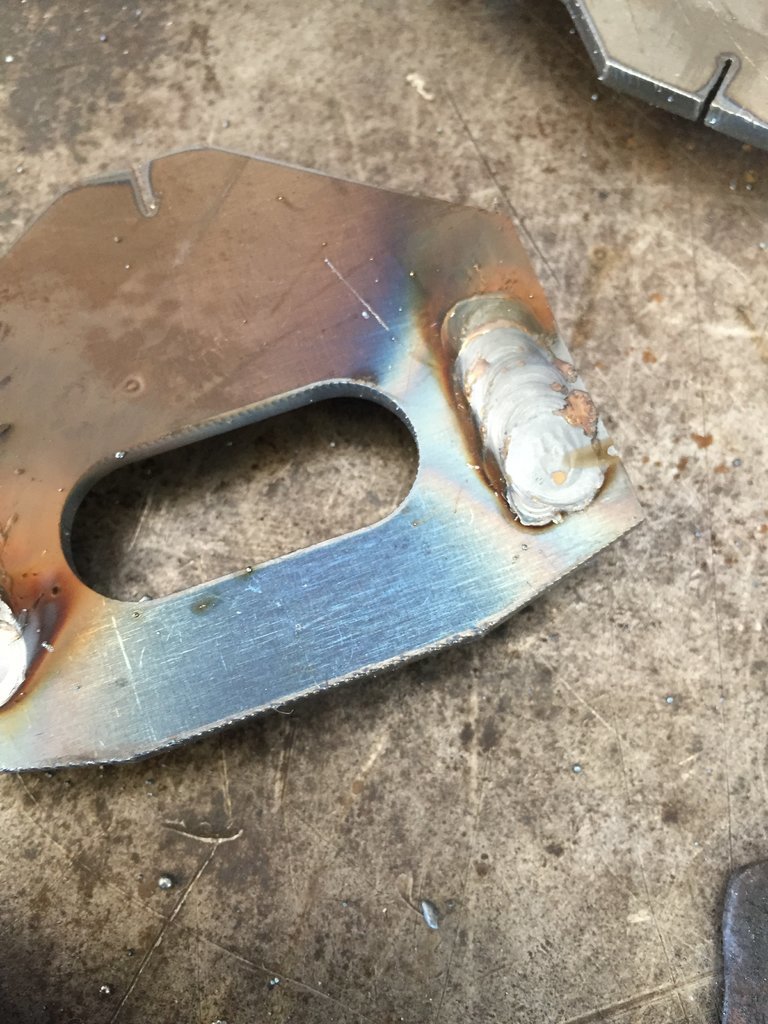

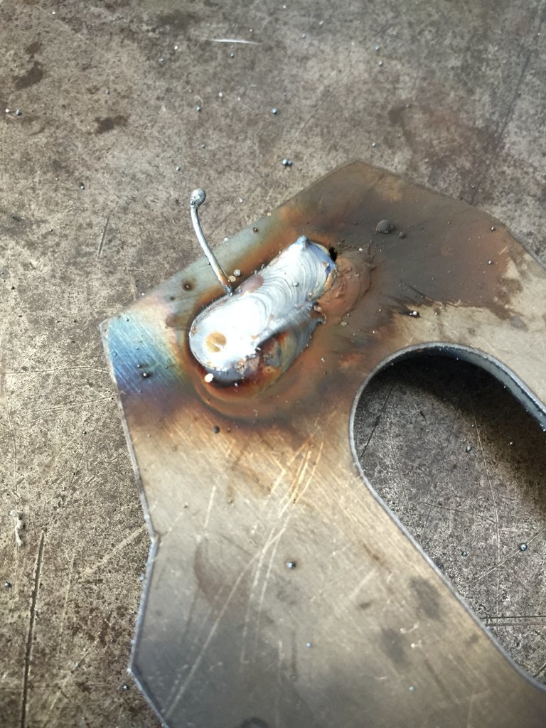

    Also found some pics of the TC cam tabs that I installed some time ago before putting the SCS Ray10s on. Had some frame work to do and couldn't get the truck aligned so these did wonders!
