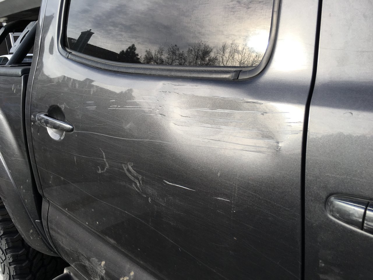

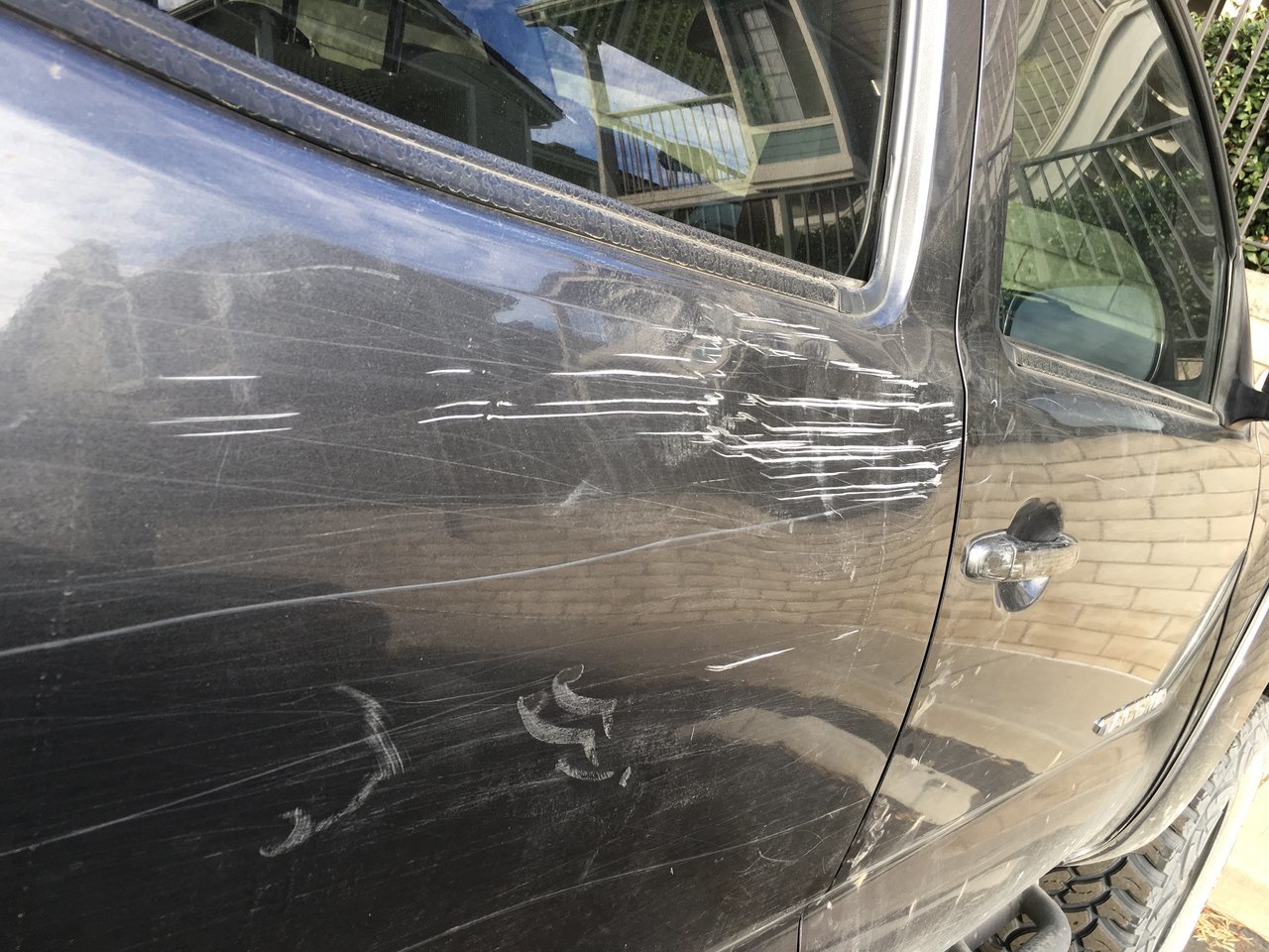

    Did you get that dent on the squeeze?
    eccracer104 and ChadsPride like this.
  17. Jan 11, 2018 at 4:04 PM
    #337
    desertjunkie760
    desertjunkie760 [OP] @DesertJunkie760 (IG)
    Apr 11, 2016
    #183963
    9,159
    Shane
    2011 MGM DCSB TRD Sport 4x4
    Check My Sig.
    Yes

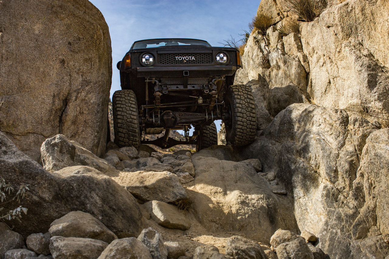

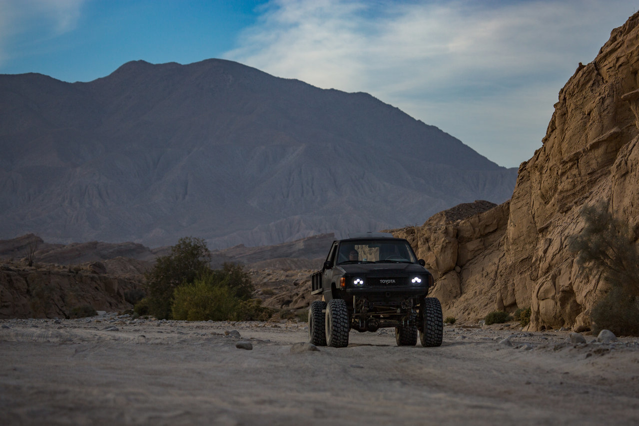

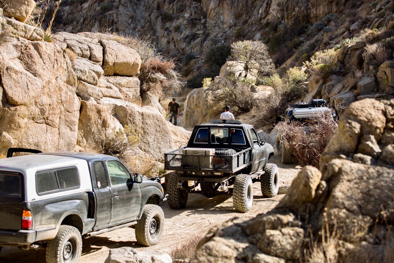

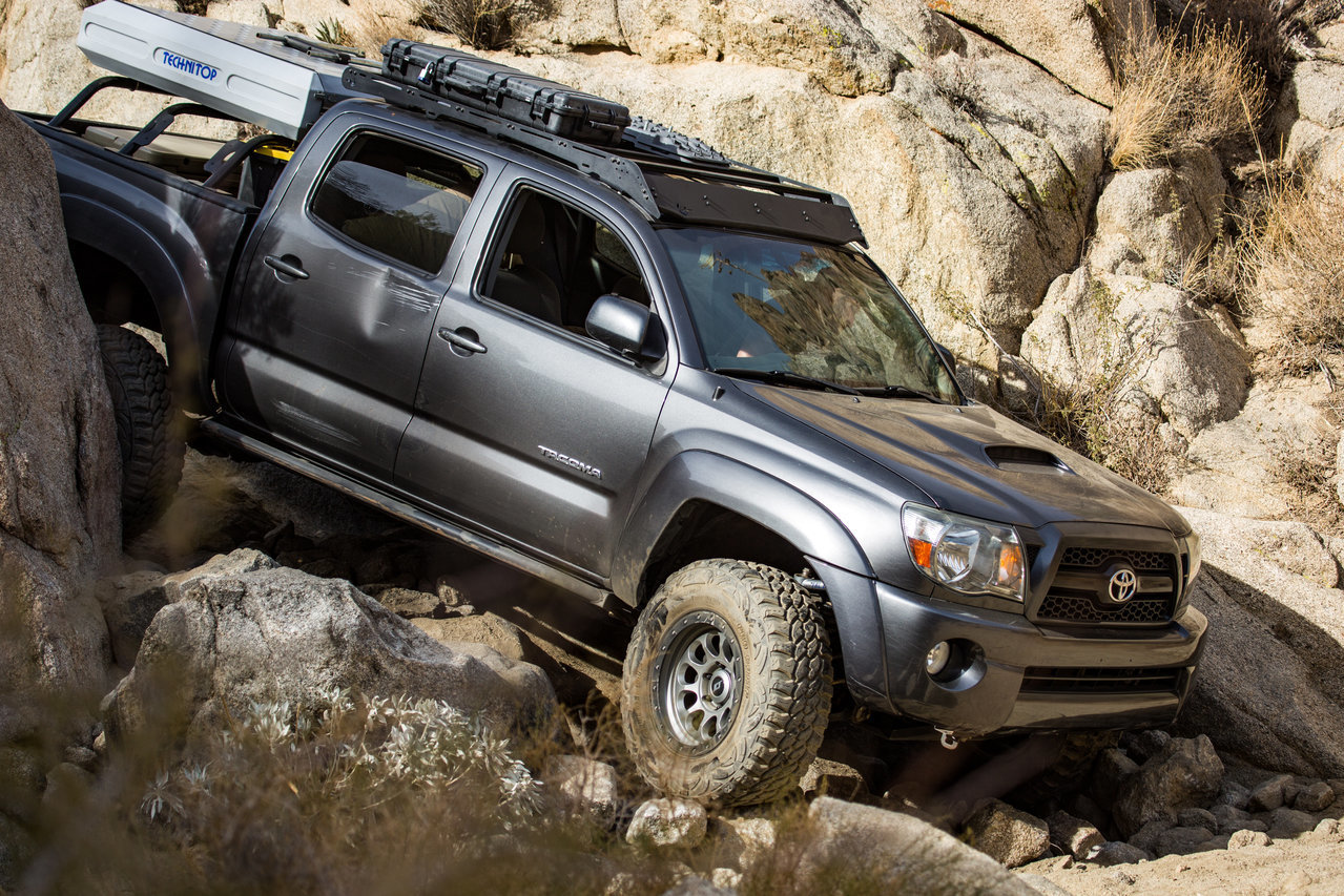

    It's been awhile since I've thrown anything up and @YumaTRD was kind enough to post the video of me accomplishing "The Squeeze" of our most recent trip to Pinyon trail. I've been wanting to complete this trail for almost two years since my buddy and I first attempted to complete it and failed due to the size of his vehicle. The trail didn't disappoint and we had minimal damage. (Other than my door)
    Photo creds out to @erice for once again taking some awesome pictures and using your photo skills to share our trips!
    Enjoy. :cheers:
    Pinyon Drop Off (Heart Attack Hill)
    IMG_2704.jpg IMG_2705.jpg IMG_2706.jpg IMG_2707.jpg IMG_2717.jpg IMG_2718.jpg IMG_2719.jpg IMG_2720.jpg IMG_2721.jpg IMG_2722.jpg
