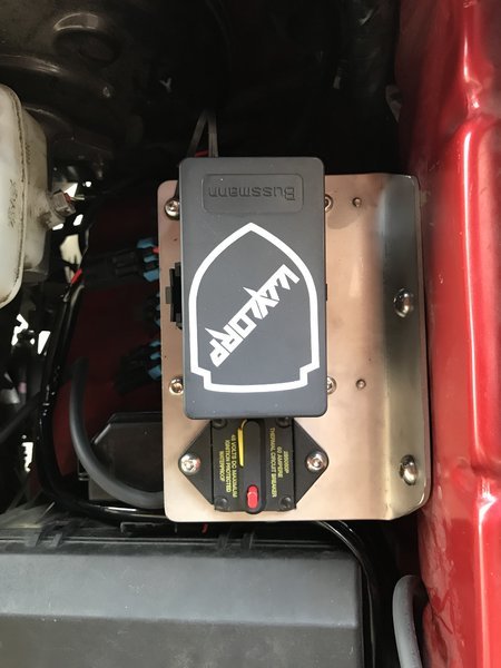

    @Pirhett what was the switch panel you recommended last night for the overhead? I want to start doing some smaller mods while the wallet takes a break from anything big.
    Going to grab a fuse panel bracket next paycheck and start getting all of it wired up for lights/compressor.

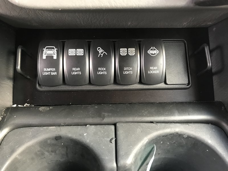

    Its a six switch holder from ottraw or however its spelled. The holder in the cup holder is from @Iggy
    for the blue sea if you go that route, put it behind the rear seats. Or get a bussman like mine
  8. Mar 10, 2017 at 9:21 AM
    #28
    Iggy
    Iggy Well-Known Member
    Feb 2, 2012
    #71971
    4,016
    Northern CA
    09 4x4 Off-Road Access Cab
    Check out the build
    Thanks!
    I have the switch panels and I'm also working on a RTMR system too. I should have configurations for sunglass holder or using my switch panel.

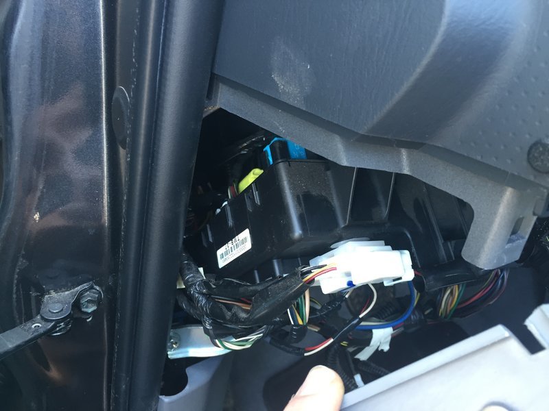

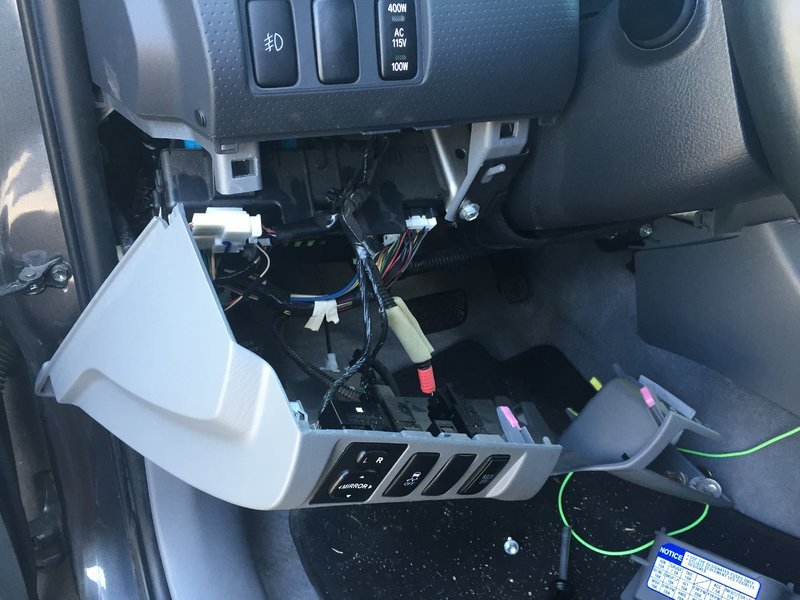

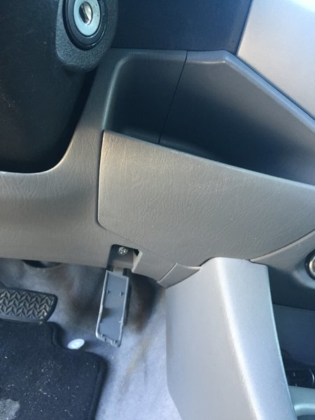

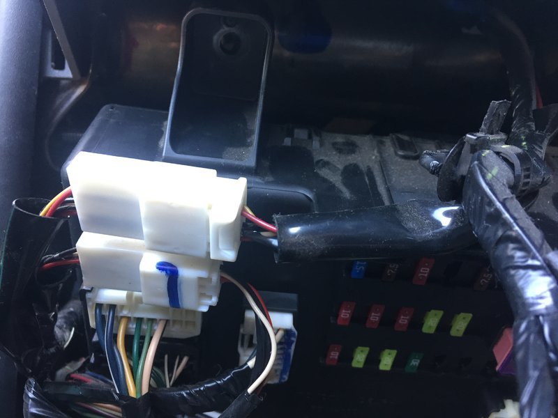

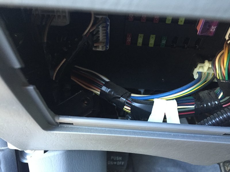

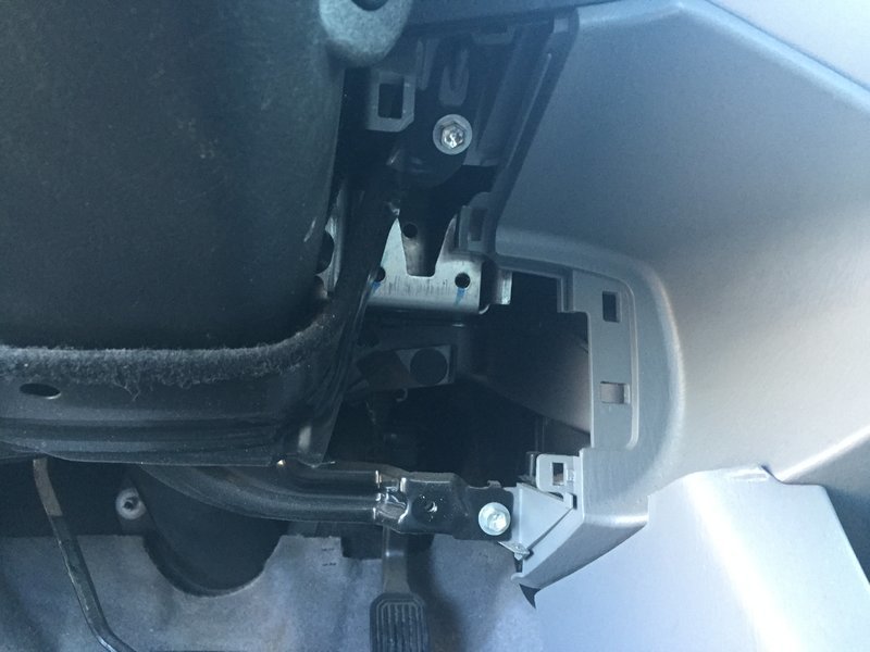

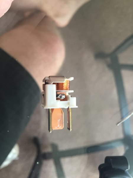

    So I did some small mods just before the Joshua Tree trip that I wanted to post up.
    First was the 12V "always on mod" so that I could keep devices charging with the engine being on and off. You really just have to remember to unplug equipment you don't want to charge for long periods of time, but for the JT trip it was great for our phones. I did the relay route. Very easy to do and nothing permanent if I want to remove it some day. I am not responsible for any damage or harm that you may experience. If you are uncomfortable attempting this mod, then id recommend seeking professional help. I also recommend disconnecting your negative battery terminal for working on electrical.
    This is the location of the bolt on the right side of the steering wheel to remove the cover.
    Coin cup and panel removed, right side.
    Remove the business card holder on the left side of the steering wheel to expose the fuse panel. I think there were 3 bolts holding the panel in.
    One of the bolt locations
    You have to remove the cover below the steering wheel to get to the relay. I left my hood pop attached and just let it hand. One of the bolts holding it on is behind the left foot kick panel.
    You can see the relay is located behind the fuse panel. Once you have the bolts/screws holding the panel in place, you can move it down enough to access the relay without removing any connectors. Its the very left relay. Just gently apply pressure and wiggle back and forth. It's in there nice and snug but it will come out. I just a small screwdriver to apply leverage once a gap was exposed but be careful not to break or ground anything.

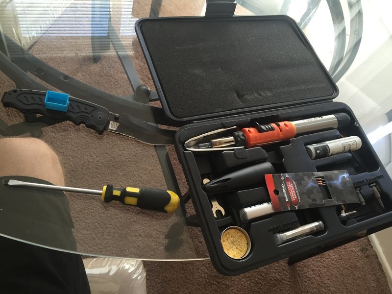

    This is my workspace. Not a lot of tools required. (resistors are from a previous mod on my SuperDuke R.)

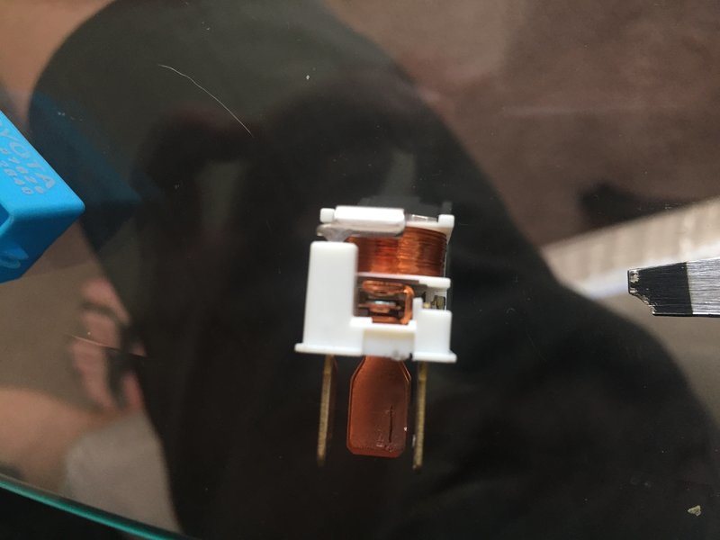

    I used my knife/screwdriver to pry the tabs on the bottom of the relay open. Minimal damage done. Just pop out one side at a time and pull the cover off.
    This is before the soldering. You can see where the relay makes contact once power is sent to the circuit.
    Just a little solder on the connecting point. Keep contact with the iron to a minimum and don't overheat the relay. It gets hot fast.
    Reverse assembly. Works like a charm and no battery issues as of yet. It's only been a week.
