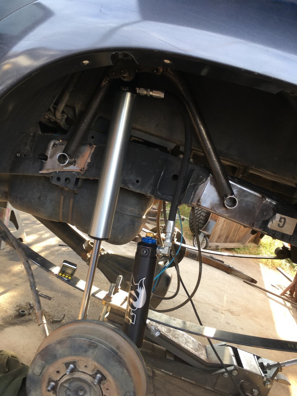

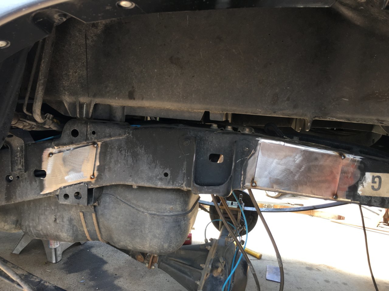

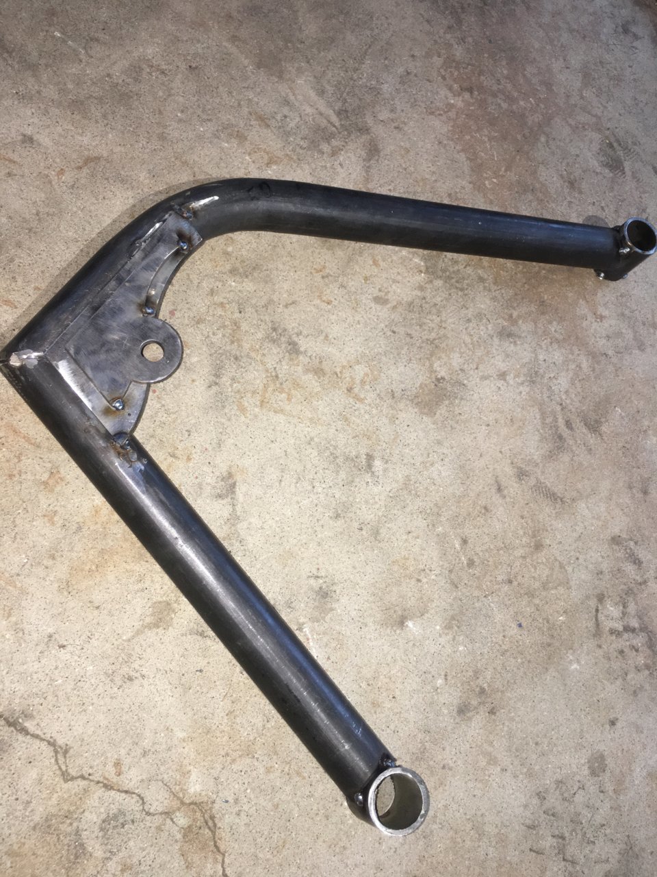

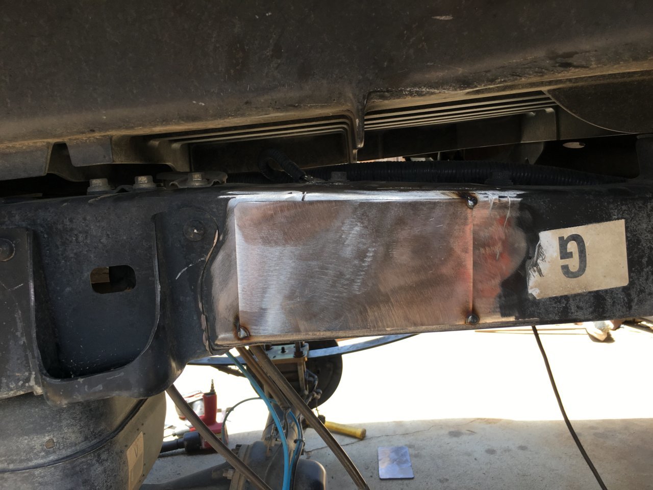

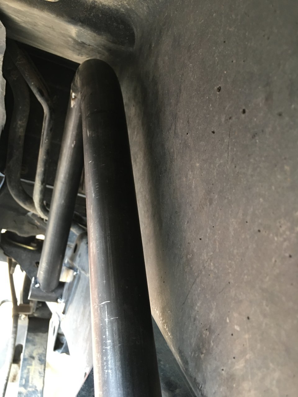

    Progress is being made. Cycled last night and started to duplicate the tube for the passenger side.
