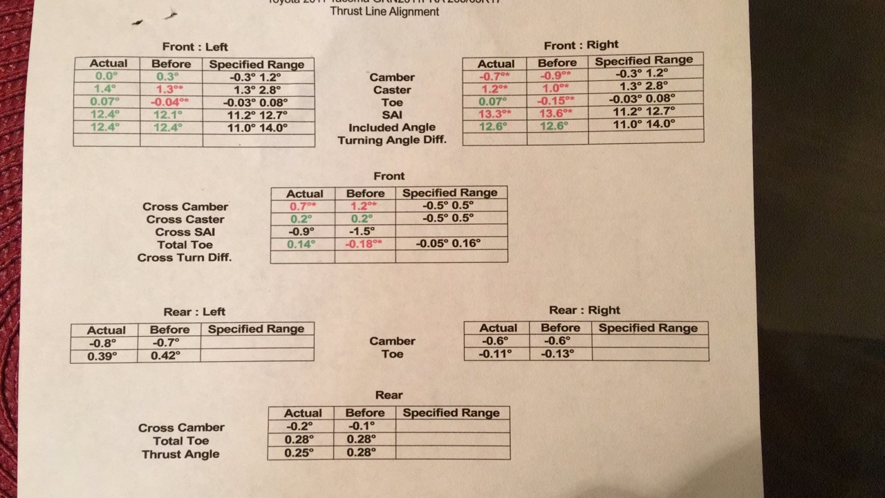

    I mean, they did help get my alignment closer to spec so there's that?IMG_0299-1.jpg

    Still no enough caster. Not quite there yet.
